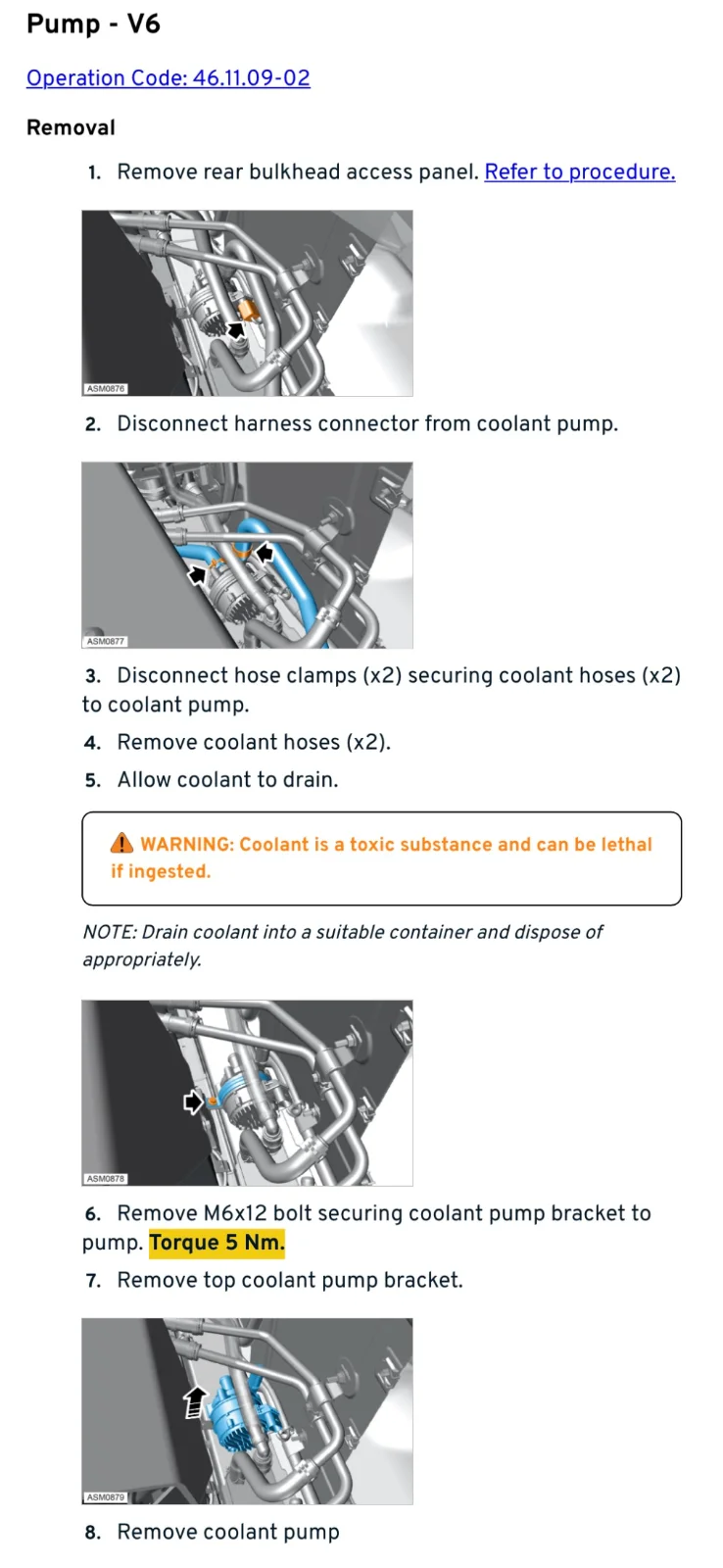

We actually do have an electric pump for the charge cooler on the V6. I still however disagree with just posting AI slop.
