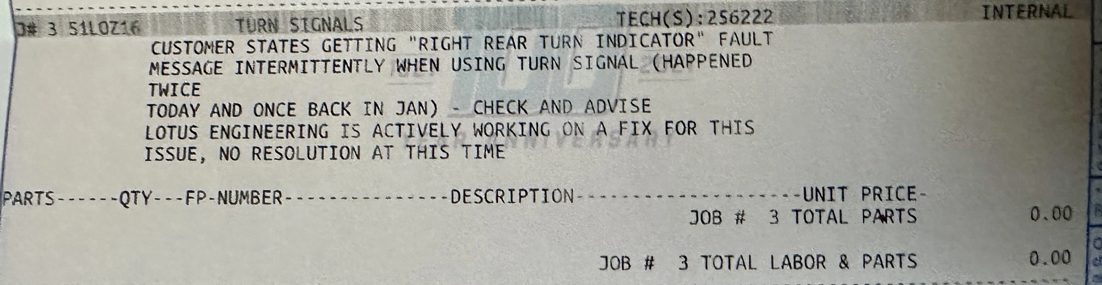

Only one small issue, that really doesn't affect anything, and Lotus Engineering is working on a fix. The Rear Indicator fault message will occasionally display in the cluster for short periods of time. However, the indicator is actually not affected and still operates. Oddly, activating the indicator seems to clear the message.

Just to backup that Lotus Engineering is looking at the rear indicator issue..
