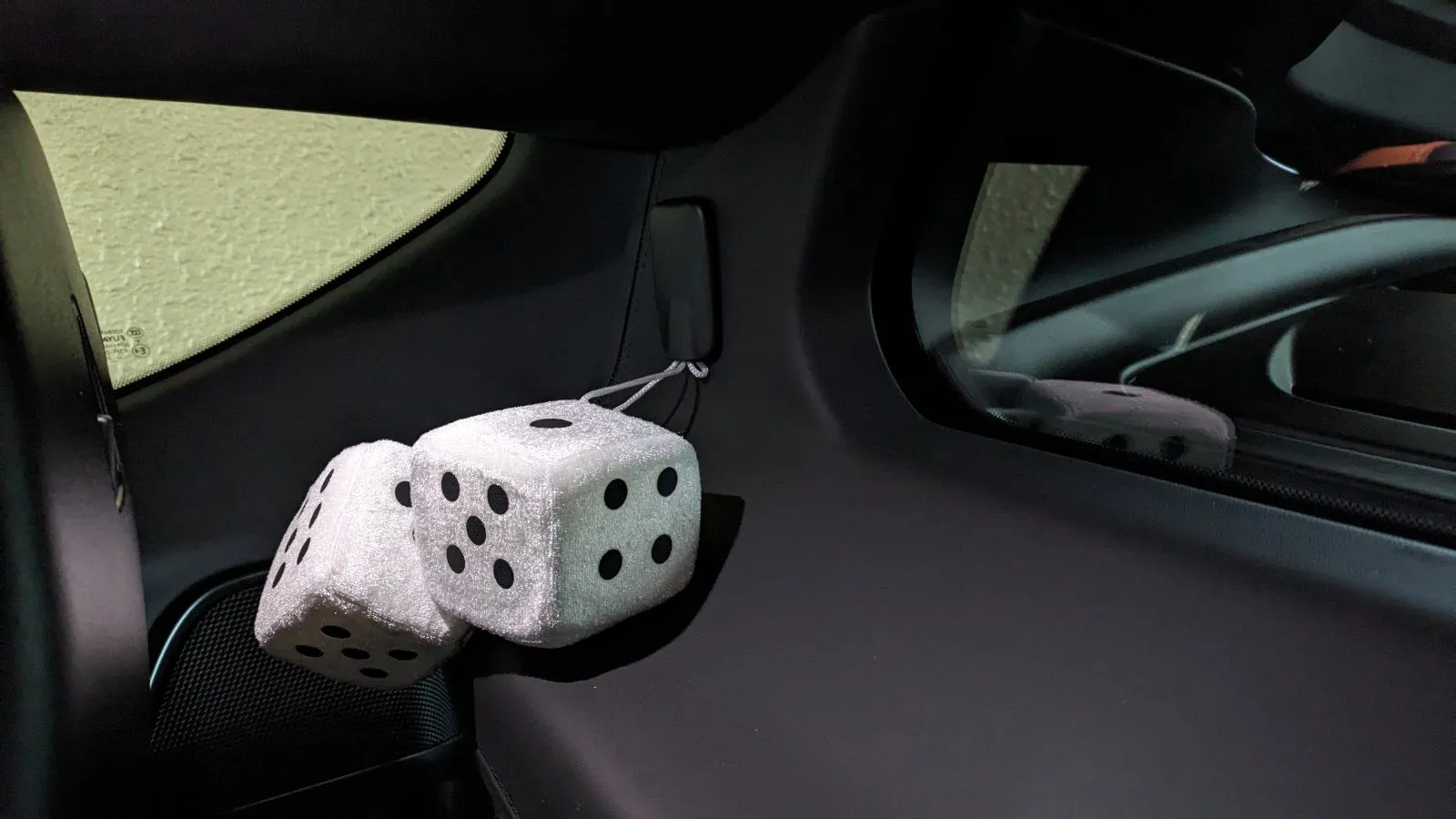

It's the fuzzy dice hanger.

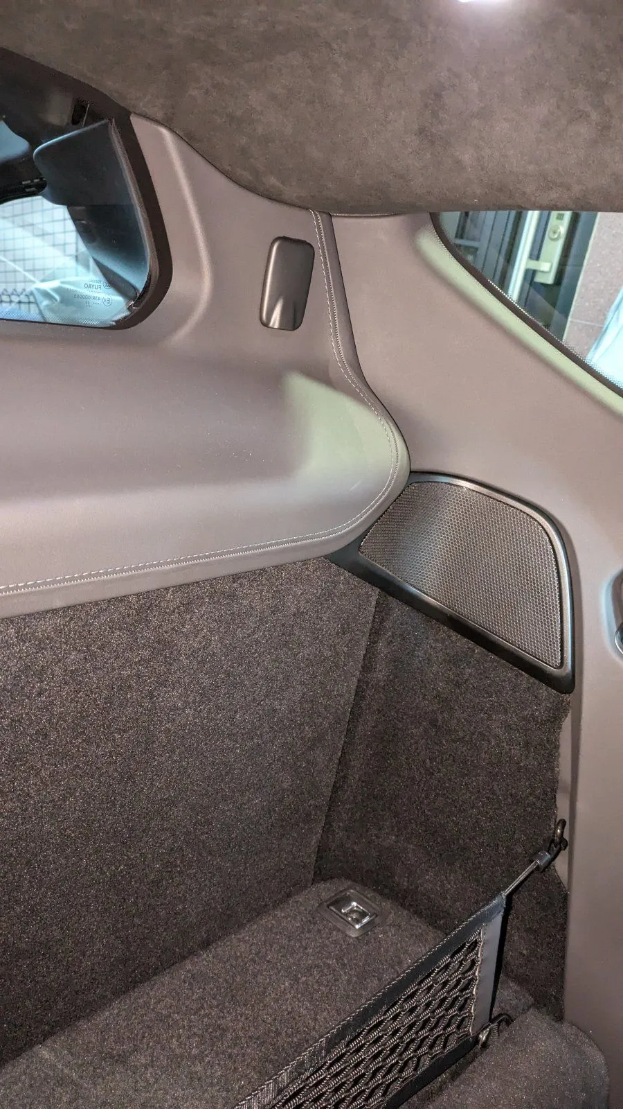

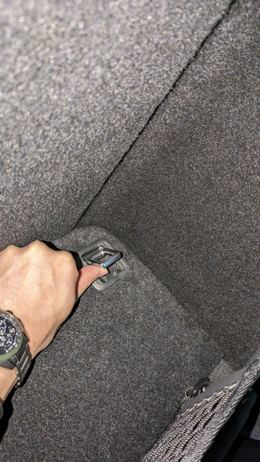

I reckon anchor points for a large lugage net. They are too far away to the sides (none in the center) for racing harness or child seat anchors.

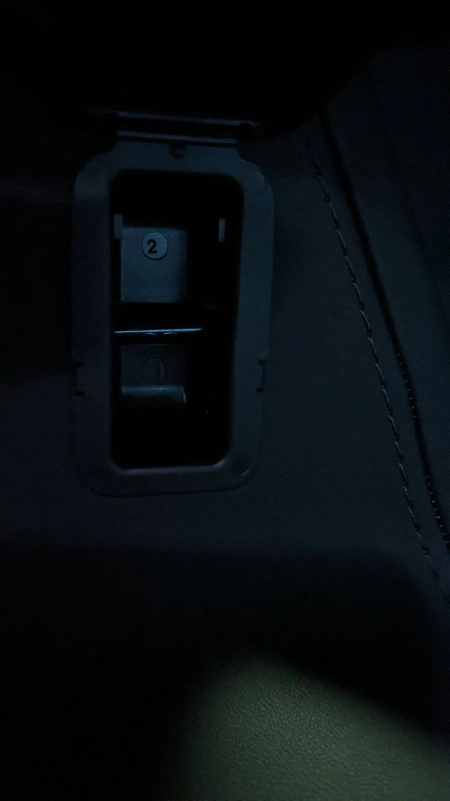

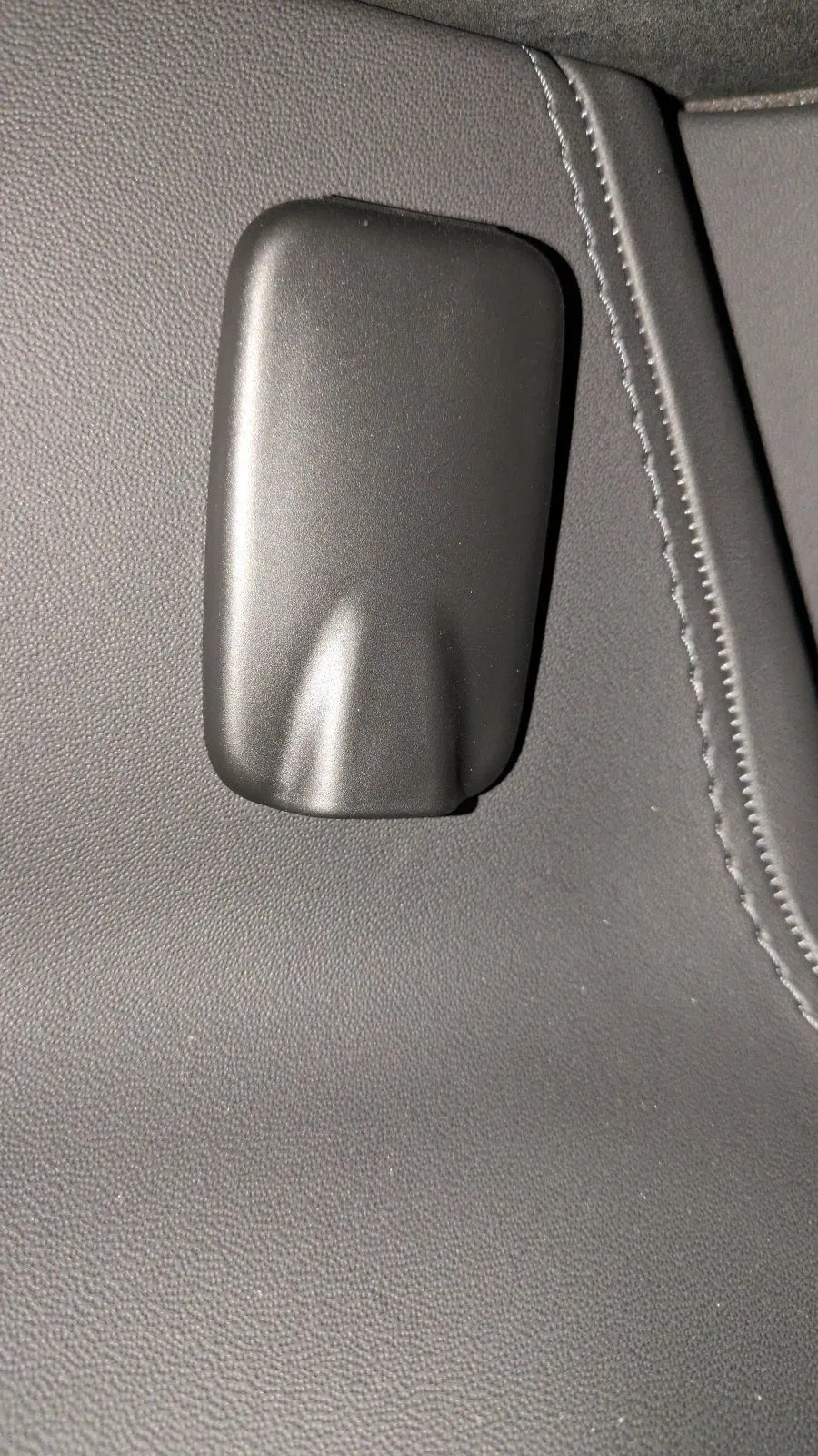

They are top tether anchors for a child's car seat mounted in the front passenger seat. The prototype cars had the LATCH system logo on the cover plate.
They're present on both sides in order to support both RHD and LHD cars without a production difference in the shell.

Interesting. I was thinking something like that but then @virtualmacho posted lower anchors.

I mean it's an arbitrary anchor bonded to the body shell. You can use it for anything you want. But it's positioned to provide upper child seat tethers as the first purpose. Should be good for a shopping bag hang point or something as well, with an appropriate carabiner.
