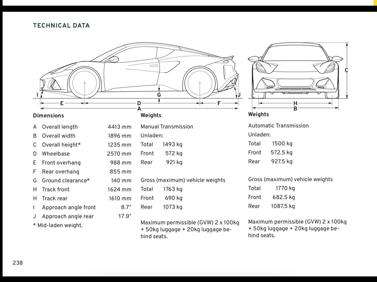

V6 First Edition Auto with all options is 1458kg and heaviest.
Although the handbook says 1500kg so that adds confusion.

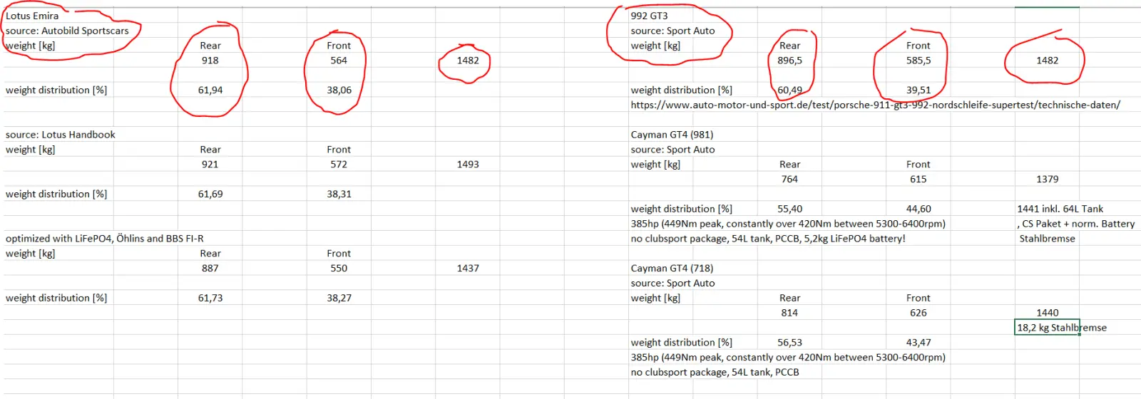

I made an astonishing weight distribution comparison, based on the data from the current Autobild Sportscars magazine (also available on readily). It seems as if Emira has more in common with the current 992 GT3 as we might think. At least weight distribution and overall weight are very similar.
Weight distribution is more on the 911 (40/60) side than on the 718/981 (45/55). Emira seems to have an even more rear-biased weight distribution than the GT3. That surprised me tbh.
