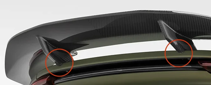

Correct me if I am wrong (I have not tested with a magnet) but my understanding is the body panels on the Emira are composite materials. This means drilling a hole is typically a no-no. All drilled fiberglass inevitably cracks over time. There are ways to mitigate and also prevent it.
For me to install a spoiler like this and drill into the bumper, I would want access to the underside to be able to first reinforce with 3 additional layer of 6oz fabric and epoxy resin. Then put a beveled edge on a 2-3" washer (depending on what fits) sandwiched with another 5 layers of 6oz fabric. This will add more reinforcement for the mounting points. It appears they intentionally created these "hooks" to help offset some of the stress on the top of the hatch, which is good. I would still want to reinforce it though.

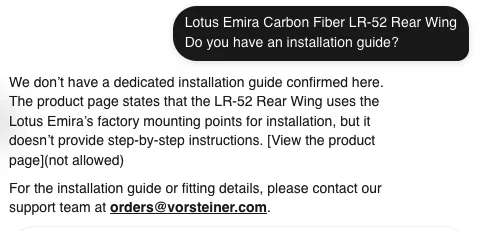

Their artificial interface (intentionally avoid the "intelligence" label here) states that is uses the OEM mounts. What OEM spoiler mounts?
Ask them for installation instructions. I’d be surprised if it was anything more than 3m double sided sticky tape and bolts/nuts. It’ll need drilled holes.

I do like the looks of it though. I am pretty sure it has some bolts underneath. I am curious if anyone reinforced the underside of the hatch (if you can even access it without cutting. If the bolts are designed to go all the way through and protrude the underside, then I am definitely not interested.
Installing this properly seems like a project.

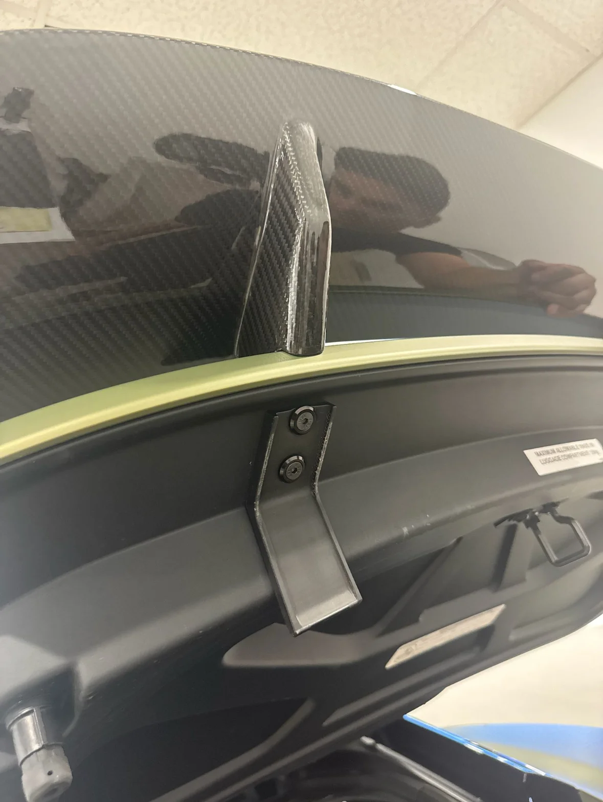

They did also send a pic of the mounting
You gonna do it then?
Pondering...
It is more likely than not likely. They do not include a template and recommend professional installation for drilling four holes and using a torque wrench ¯\_(ツ)_/¯
