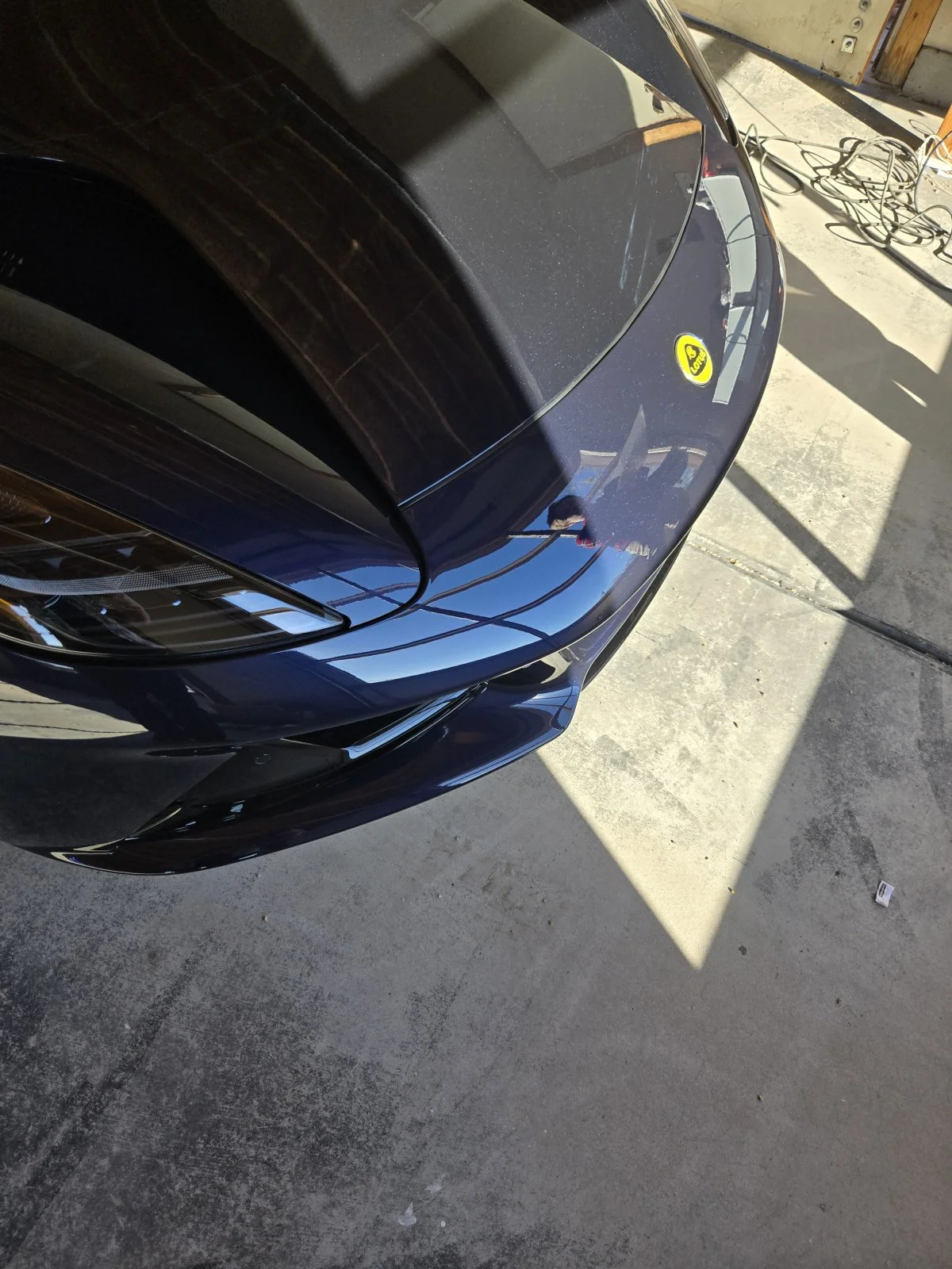

Two days after Thanksgiving I received a surprised phone call telling me that my 1st Ed. Lotus Emira order from February had arrived unexpectedly earlier then planned! However when I arrived to the dealership to take my first look at it, our salesman informed us upon PDI that the underside of the front bumper was devoid of any paint and that they needed to get it resolved before they felt comfortable releasing the vehicle to me. Well, almost 2 months later I finally took delivery two days ago. The dealership said they had an awful time trying to convince Lotus they didn't paint the car and it took a lot of arguing and back and forth before Lotus admitted to the mishap. So Lotus approved the warranty claim and we had a very reputable body shop add paint to the bottom of the fender. However, after taking the car home and washing it the bumper looked like this. (See attached Photo)
I took the car back and showed them the photo and explained how the bumper was a different shade of blue. At the dealership in direct sunlight the difference was not as extreme, but our salesman agreed that it did not look right and would contact us once he got some additional opinions. Later that day he called. He said the body shop only added paint under the splitter where it was missing, but then clear coated the rest of the bumper to match the applied fixed. He said the color difference is from the factory and the only way to fix it would be to blend the bumper into the surrounding panels. He also talk to a PPF guy who echoed the same thought and said that even PPF wouldn't hide the color disparity and that the paint would need to be blended.
I have no reason to distrust what our salesman is saying, they have always been amazing and forthright. The dilemma I have currently is that I do not want my paint to be blended. I don't want the rest of the panels to be ruined to match an off colored bumper that accounts for a small part of the car. I will notice it and it will bug me to no ends. Second, the idea I need to send a brand new car through a body shop two days into ownership where it will come out looking as if it was in a accident seems ridiculous to me. Lastly, anyone with a discerning eye will know it had aftermarket paintwork done to it which will impact the resale value.
What are my options? Can I request a factory painted bumper to be delivered? If they cannot return the bumper to factory condition can I request a trade, a buyout? Or am I overreacting? Have others experienced mismatching panels from the facotry? I absolutely want to keep this car, because aside from the bumper I'm in absolute love with the Meridan Blue paint. It looks like a night sky with the blue and silver flake in it.

I happen to have a Meridian Blue as well. After an accident at the track, I had to get several areas painted. I too was worried about how it would look. I chose the shop—they’re the ones who people take their cars to after another shop has screwed up. He did an absolute phenomenal job. Wasn’t cheap, but it was well worth it. I’m in southern NH.
I agree that those pictures don’t do it justice, but I can already tell the paint is off. You need to control the lighting to get a good picture. I recommend using a bright white light up close in a dark room.
There is no way anyone can look at that photo and know what you are talking about.
Disagree. The front bumper in the photo has a different hue than the 'hood' panel.
#5e5f65 above the seam
#64667b below the seam
Same shadow across the two panels. Same reflection.
In RGB terms it's nealy +30 in all hue tones. In person it sounds more discernable

I'm wondering if they sprayed the front bumper. The flake laid flat and didn't have any depth to it like the rest of the car. The rear bumper is actually faintly darker then the rest of the paint, but not noticeable, where the front is a lot lighter. I would suspect the rear and front should display the same hue at the very least due to material similarities. Maybe I should take it to a different body shop and have them inspect it to see if its been repainted.
If all they did is put clear coat on the bumper to make that colour difference then you could just do the same for the front cover.
That's the biggest edge to edge panel line. The rest are short lines or odd angles that might not show up any colour differences too much.
Looking at the photo, the only difference I can see is that the bumper looks darker and that can easily be explained away by the lighting.

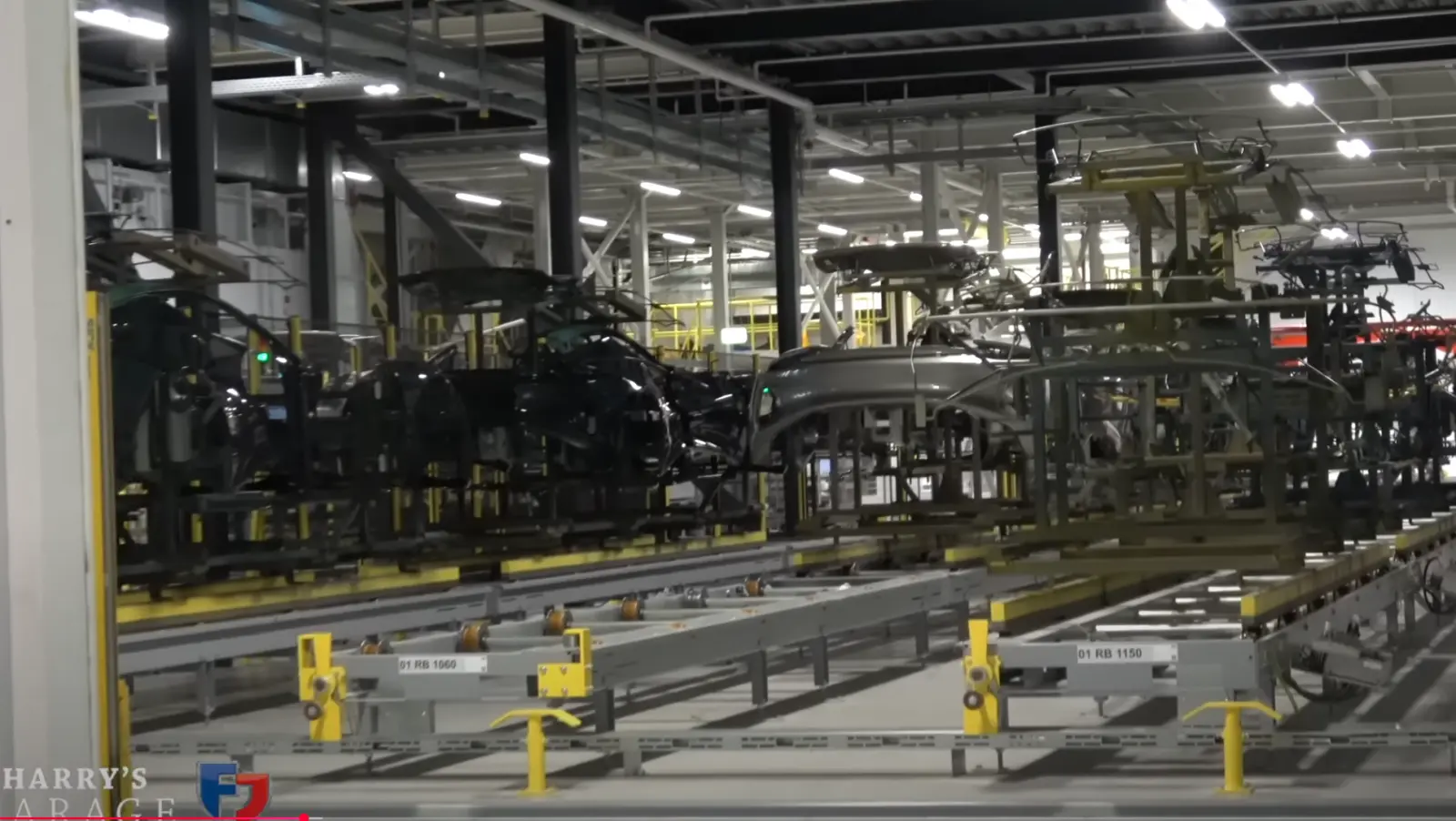

Image from the Harry's Garage factory tour video, showing the factory panels on frame jigs coming out of the paint process. These are all painted by robot and get absolutely consistent paint coverage, then are individually inspected and approved for forwarding onto the production line for fitment. The idea of a whole surface of a panel coming out without paint is not believable.
There are multiple steps in the process where this would have been caught, including the assembly/mounting process on the main production line itself. They would have rejected the part when they took it off the rack to fit to the vehicle.

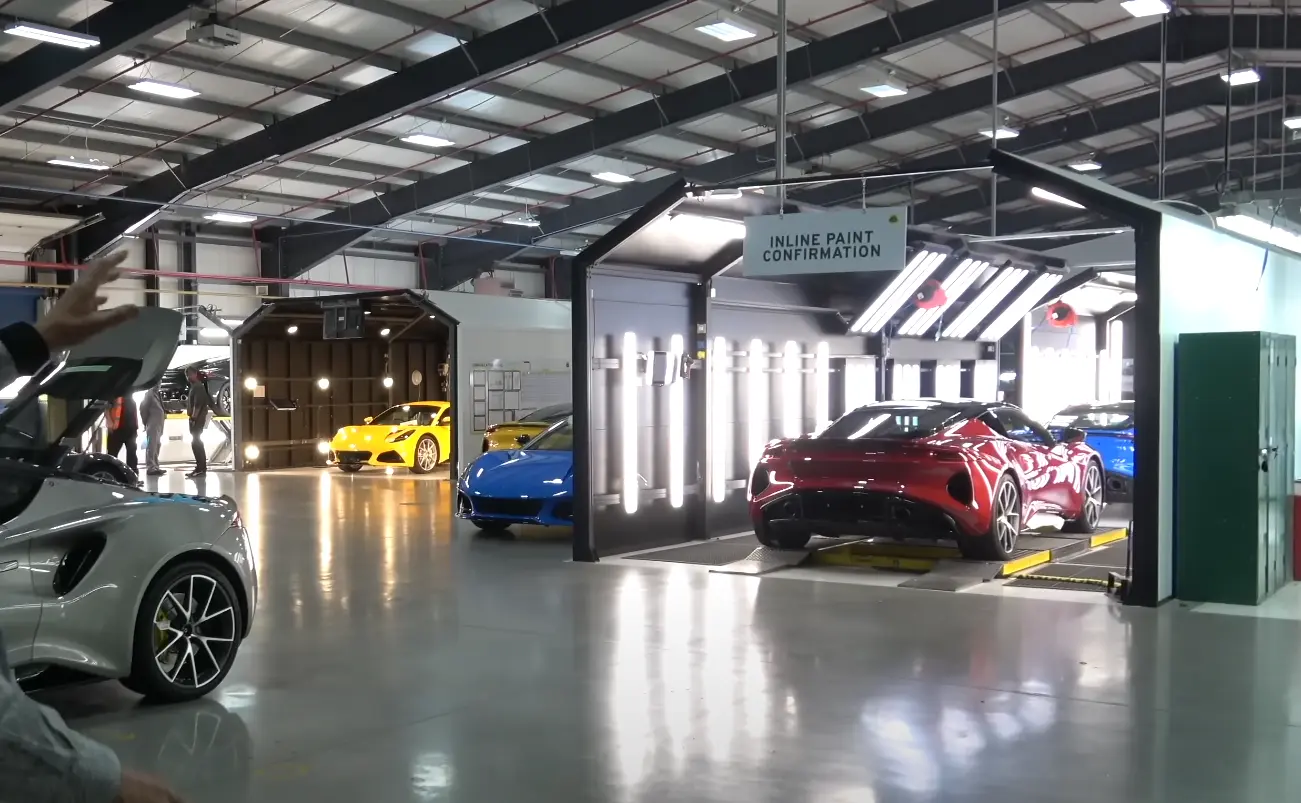

Here's the final paint confirmation and inspection bays, they look over every surface of the cars again before approving them. A bumper coming out partially unpainted is, again, not believable.

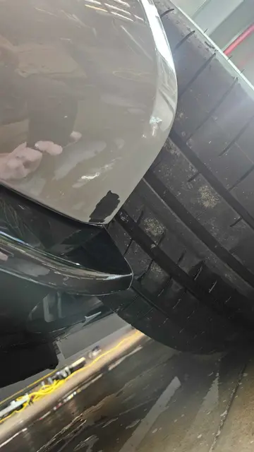

I am currently going through something similar. I took delivery on 12/20/24 and returned to the dealer 1/6/25 to have PPF and tint done. When the installer attempted to cover the rear with PPF, he noticed a spot that wasn't painted (about two inches wide) on one of the panels close to the rear passenger tire. It wasn't visible unless looking at it from the ground. Lotus admitted fault the next day and approved correction under warranty. So then my car was loaded on a flatbed for transport to a specialty paint correction facility. No idea when I'll get it back.
The issue (as described by my dealer contact) is that when the PPF is eventually removed, it will likely take surrounding areas of paint with it and create a much bigger problem. Since the affected area isn't visible from almost any angle, I'm less concerned with their proposed fix. Just hoping to have my car back before the weather warms up and I can actually drive.
The issue (as described by my dealer contact) is that when the PPF is eventually removed, it will likely take surrounding areas of paint with it and create a much bigger problem. Since the affected area isn't visible from almost any angle, I'm less concerned with their proposed fix. Just hoping to have my car back before the weather warms up and I can actually drive.View attachment 57616
That looks to me like it’s been painted, but the paints come off, due to a contaminant on the surface prior to painting. I’d check how adhered the paint around that area is.
