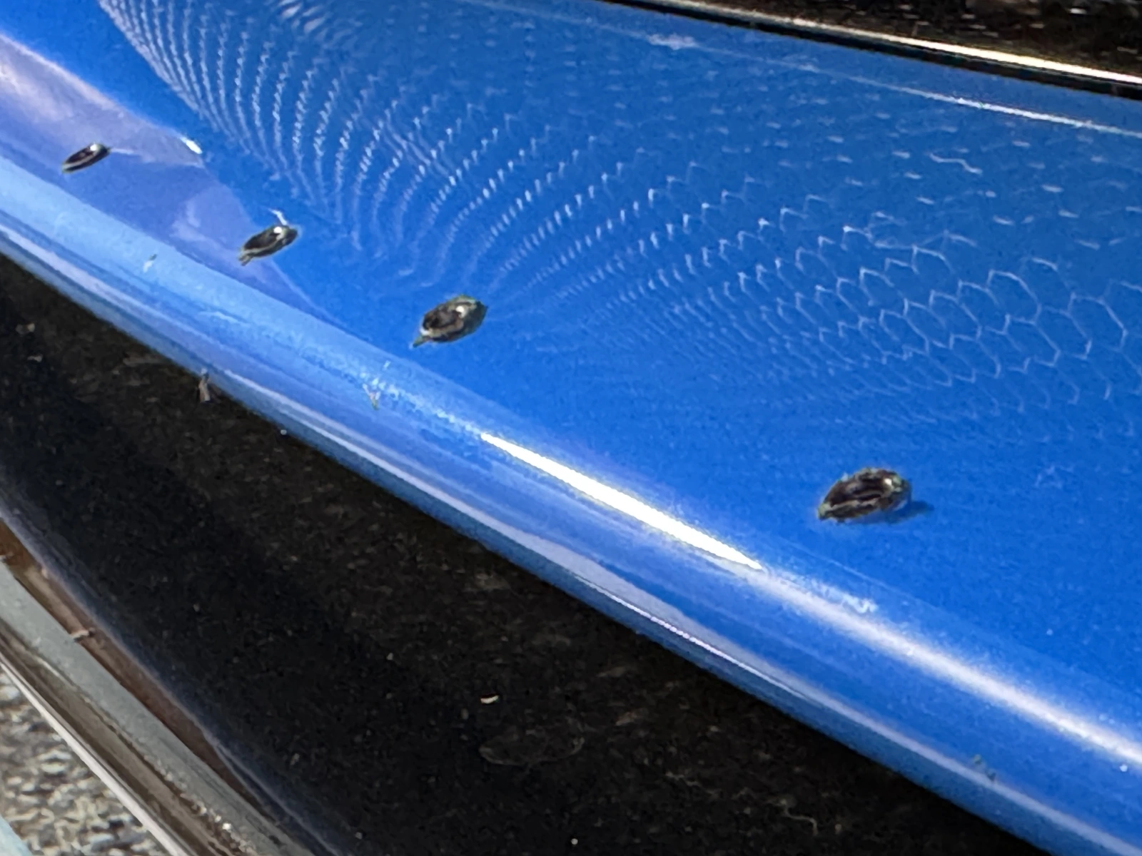

I bought my car used, and unfortunately, PO drilled holes in the front bumper to mount the plate brakes. For now, I'd just like to plug them with a body colored plastic plug, it's not perfect, but certainly would be less visible than the hole itself. Want to get something close to body color, because I'm going to get the front PPF'd, and even though its not perfect, Ill have the PPF over the plugs. I don't understand why anyone would spend this kind of money on a car and not find a plate bracket that doesn't require drilling holes in bumpers. :(. Front plates are vile.

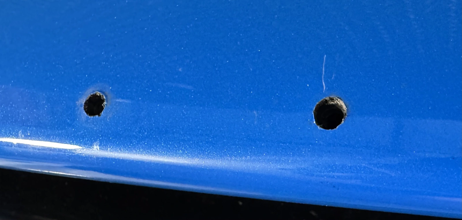

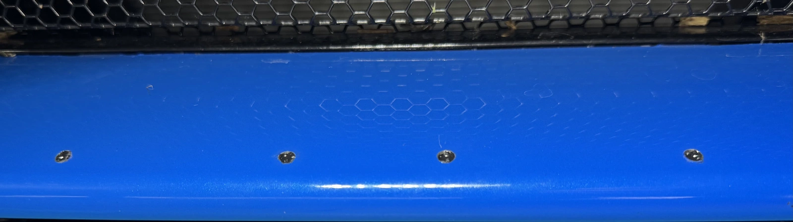

This is what I have to start with. Stupid previous owner for mounting a front plate. $100k+ car and can't be bothered to buy a bracket that mounts from underneath.

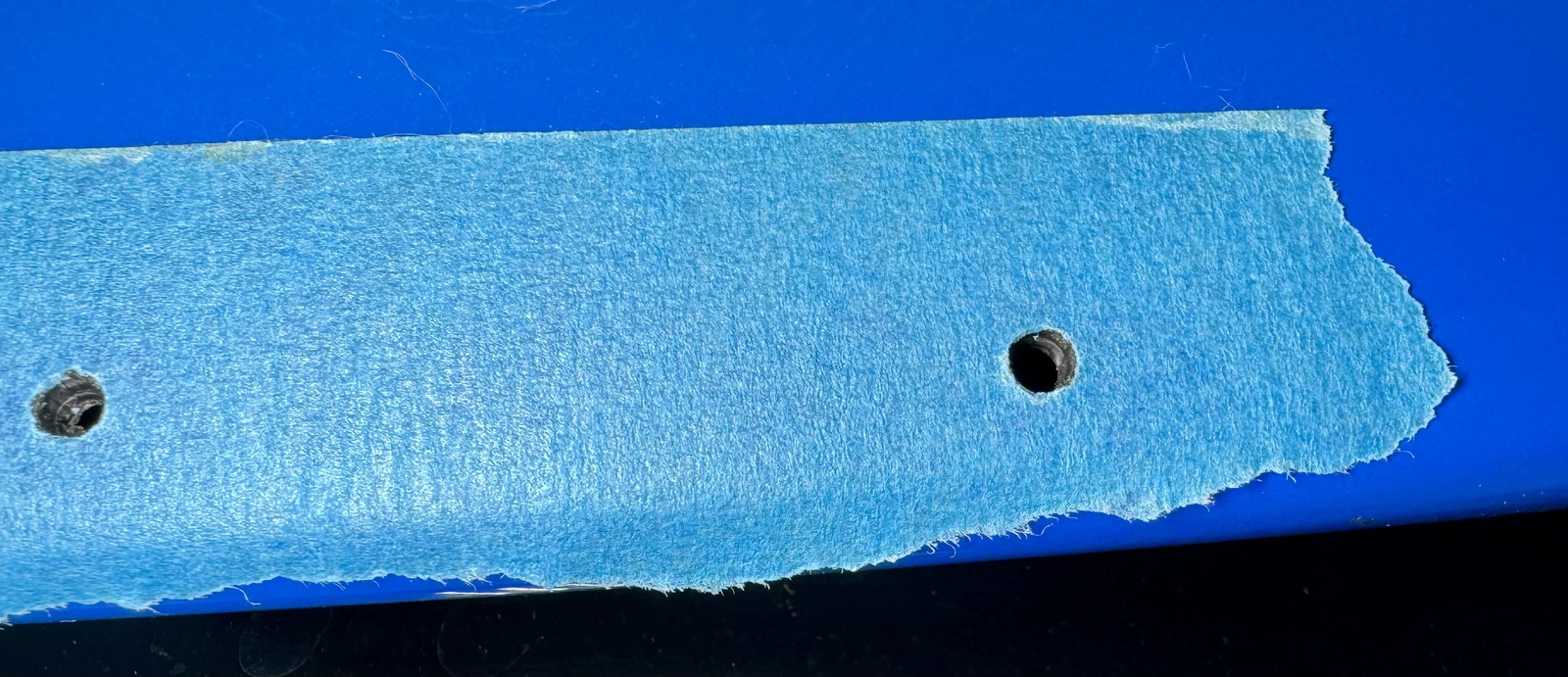

So, I started off by using a VERY sharp exacto blade to trim the crown. You know how the story goes, I'll be careful. Ugh. It was all going great, till on one of the holes the blade slipped as I pulled it too far out of the hole and it did scratch the paint. I can catch it with my nail, but I figure I can polish it out after I'm done. And if not, put a bit of blue touch-up paint on top, or maybe just clear if that works. I don't think I went through the clear. But we'll find out. If not, I'm okay with that scratch, even as annoyed as I am at myself.
3 of the holes didn't go all the way through. But the 4th one on the right DID go all the way through. this made filling that one a bit hard because I couldn't pack the filler in there. if I didn't what will happen is the filler won't adhere and it will drop out or sink causing the touch-up paint I put-on top to crack.

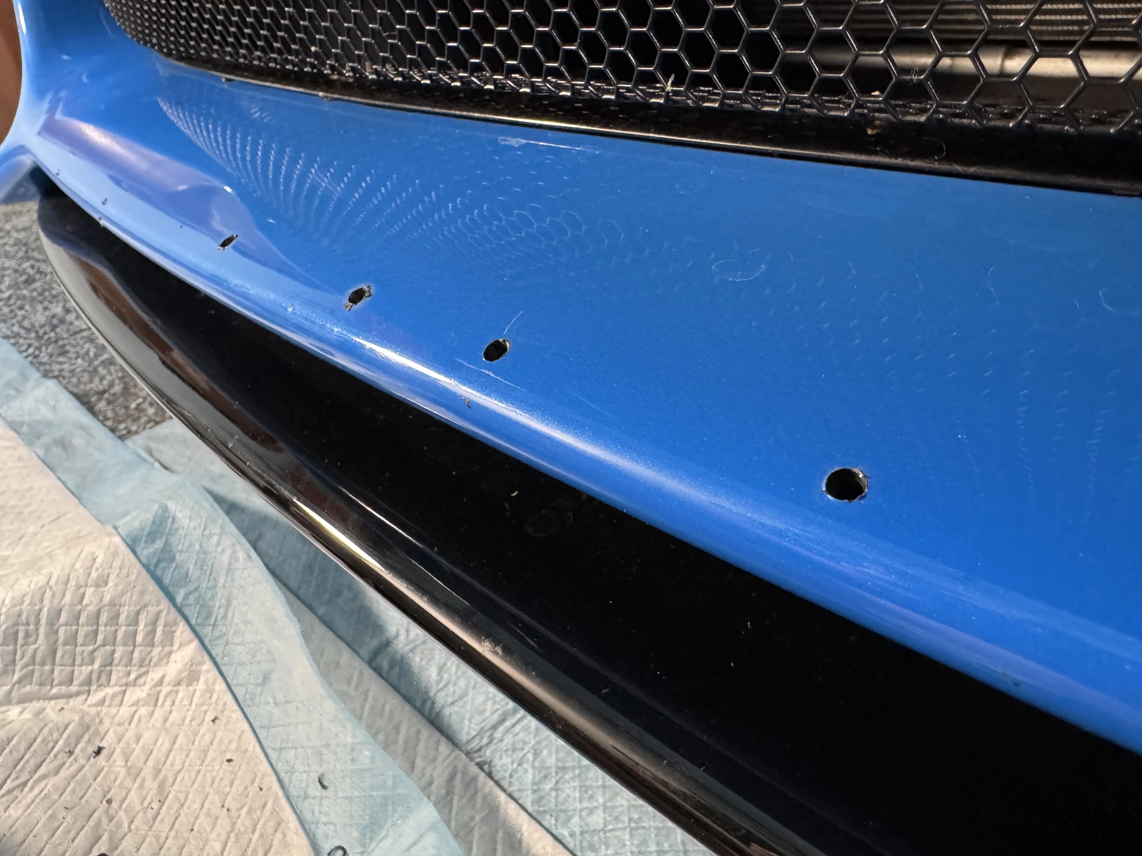

So after I cleared the crowns off, this is what I was left with.

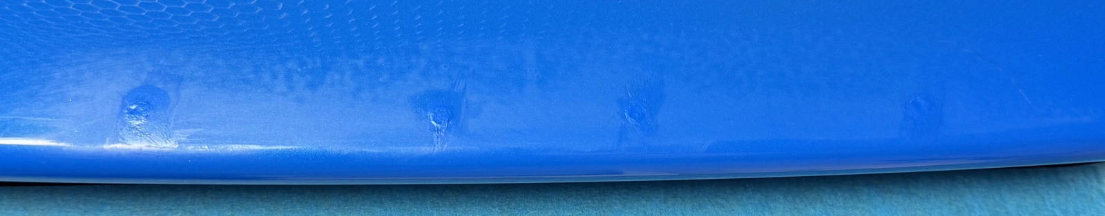

Before:
After:
You can see the scratch the blade put into the paint here. :(. I'll try and fix it, but I'll have to live with my mistake. I still maintain the worst case scenario is I have the bumper painted in that area. dont' want to, but maybe next year.

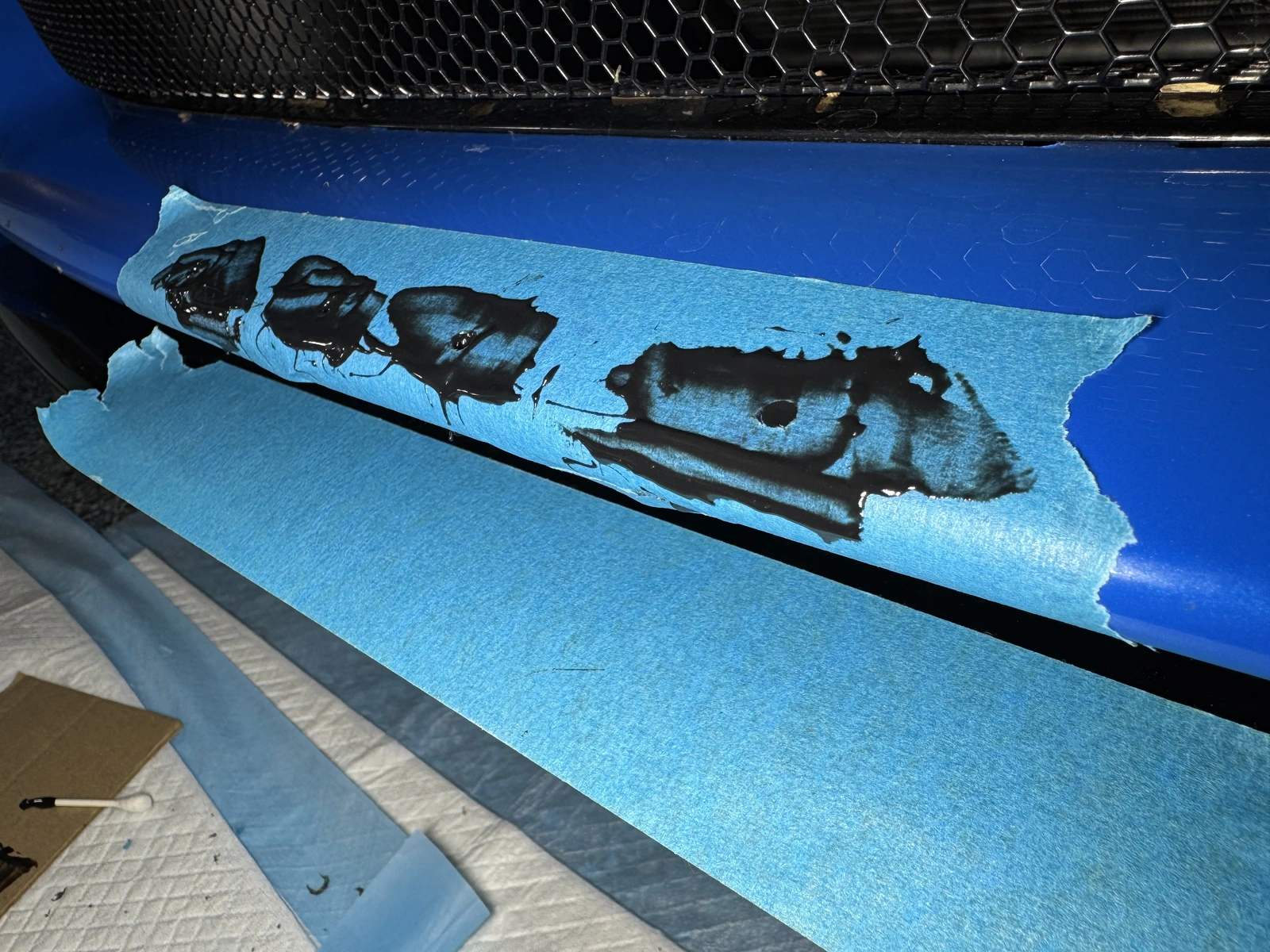

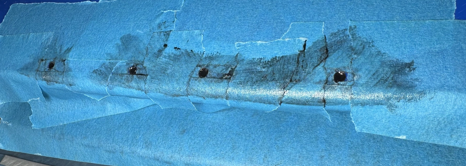

Then, I put a layer of painters tape down, I ended up putting a different layer down later on to completely cover the lip when I saw how messy the filler was going to be.
After I put the new layer down, I added another layer to the splitter. Because this stuff is goopy and I could see it dropping onto the lip.
Then I mixed up some, and started to force it into the holes. I used a wooden spreader that came with the filler, and a Q-Tip cut in have to try and ram the filler down the hole. I need to wait a bit longer for it to thicken up which helped on the last hole.
Then, I didn't want to wait for the filler to harden completely and become pain to cut off so after about 30 minutes, I removed the paint, and using my nail I was able to carefully remove any flash that was above the paint layer.
It's clear I'll need a 2nd much smaller application. Because it sunk down quite a bit.

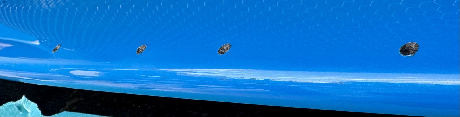

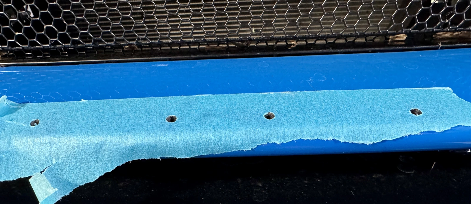

Application #2 waiting to set so I can remove the tape and see how much more I need to fill. I may get to a point where I can't use the tape and will have to very quickly fill, then wipe off the excess. We'll see how it looks after the 2nd application. Might need a 3rd, or 4th to get to a point where I can fill in the rest with primer and base/clear.
I'll be honest, even if I were to apply the touch-up paint to a dip in the paint, it would look better than bumper plugs sticking up, and causing the PPF to bubble around them.
Okay, 2nd application is done, just needs to cure now. I don't think it will sink much further. I'm gonna leave it here and then use a layer of primer, then touch-up Seneca Blue, and slowly layer that up, and finish with clear on top. Then I should be able to wet sand it smooth and buff. And the repair while it will always be visible, I don't think anyone will really see it at a glance. Which is what I was going for.
We'll see what they look like after 24hrs.

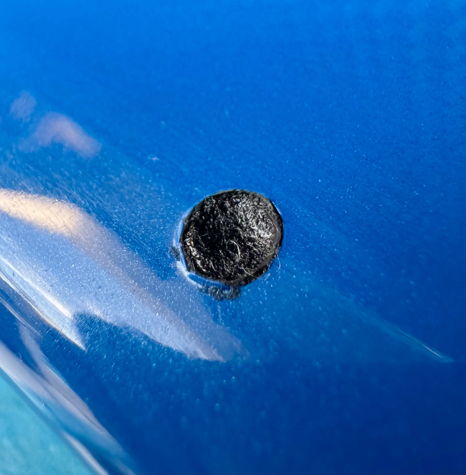

24hrs later, holes look pretty filled. Feel pretty solid. I did notice a bit of crowning in the light reflection, so I might lose a bit of paint when I sand the area after adding the touch-up.
This is where I'm leaving it for the night, the touch-up needs to cure fully before I can try and level it out.
I'm not happy with the 2nd hole from the left. I think it's raised up too much, and I might have too much primer in there. If I do then when I go to level it out tomorrow, I'll expose the primer instead of flattening it out. If I do expose the primer because it's too high, then I'll remove the primer and re-fill the hole. Would suck, but is fixable.
I'll try to level with 2000grit, which is pretty fine. And if I'm left with a bit of a bump, then that will be that and I'll leave it as is. If I think I can get away with it I'll use 3000grit wet sand to blend it all, then polish.

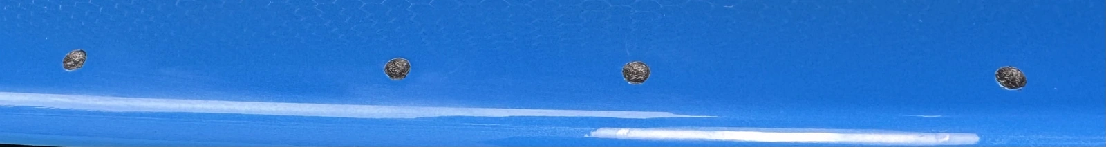

That should clean up a bunch with some wet sanding and polish. We are looking at very zoomed in shots. Sand it down, take it out in the sun and look from a normal distance and it will probably be fine.
Sad news. Went to wet-sand it, and before I even got there, I went to wipe the panel down with a bit of soapy water and a microfibre towel to remove anything on the paint and the touch-up wasn't adhering, peeled right off in some spots. :(
I spent like 20m prepping the filler and surrounding area to remove oils, and ensure the primer stuck.
So, new plan. Drill the holes out deeper, wet-sand/buff the surrounding paint to remove scratches, then just fill in the holes and keep the level below the paint. Then tell the PPF installer NOT to correct that spot at all and just very carefully install the PPF over it.
Sorry to hear that. Maybe some more sanding before primer is in order. Unless you have a deadline for PPF I would give it one more try.
