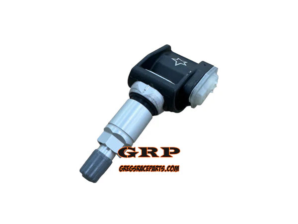

I've got 2 sets of tires/rims and had to buy TPMS sensors for the extra set. I couldn't do so locally, so bought an OEM set from Greg at GRP (Greg's Race Parts) and they work just fine (no calibration required):
