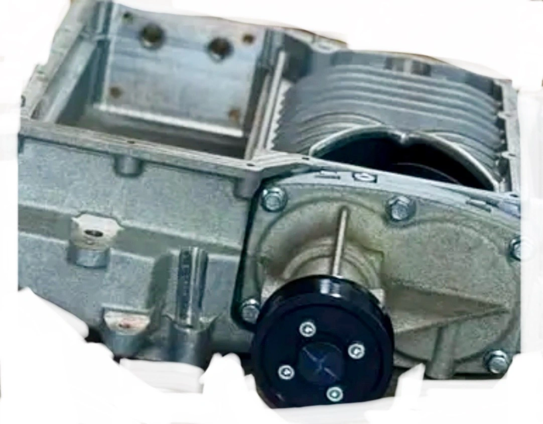

I’m curious how the cooler works on the Emira supercharger with its placement on the side and not after the blower exit port. Maybe I’m not seeing how the superheated air is ducted before the intake?

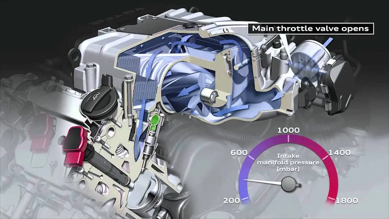

similar to this Audi Eaton unit, except that the Audi 3.0 splits the SC exit flow left and right to flow over two heat exchangers, whereas the Lotus Eaton/Edelbrock unit sends all air (aft) through one HX.

Got it thanks. So after it’s cooled it has to make the split into each side of the cylinders. Twin 180 degree turns
