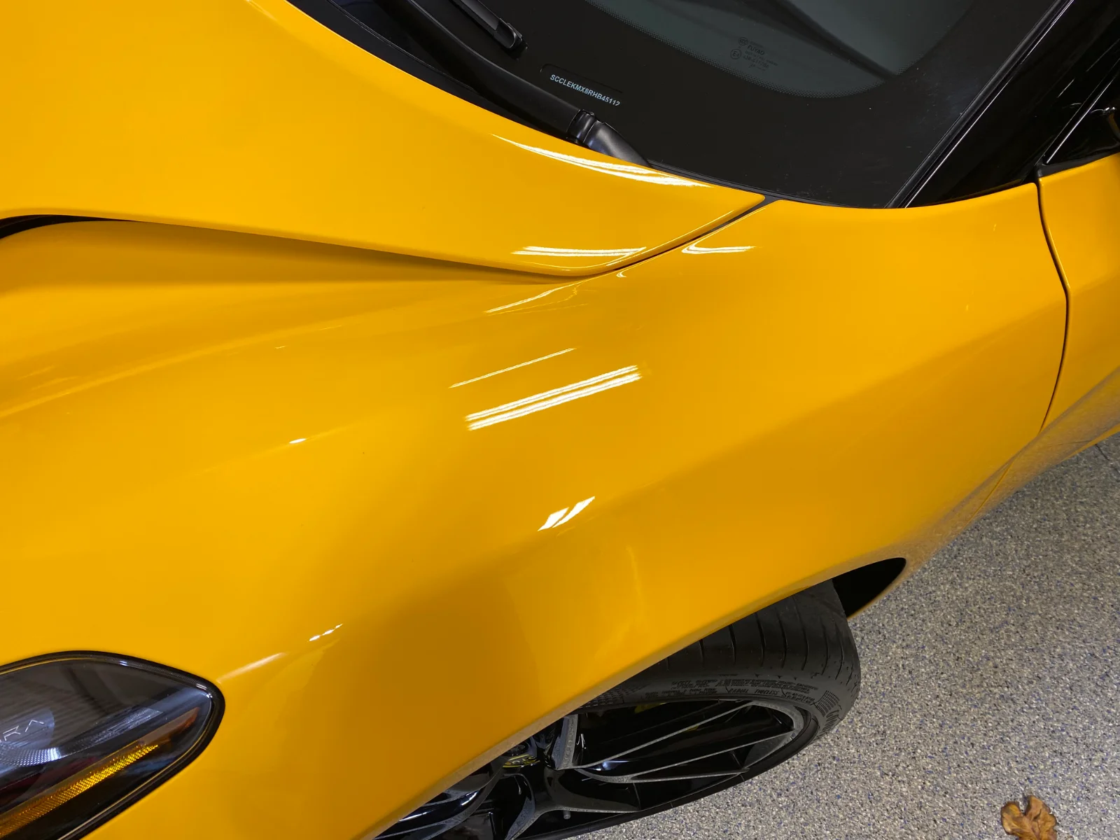

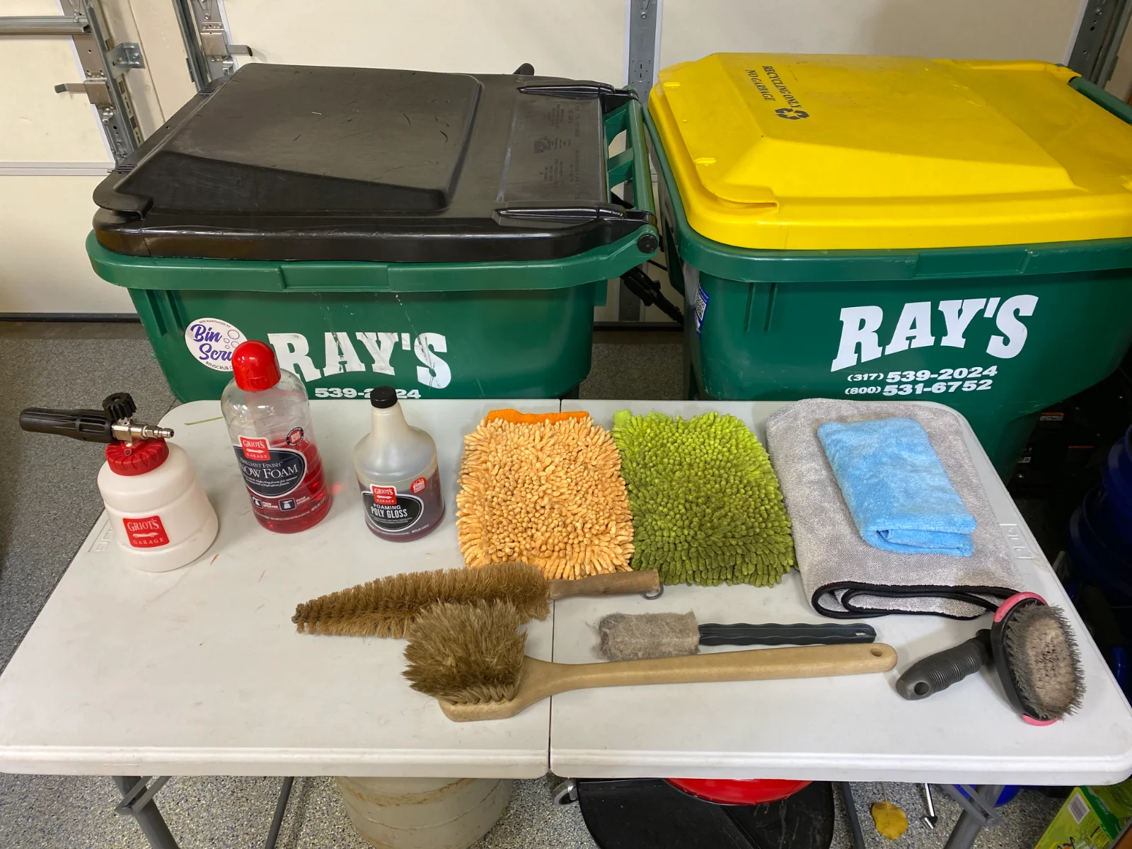

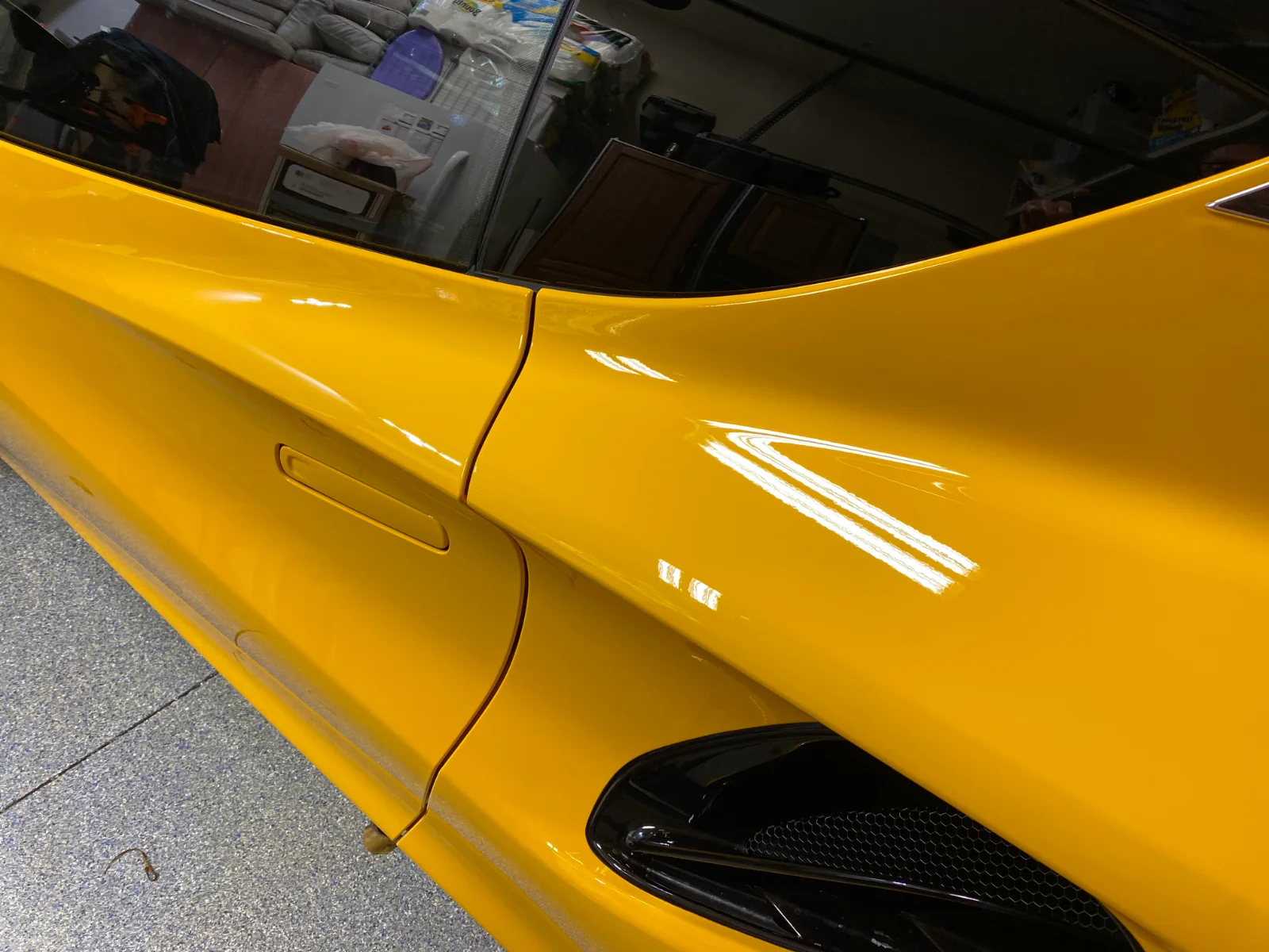

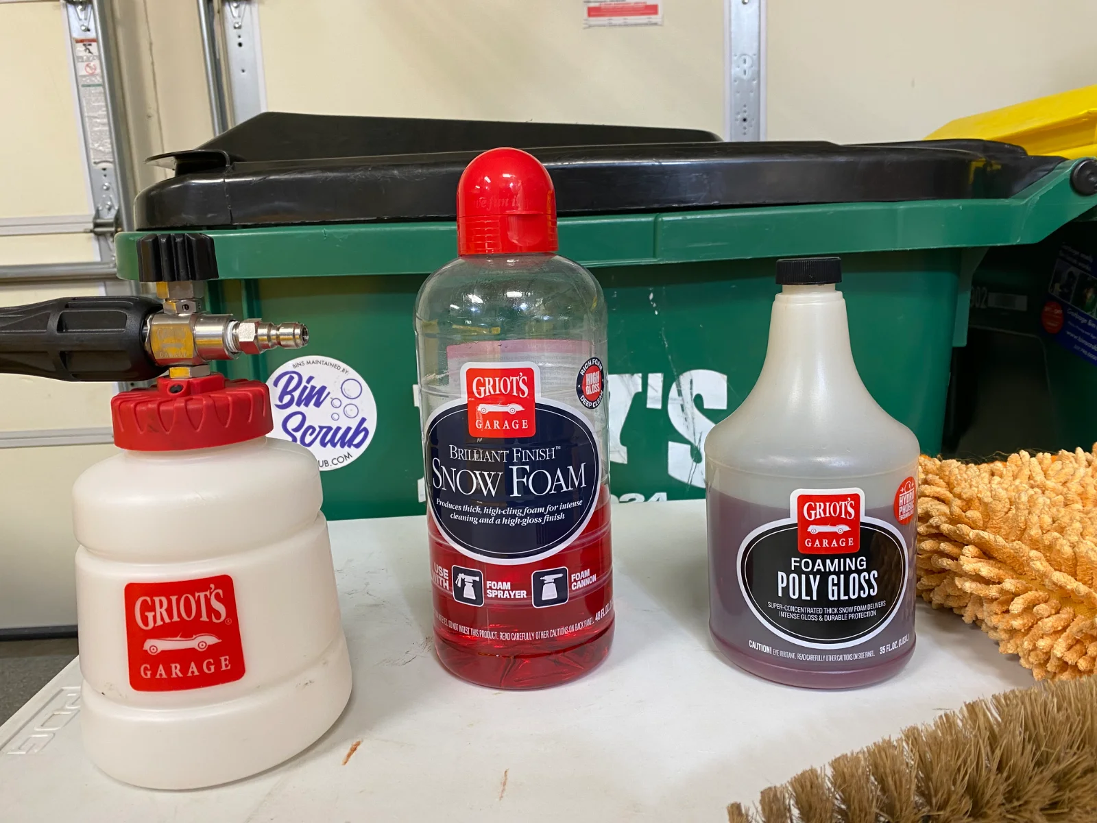

My Emira was ppf’d with the track pack and ceramic coated. So far it has only been hand washed using Griot’s products. Pictures show products used and I am reasonably happy with results. I do air dry with leaf blower before toweling. Only improvement that might be considered would be to use deionized warmer for rinsing. May need to find a touch less car wash to use in winter.

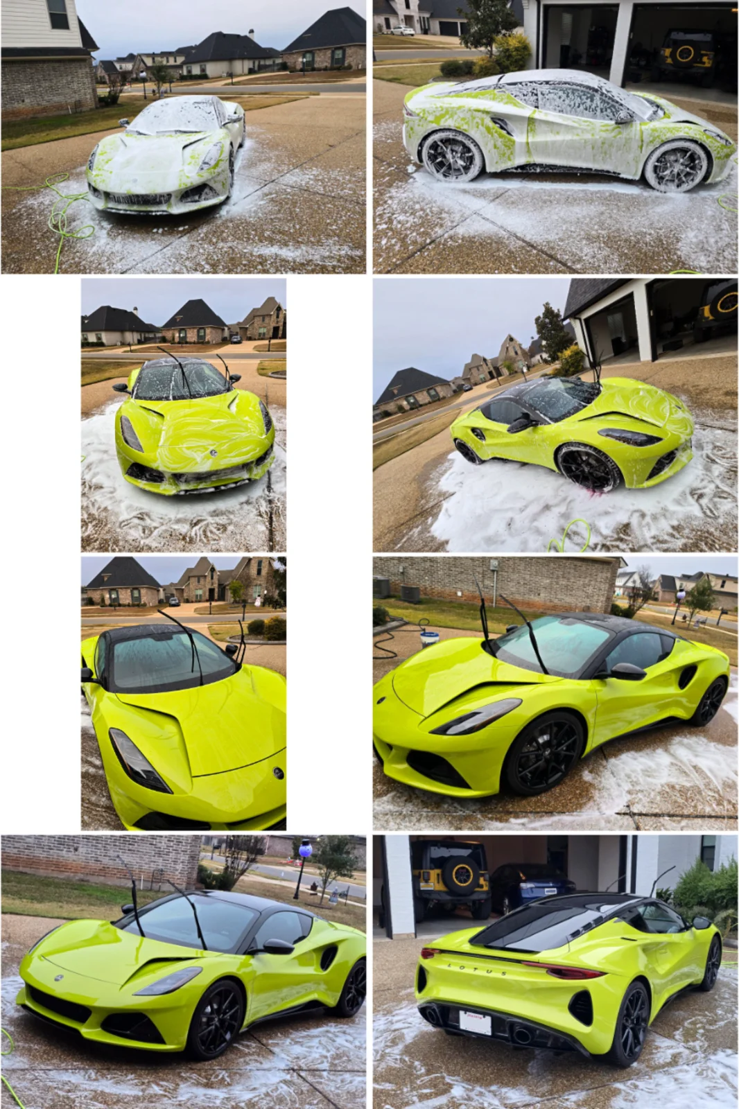

Not my own setup, it's my roommate's setup, but It's what I use to wash my car.
Car is self PPF'd.
All steps are done with a 1800psi pressure washer
1. Koch Chemie active foam (HEAVILY diluted) as pre-wash foam gun with softened water (car + wheels)
2. Full Rinse off with softened water
3. Meguiar's Gold Class (mild dilution) with a cap of ONR as main Foam wash foam gun with softened water (car + wheels)
3a. Microfiber Sponge to agitate foam on body (no pressure applied, just gentle once over)
3b. Separate Sponge to wash wheels if i feel like it or if it's extra grimed up, otherwise I don't even touch
4. Full Rinse off with DI water
5. Dry with 70/30 twisted loop giant towel on body
car washed usually every 2 weeks, 3 weeks max.
Kranzle K1122TST Pressure Washer
