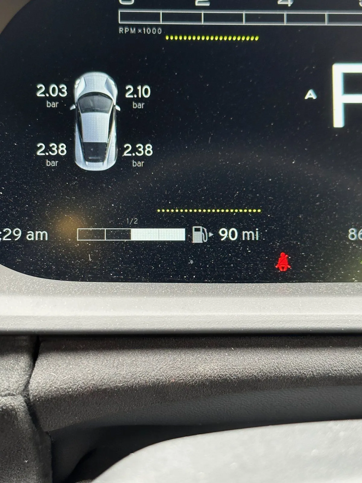

sorry chap I understand how it works just hadn't picked up the line was a graphical representation of fuel level I thought it was a graphical display of the range number. I would prefer to know quantity numerically.

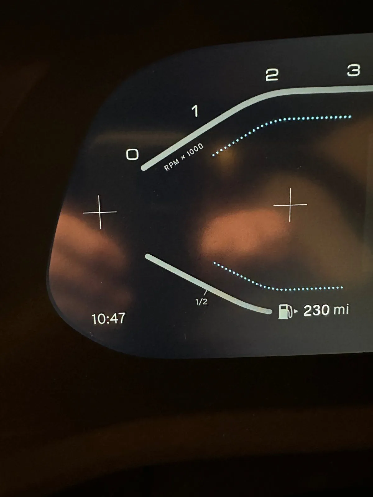

I just got a photo of the line which is showing full but a range of 230m. I went to get the MPG but its all gone due to disconnecting the battery last night. I think it was about 19mpg as I have been running all over in it mostly in track mode.....of course.
If it holds 58l (12.775 real gallons :-) then 19mpg gives a range of 242m so 230m displayed now seems reasonable.
I have just brought up the image of the gauge and range (in track mode) on my mac and noticed the 1/2 marker which due to my eyes being painted on had not seen before. Forgive the dust.
The manual cleary shows its a level/quantity indicator. Never thought to check 🤡

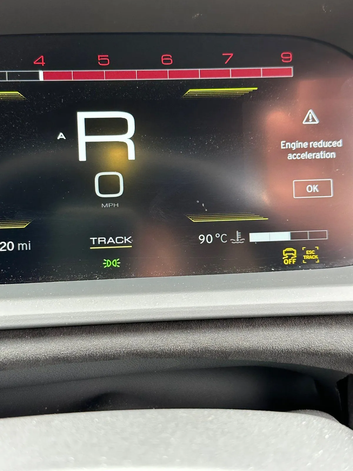

This was at the point that it had run out of fuel...
This is now.....
So its reset all data as I disconnected the battery last night.
I assume the software won't do another calculation until its supplied with new data after a period of time moving?

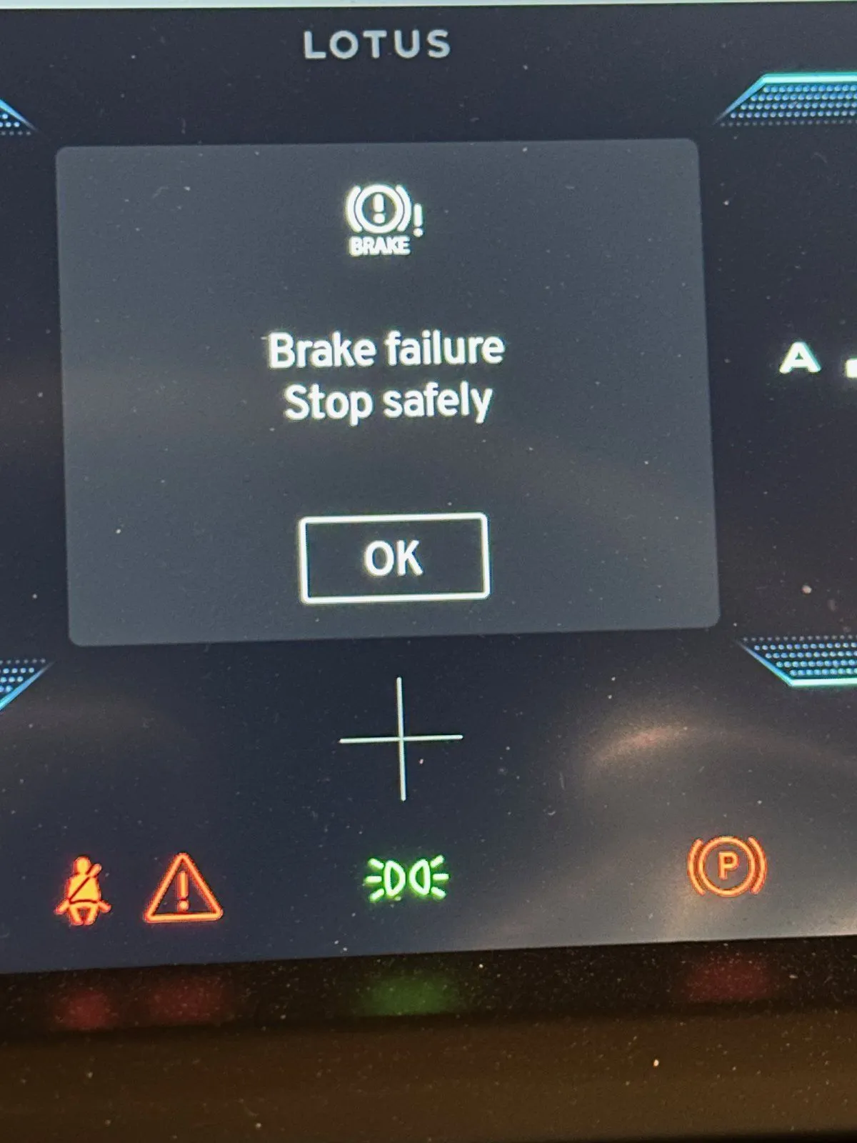

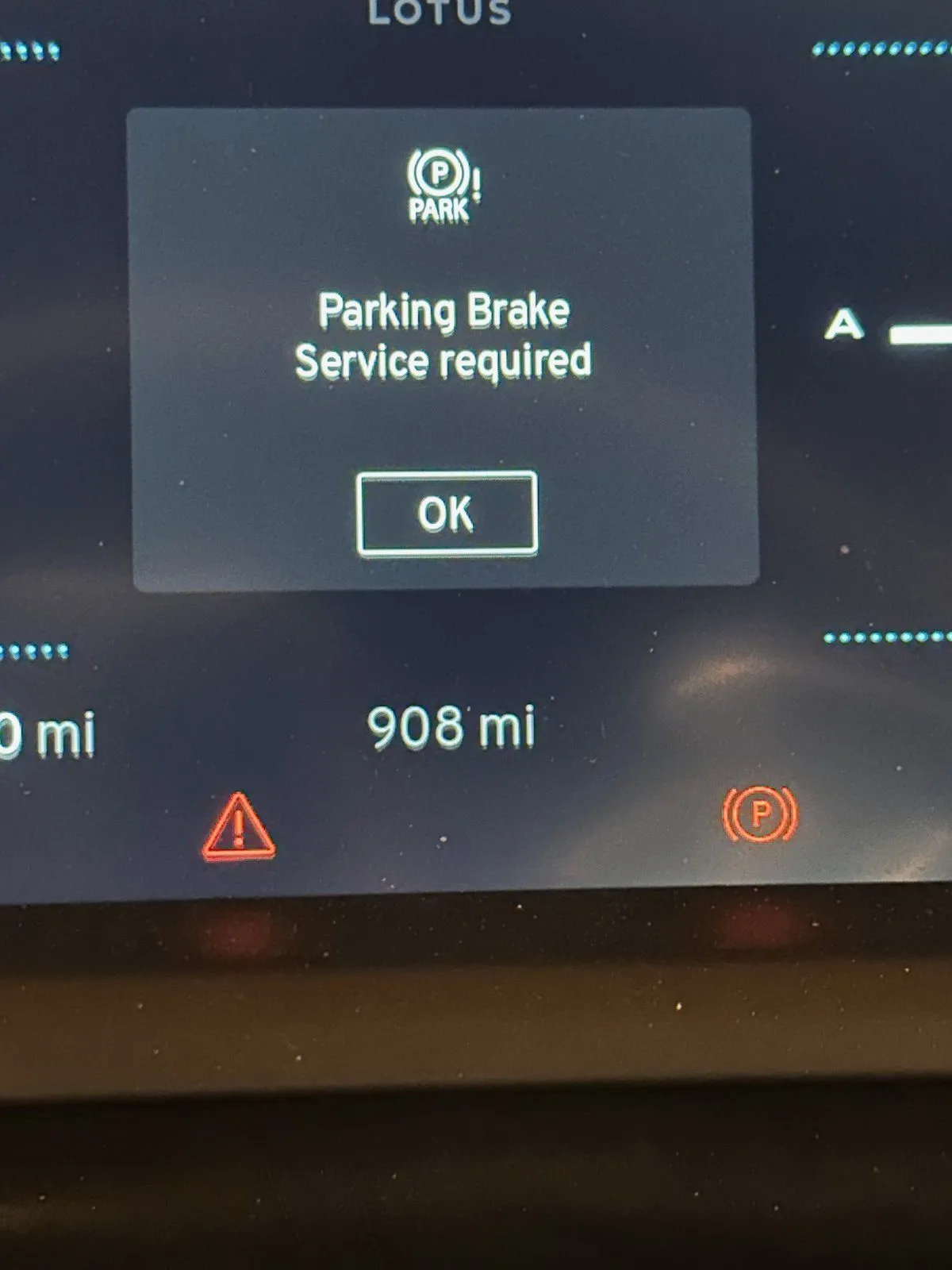

Sat in the garage and ran if for a minute or so. Brake warning caption and yellow triangle in amber. No other warnings.
Moved it a few feet back and forth and turned it off. Got out locked it.
Unlocked got in and started engine......
All captions and warnings gone
A friend is heading over with a decent code reader to see if there's anything left lurking in the background.

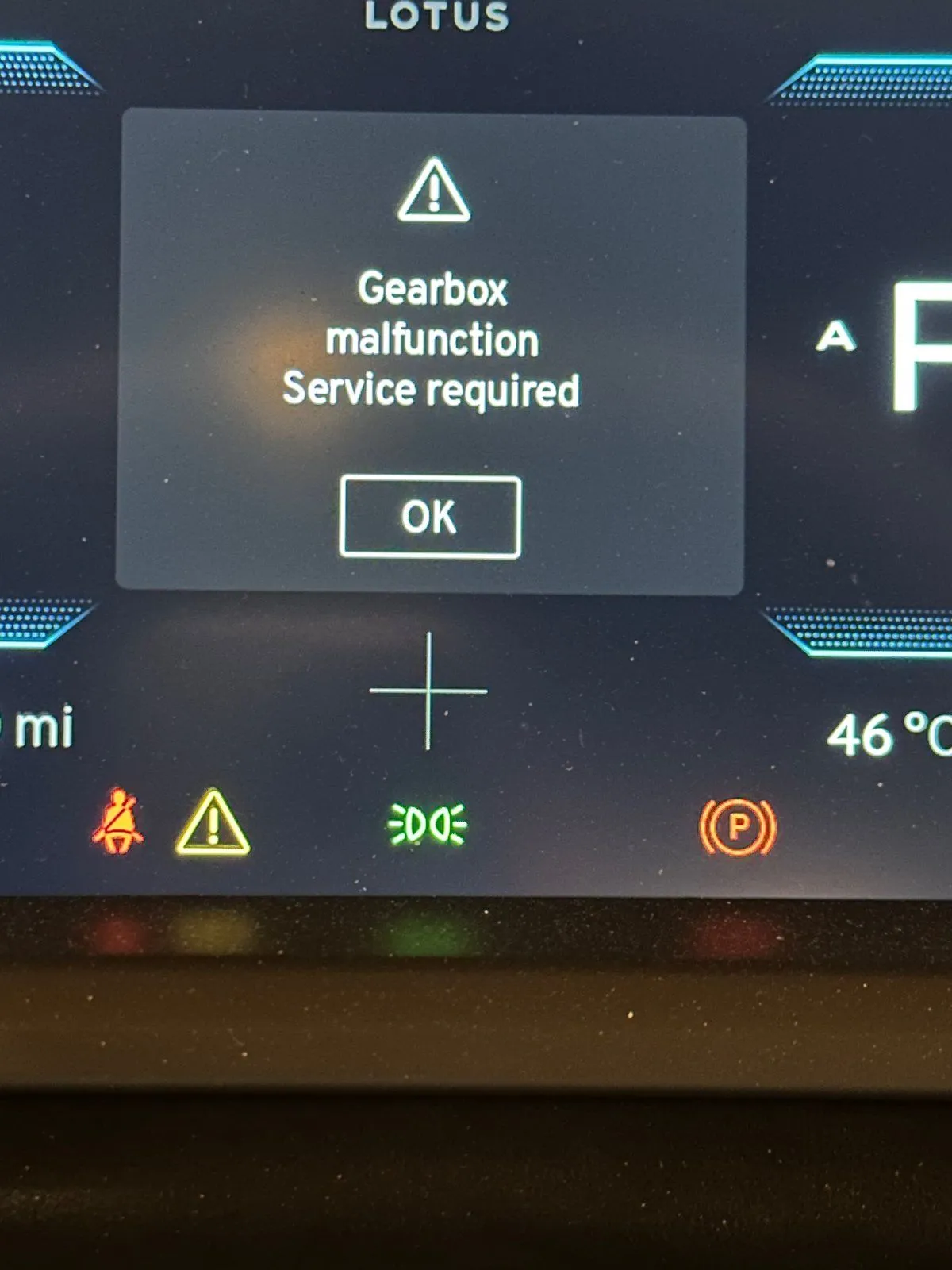

Codes were...
P0700 Transmission Control System - suspect as it juddered to a halt in 2nd gear (Auto)
P0627 Fuel Pump A Control Circuit/Open
P0087 P0087 Fuel Rail/System Pressure- Too Low Bank 1
So running out of fuel and juddering to a halt in gear caused the above. A random code/fail on my mates old discovery caused untold seemingly unrelated codes.
