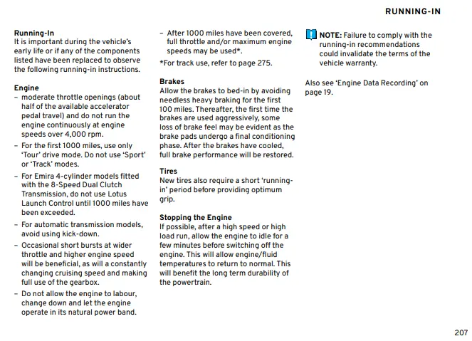

I just got my i4 and was not given a paper owner's manual, nor advised by my dealer about the proper break-in procedure. I did some digging on Lotus' site and found this in the owner's manual so wanted to share here. The CYA they included about 'downloading engine data' seems a bit odd. Also, note that we are not supposed to use any mode other than 'tour' for the 1st 1000 miles. This is going to be the longest 1000 miles in my life. :)
You aren't supposed to run it continuously above 4k rpm for the first 1,000 miles. You can moderately rev it above that now and then. Just don't start flooring it until the engine and trans has broken in

I just keep it under 1/2 throttle and let the engine does whatever it want. It will rev over 4K when accelerating but long as it doesn't run at over 4K constantly, you're fine.
Good information. I dont have the actual manual. Does it give any guidance on Track mode once you have hit break in?

It was definitely a painful 1000miles keeping it low rpm and tour mode ... I was so excited when I was crossing over 1000 that I wanted to video tape the cross over and let 'er rip. I forgot to hit start :-)
As per Lotus corporate, there is no run in procedure - this is what my dealer told me about a year ago. I pretty much did what is above anyway though, and oil at 2.5 and 5K miles.

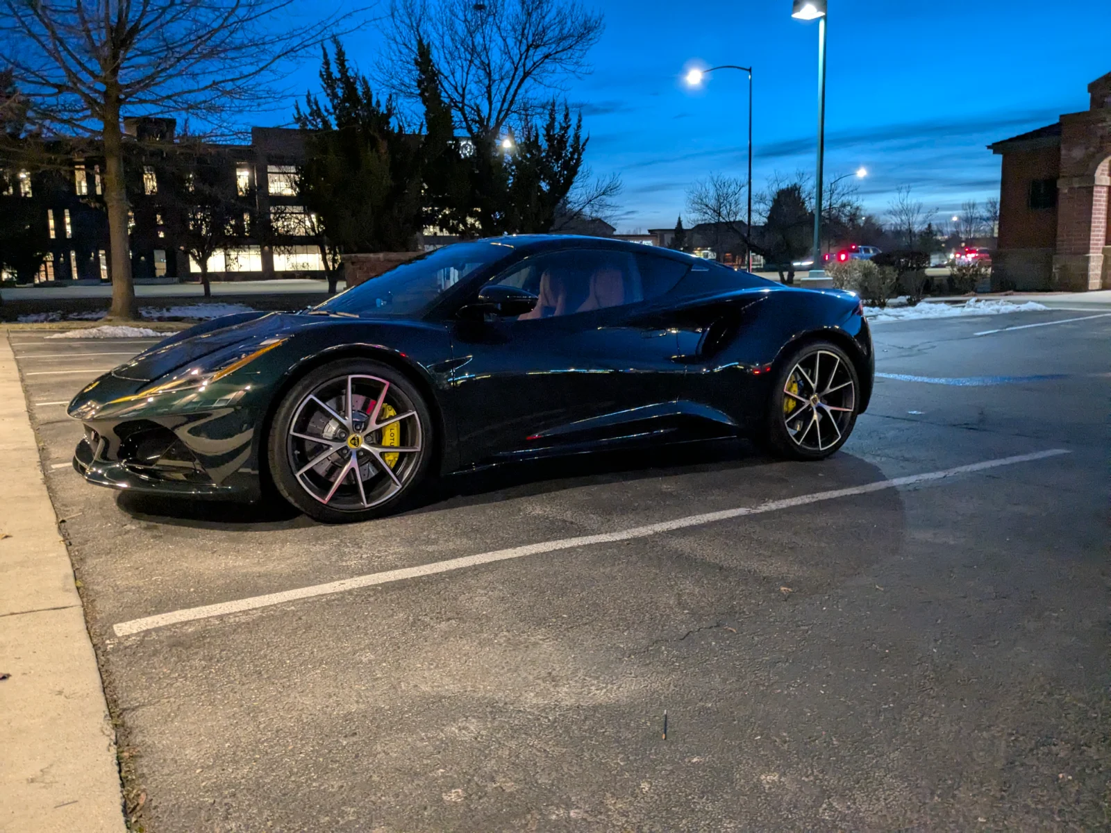

Went out a couple evenings ago and took the wife to dinner. Luckily they don't salt in Idaho, but you can see the snow in the background. This thing is so much fun to drive I just can't go more than a day or two without missing it. :)
