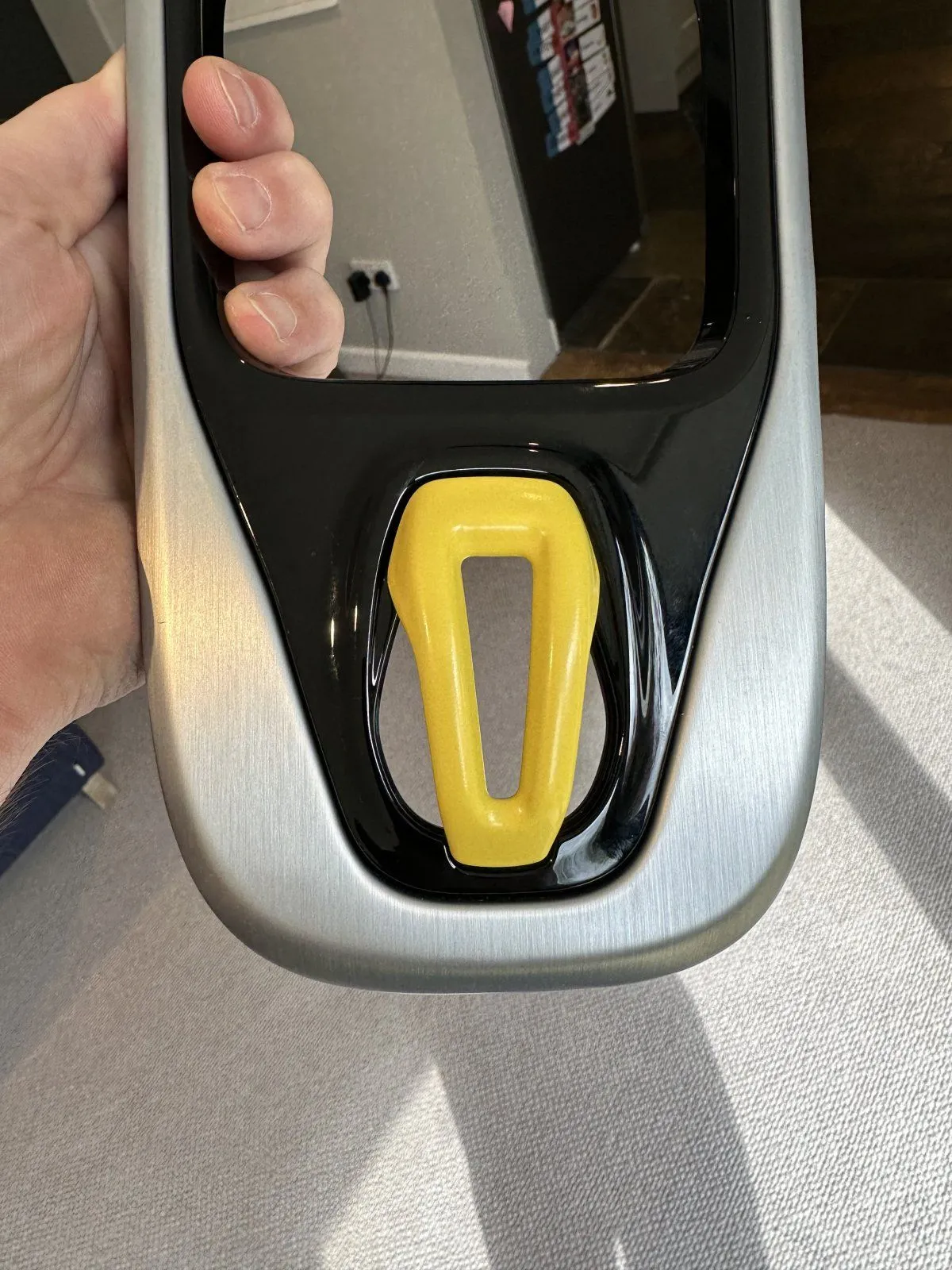

I’ve never liked the red starter switch cover. Esp on a Seneca car with black alcantara interior and yellow brake callipers.
If I had a red car or red callipers it makes sense but red doesn’t work for my car…

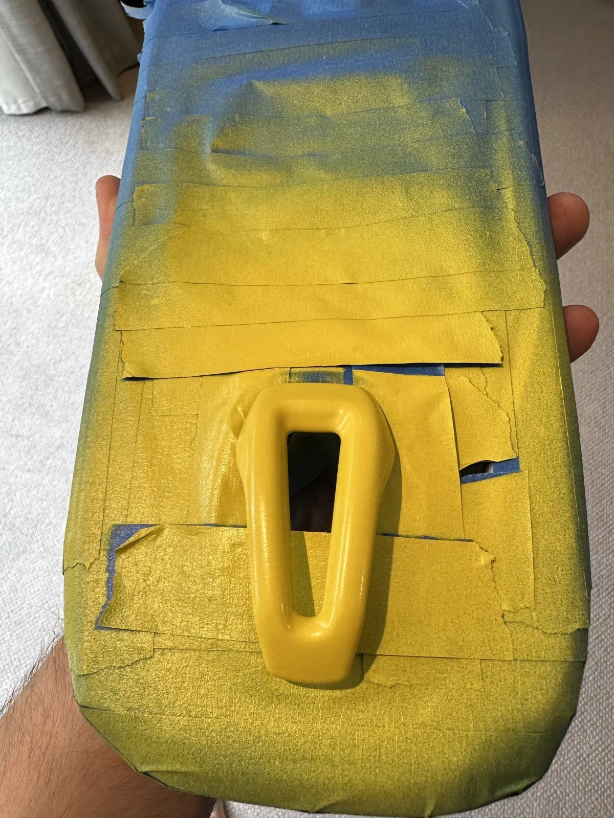

I wanted to take it off to paint / stain / powder coat it but sadly it’s plastic welded (melted) into place.
So whilst having the gear gaiter replaced I took the opportunity to paint it…
I’m not 100% sure I’ve got the colour right but I think it looks much better. (I’ll put it back on the car once the gaiter returns.
For reference the yellow paint code i used is LY1C which the dealer said was the brake caliper colour code… It’s an Audi colour.
I haven’t put a clear coat on top of it yet as I think like the satin finish but I may still clear coat it.
Not sure if I should have used Lotus LO7 yellow instead…

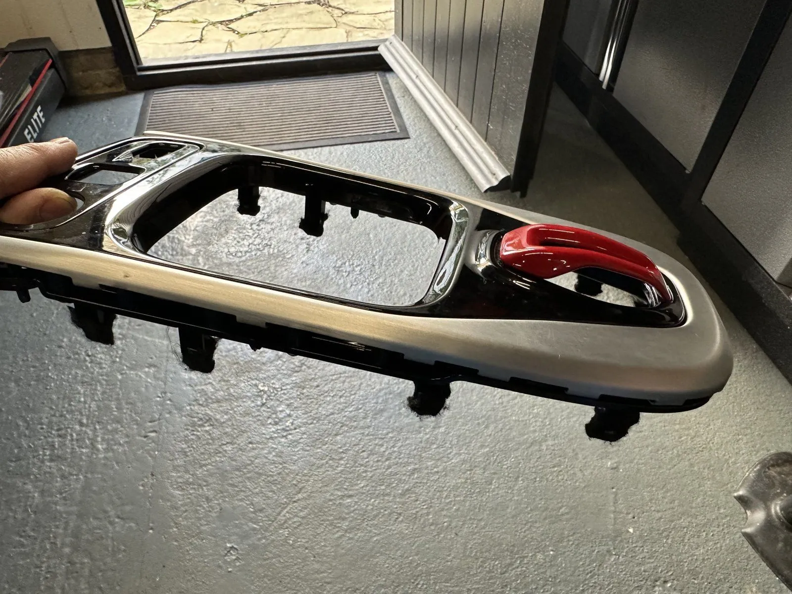

It wasn’t the easiest but with the whole lots comes off ok. It took a little prying up with some wide trim removal tools. I started at the front on the car and worked backwards.
If you do it be careful not to dent the aluminium trim.

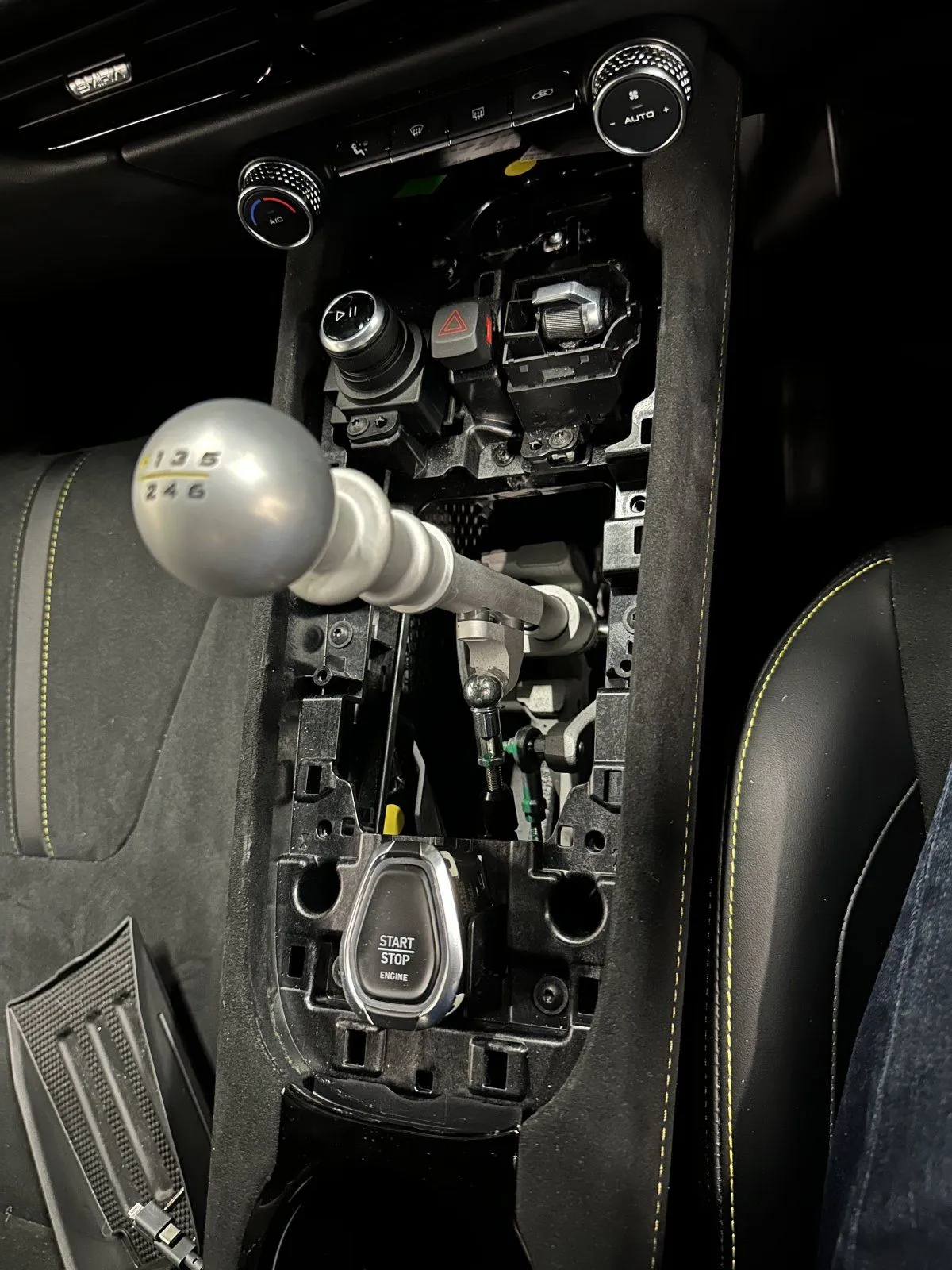

Gotcha! Let me know if you can snap a pic of it at some point, assuming you don't have it all back together already.
The reason I ask, is that I'm going to try to find a local custom trim shop to make an "inverse" gaiter for me, that goes down into the structure instead of up to the shift knob. I want to open up the shift linkage fully to view, but hide the unsightly bits around the sides.

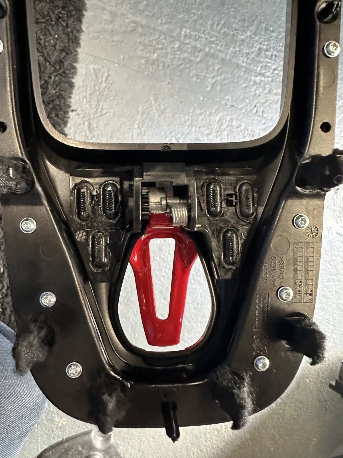

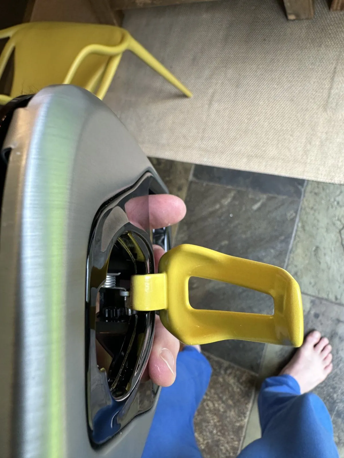

There’s a little hidden mechanism that controls the descent of the switch.
It’s heat welded / melted into place and you can’t really get to it.
The spring could be removed but I’m not sure if that would stop it decending, make it just flap about or mean it always stays up even when you shut it!
