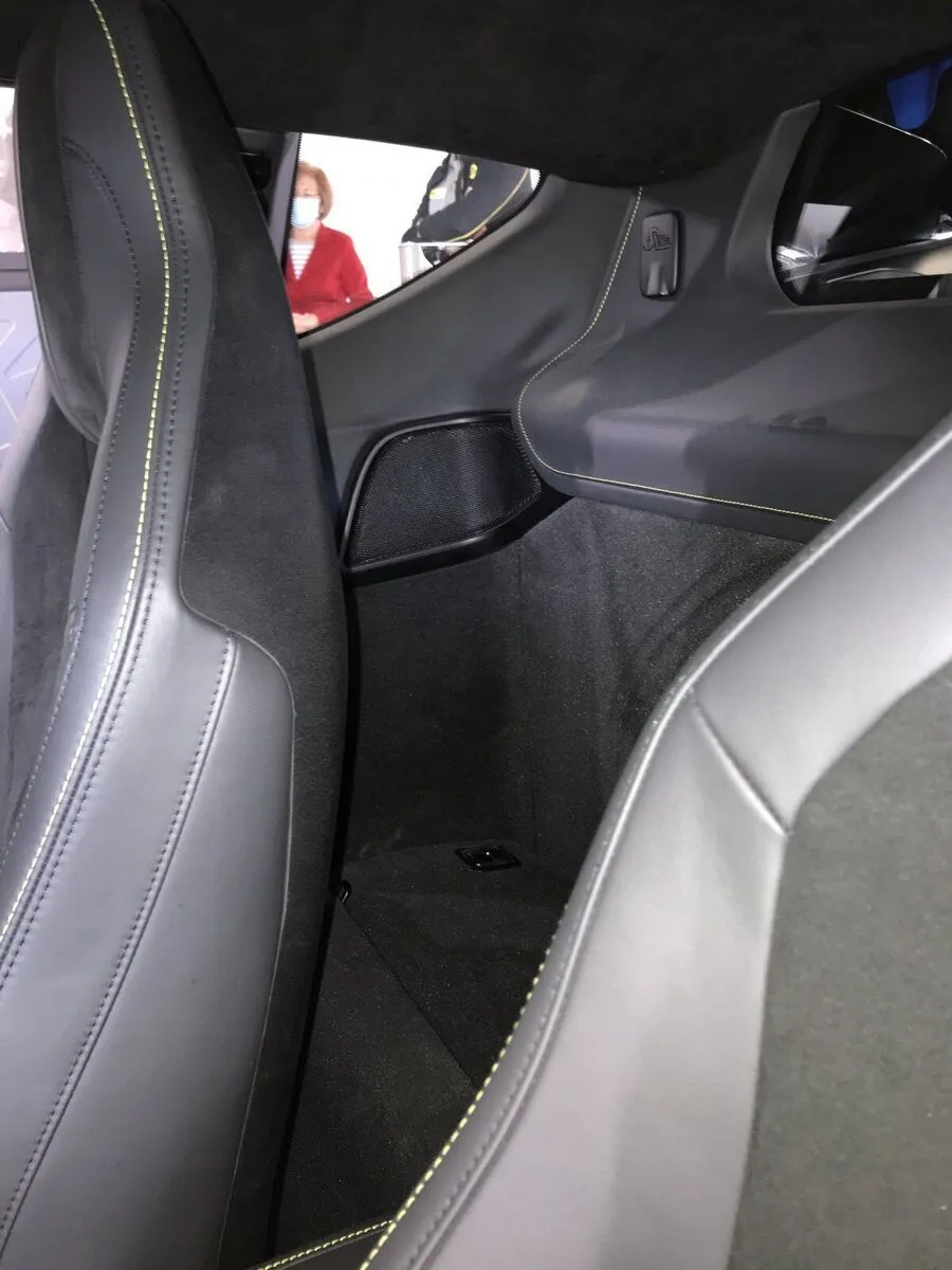

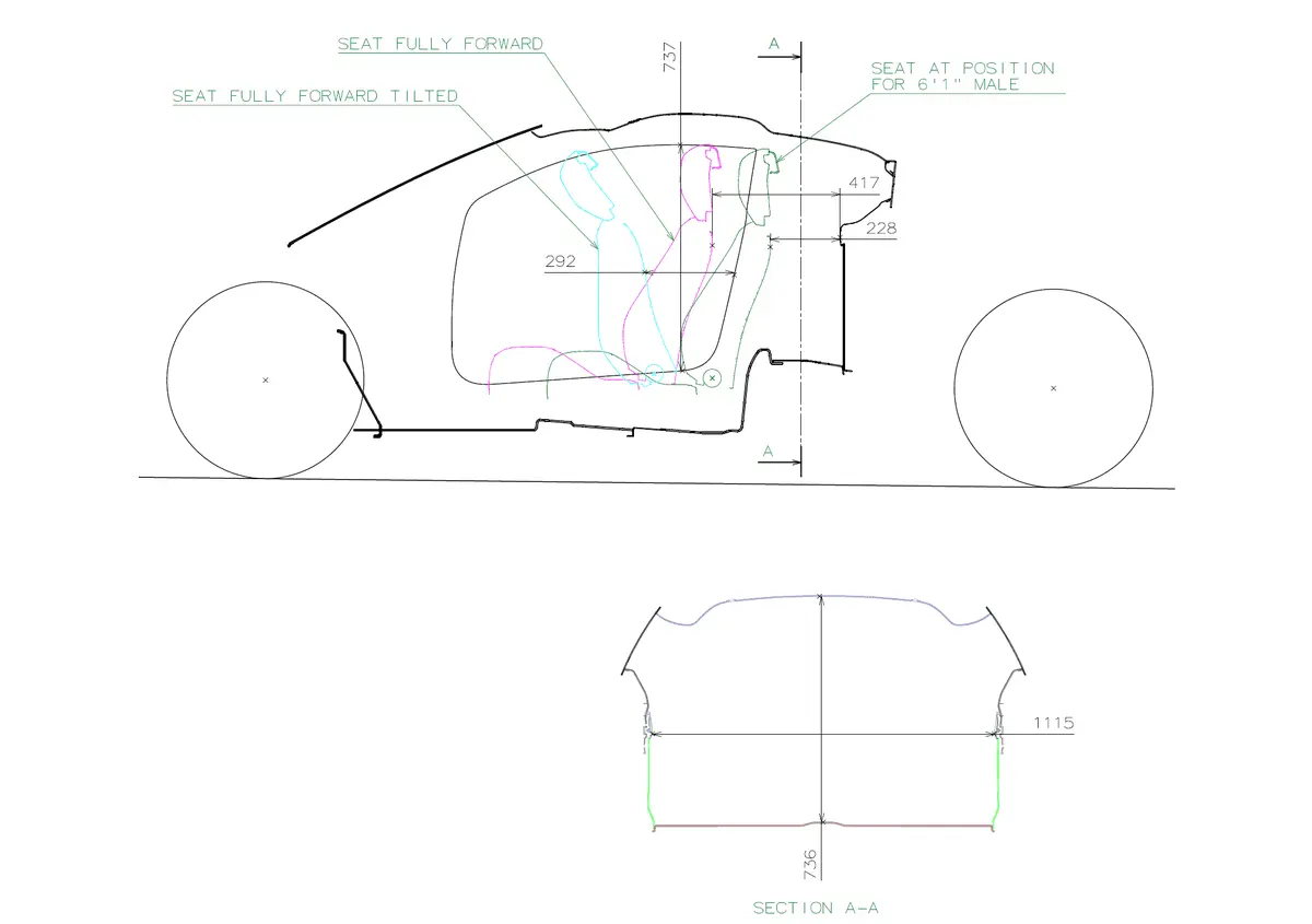

There's not enough space and there are no suitable anchor points. Compared to the Evora the bulkhead has moved forward to create more engine bay space. With the seat fully forward you'll get just over 40cm of space and for me at 5'9" it's about 30cm.

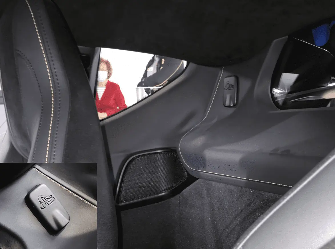

You can use a child seat in the front passenger seat location. There is even an anchor in the rear side structure for the top tether anchor, so it's an intended pattern of use.

I think only if there is a passenger airbag defeat switch.
I mean, the anchor itself has the regulatory markings for a child seat. That's the LATCH system symbol. US equivalent to ISOFIX.
I can't imagine a scenario where they would go to the engineering expense to provide for child seat anchoring and also design the airbag system without appropriate accommodations.

Although there seem to be Isofix anchors, the engine firewall in the emira has been moved forward (~20cm) towards the driver to make way for the i4 engine and have a bit more service room for the V6.
So I don't really see any opportunity to fit a baby seat there as there might be ~50cm of room behind the seats which won't nearly be enough.

The maximum space in the rear with the seats fully forward is only 42cm. The curve of the back of the seat might give you a little more space lower down, but I don't think it's feasible.
You've got no rear seat belts and only a LATCH anchor, which is designed for the tether for a baby seat in the front. There are some tie-down points but they're not ISOFIX, so there's no certified way to fit a rear baby seat.
