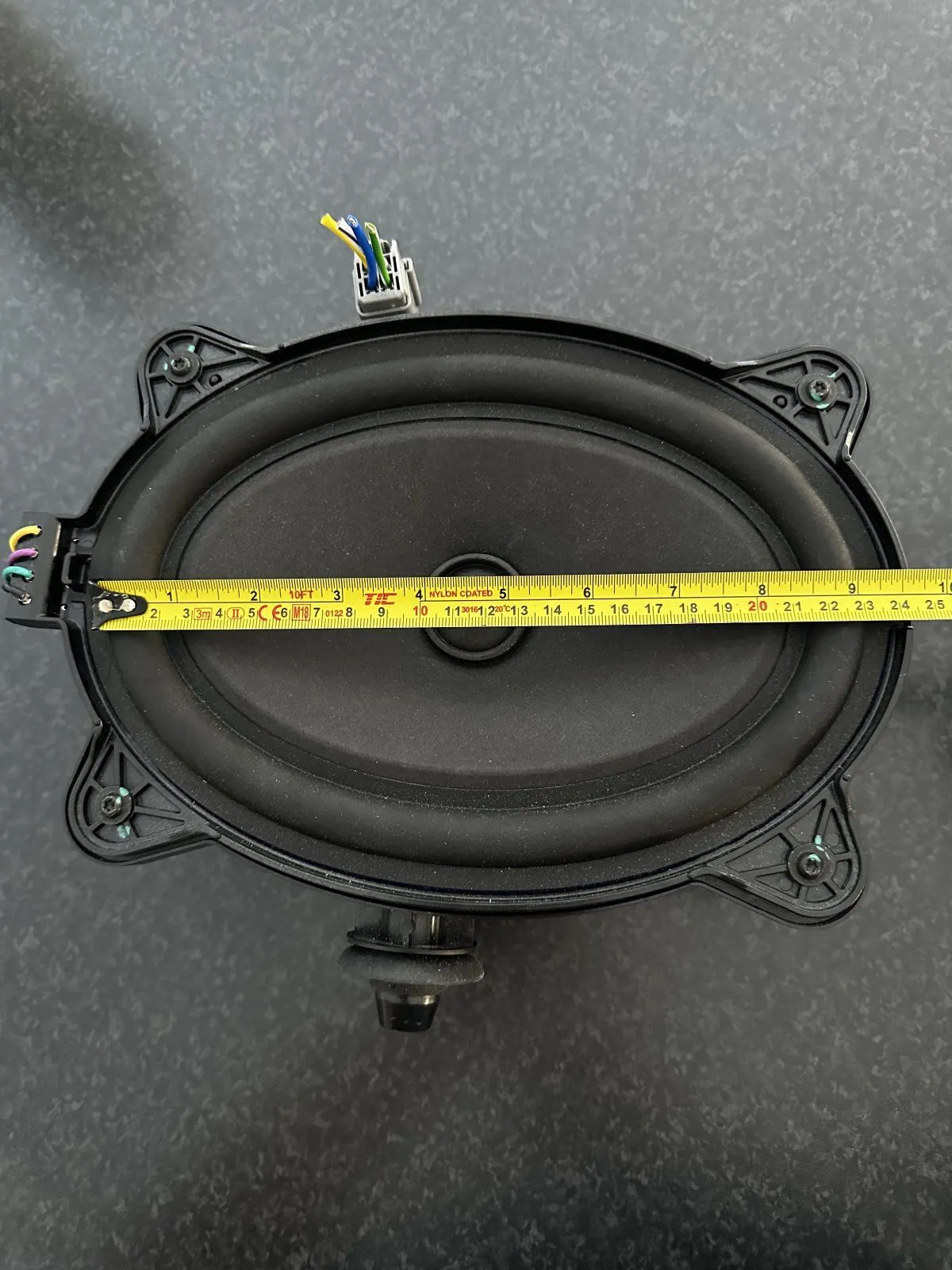

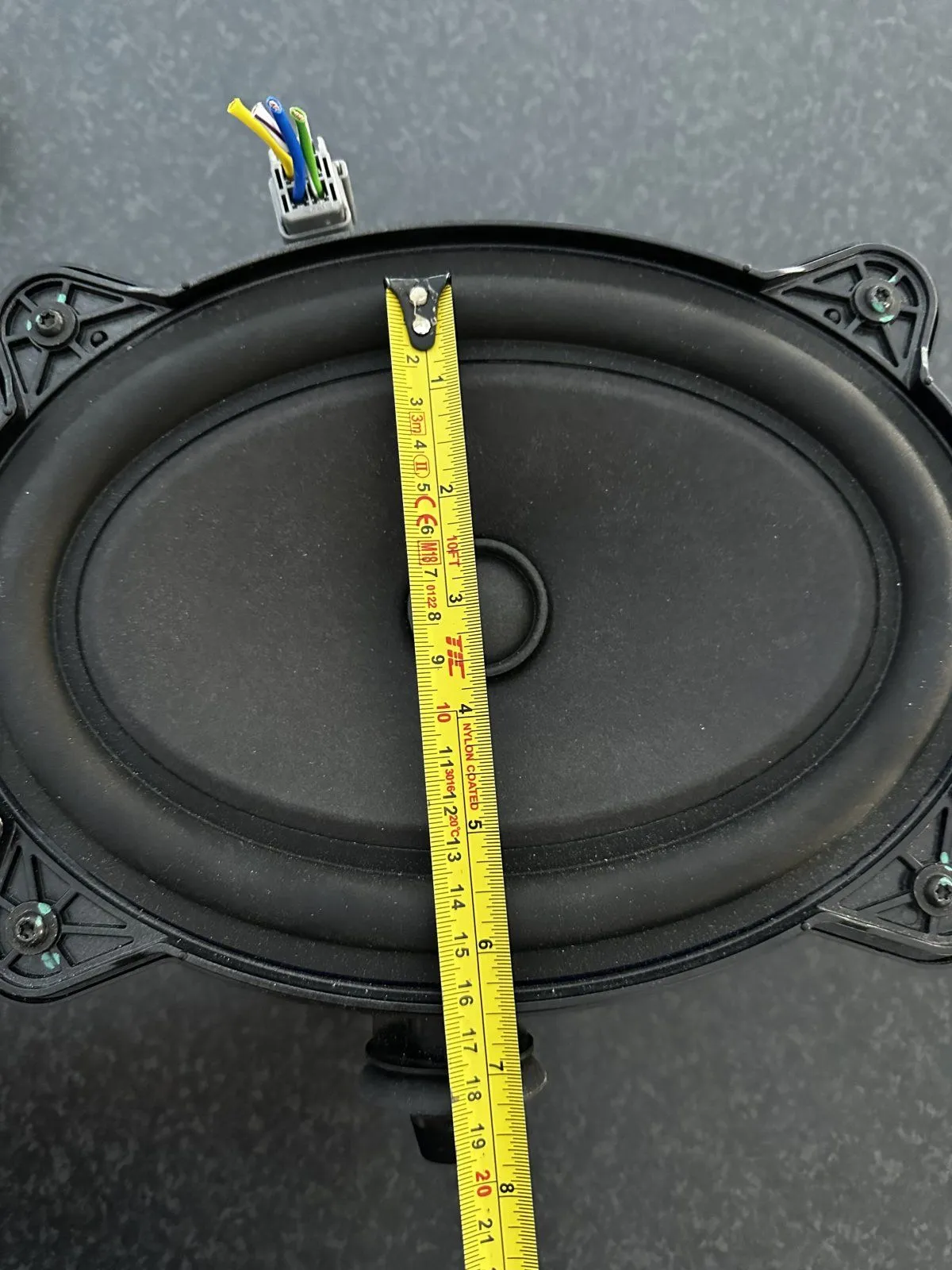

I was reading this thread and thought I would shed some light on the OEM subwoofer we all have installed. I'll try my best to be PC:-
Take a look at the pictures attached. This is my sub that I've removed due to all the same reasons you are all describing - sorry, but I found the KEF audio poor & not up to standard....it certainly does not match the looks of the car, so I upgraded everything and now its awesome!
If you hear a "thud" when you open the door in the mornings - it's this sub doing that. I've not heard this sound after its removal.
To answer another query above - Yes, the two OEM amplifiers in the car always remain Live, the car doesn't go to sleep like other manufactures, in fact the majority of the equipment within the car remains live.....This was discovered when I was looking for a switched ignition feed during my audio upgrade.
Here's some other info about the sub I've mentioned in other threads you may find useful :-

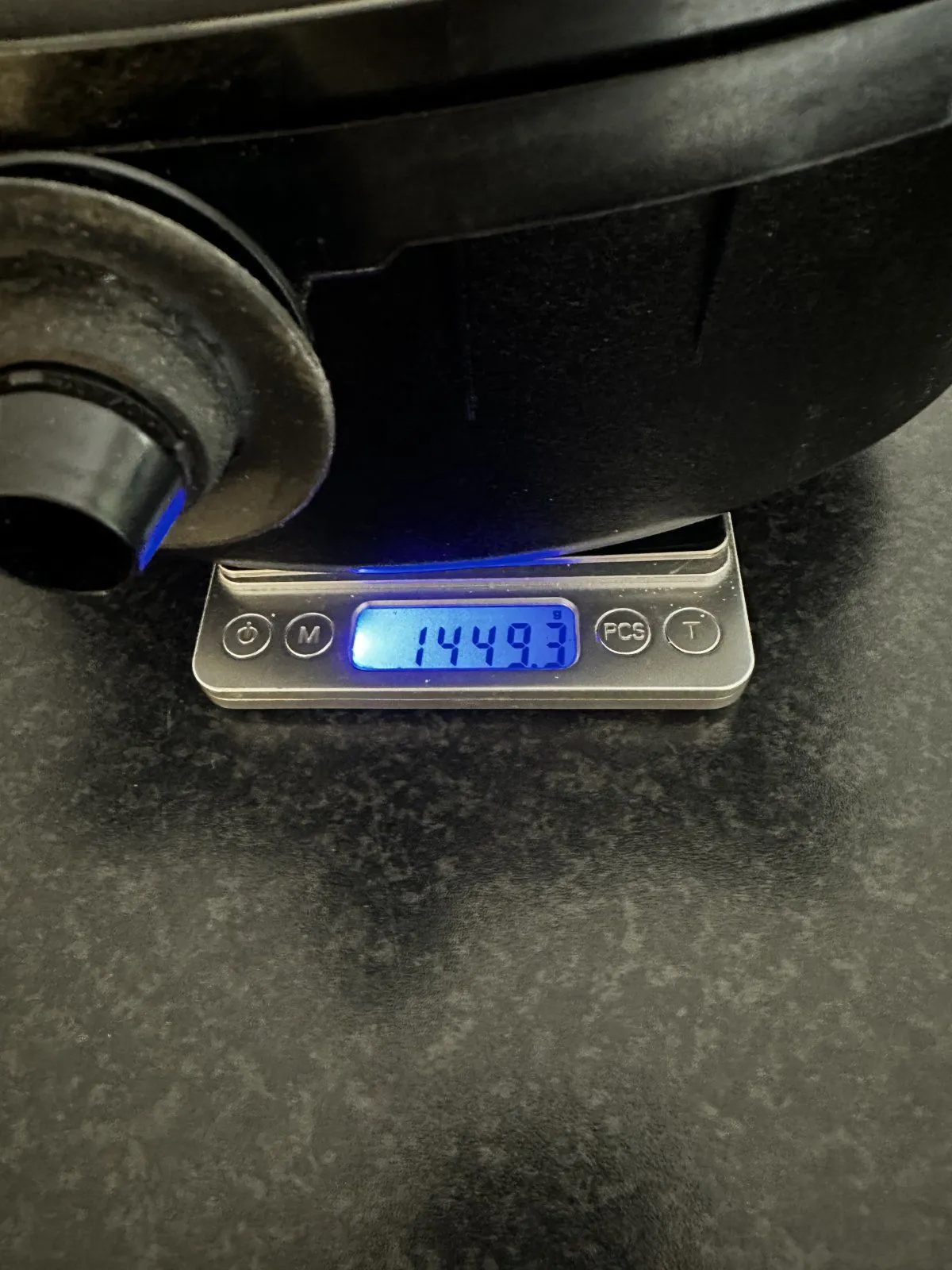

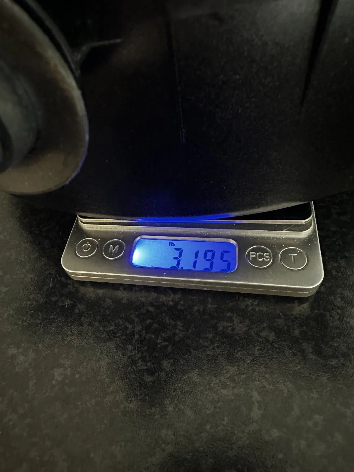

The sub measurements basically make it a 6X9 speaker which only produces bass. It weighs in at just 1.45kg or 3.2lbs....
For comparison, one of the 6.5" speakers I have now installed to my doors weighs the same.

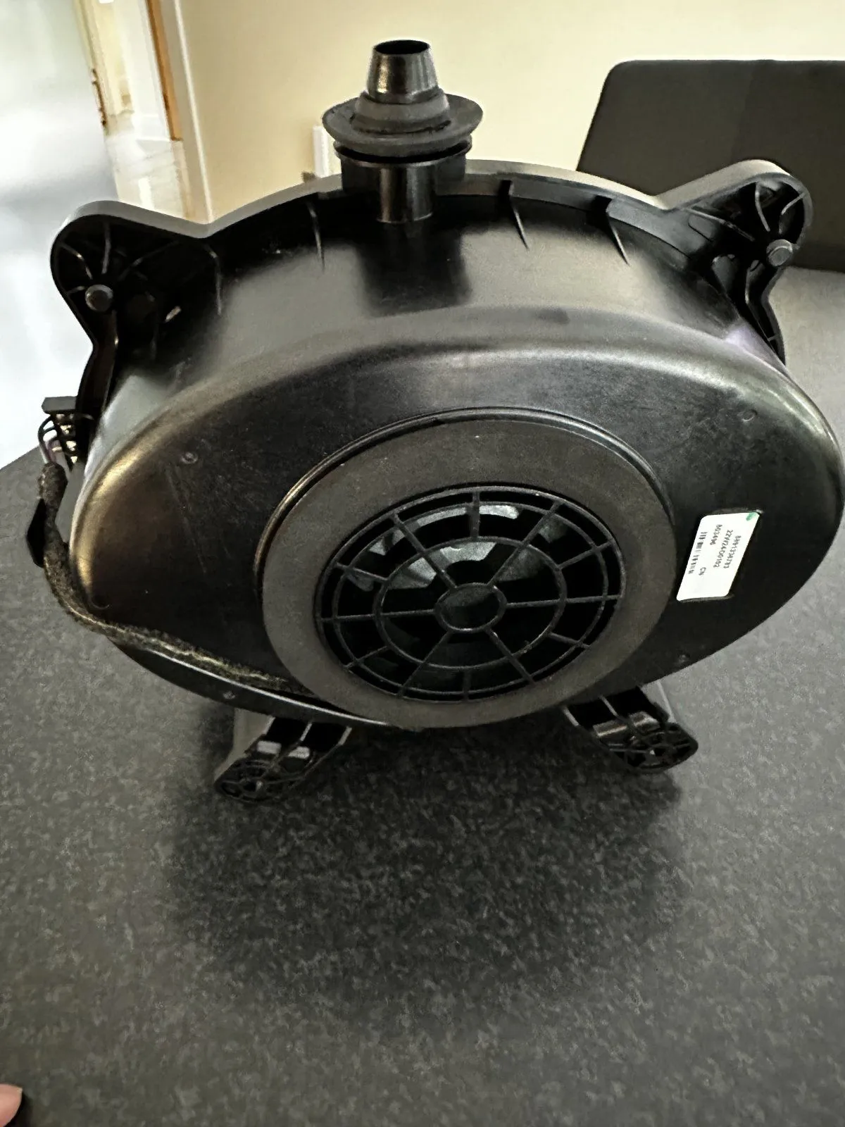

I've personally not come across Its "free-to-air" design before, nor would I recommend one - this is why the sound / bass changes when you have a window open or closed.
Lastly, when I removed my sub I found it had water inside due to the free-to-air design. Pic 5 shows the drain hole which faces down when the sub is installed in the car - have you ever known a sub / speaker to require a drain hole??
