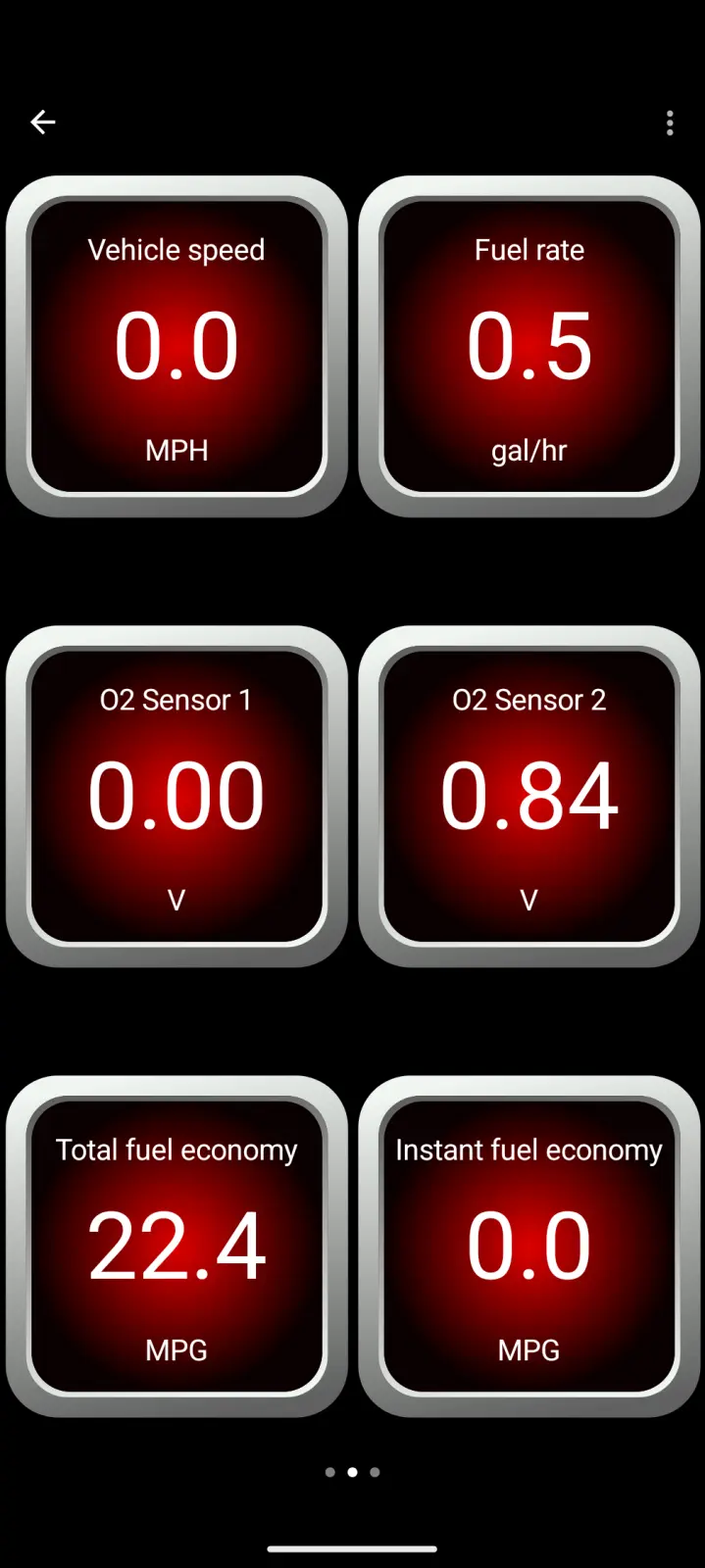

What do you mean by that? It idles smoothly. And after warmup it settles at .5
On the other hand why does O2 Sensor 1 read 0.0?

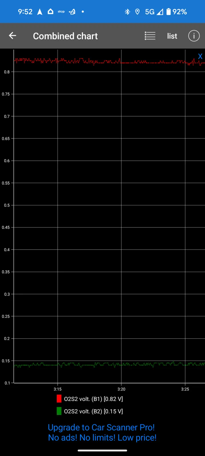

Try „CarScanner" from the AppStore.
Go to Live Data -> Combined -> Deselect all (top right button), search for O2 Voltage and enable both. Press OK to plot a graph.
Zoom out a little. Let the car idle, AirCon off. Don’t touch the gas. Let the car run 5 minutes or something before. About one minute should be enough on the screenshot.Post Screenshot :)
This doesn't look normal.

Could be a bad O2 sensor or harness. They use voltage to measure mixture. Low voltage is interpreted as a lean condition.
It could also be a vacuum leak, injectors or fuel pressure, but we already know our O2 sensors are finicky so I’d lean towards that.
