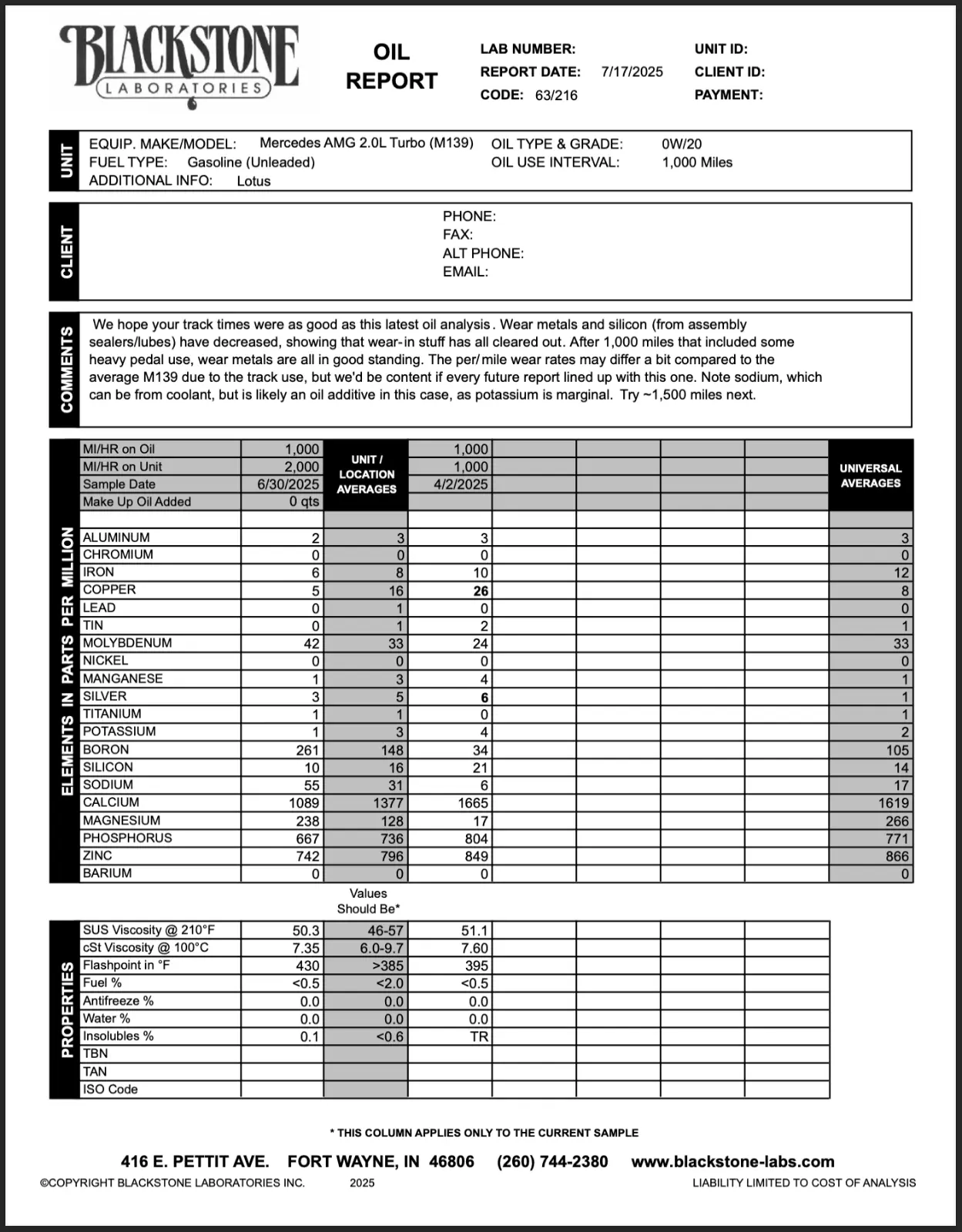

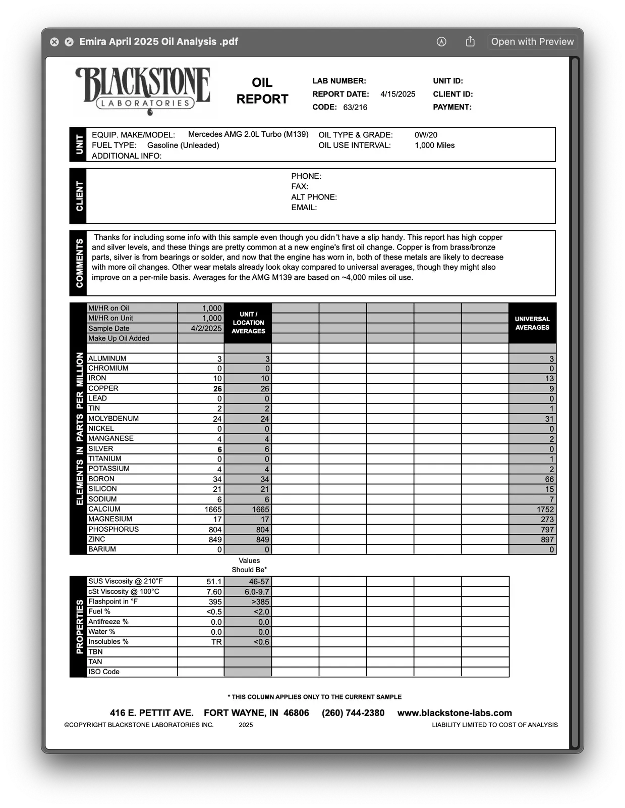

How's 0w20 holding up on track? Has anyone experienced oil burning or sent off their oil for analysis after 1 or more events?
Related, has anyone gone up in viscosity, what did you move to and how's it been?
Sharing my break-in oil change analysis.
Will follow-up when I have a second one.
