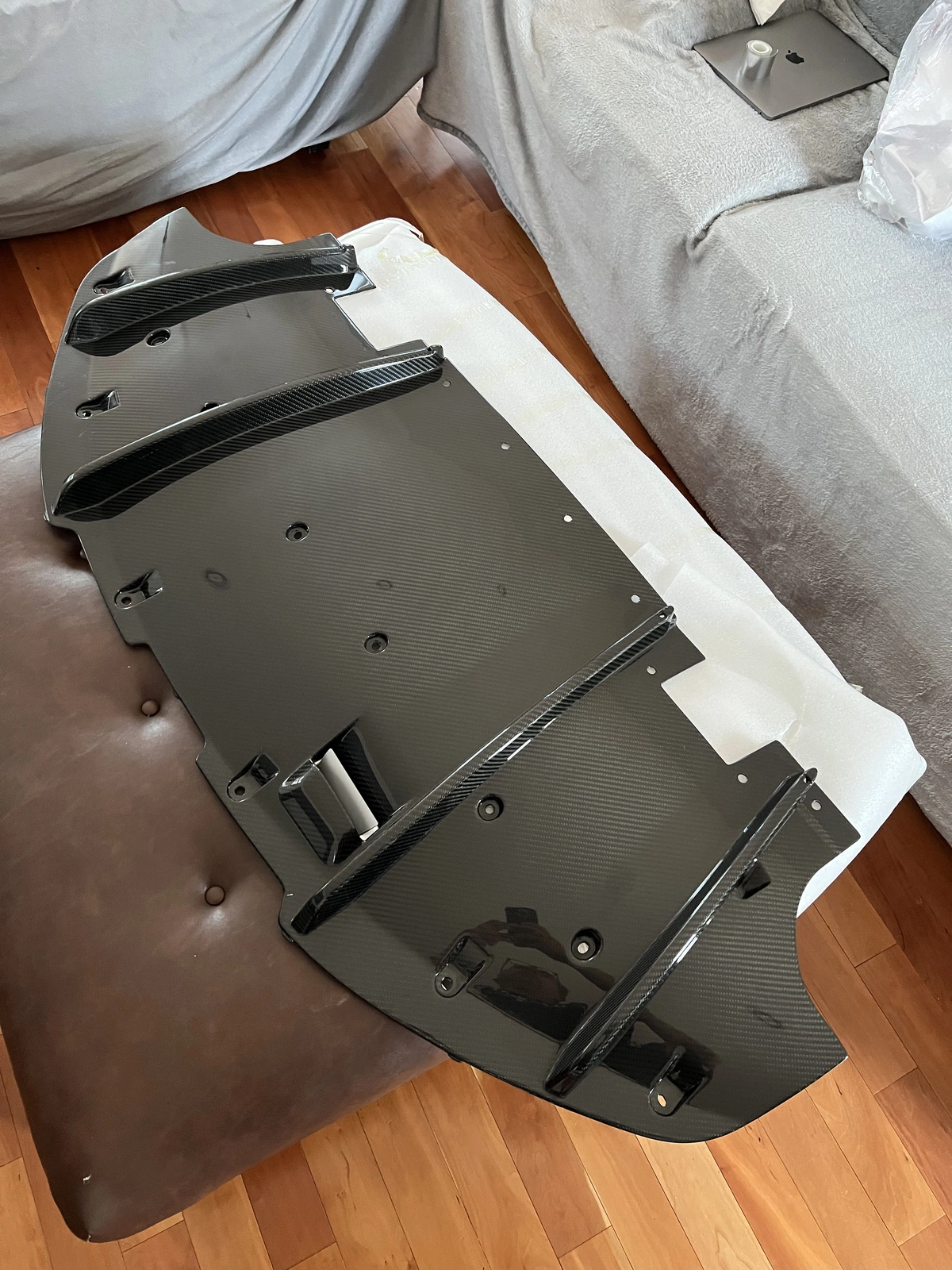

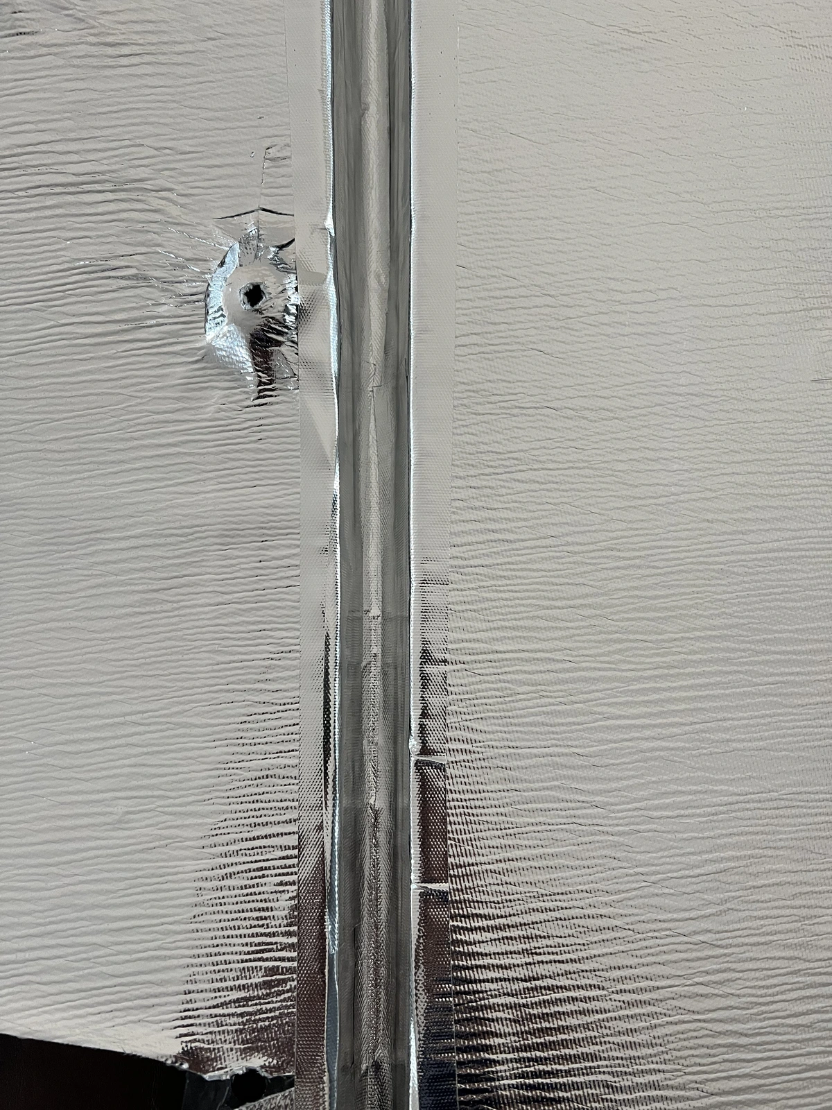

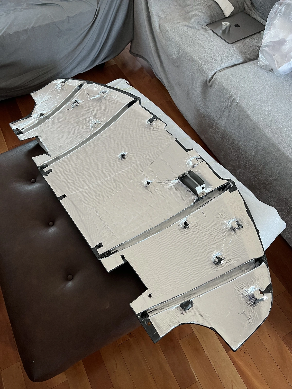

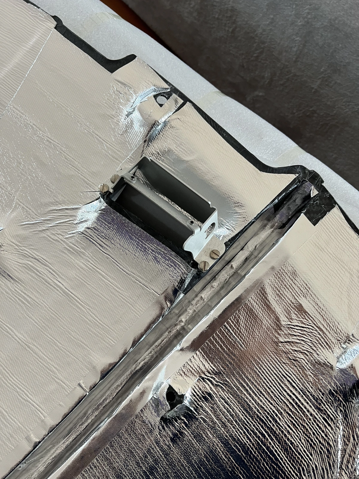

So, I recently had to replace my diffuser (won't get into why, still a sore spot). I also went with GRP's CF version (Lotus had no OE versions stateside and said a month which likely meant double that) and it is indeed a beautiful, functional and lighter piece. However, I noticed in the install video, they didn't heat shield it. Given, I melted the other one and the fact that the OE version is heat shielded, I did this:
Personally, I would not risk having dry carbon exposed to the the exhaust heat sans any protection. I just used some heat shielding material from Amazon and about 1.5 hours of detail work. Here are a few more pics...
