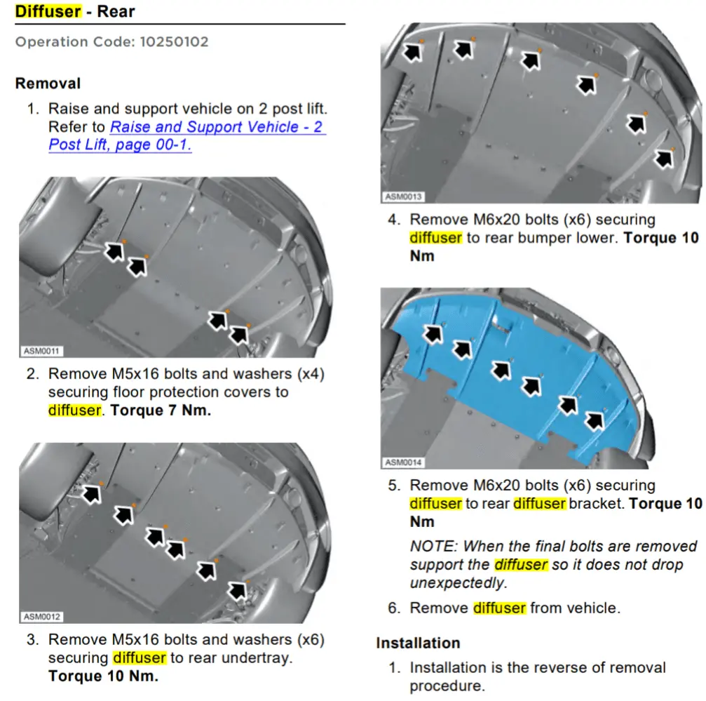

They are easy to swap, just three bolts accessed from the backside with the diffuser removed.
Can you remove them by just removing the lower diffuser? They look like it may be quite a fiddle, unless you also remove the rear bumper/diffuser surround that they're attached to?
I haven't actually tried yet myself
Jon
Need to remove the diffuser as noted above and then the muffler to get them out.

Ah ok, that makes sense, I thought you meant you could fiddle them out without removing the muffler or upper diffuser.

I assume they're simply bolted to the diffuser grill from the inside and not physically attached to the exhaust pipes? I'm curious because I have a carbon diffuser coming and will probably have to swap them over when I install it. I despise cheap gloss plastic on cars and will likely eventually replace all the piano black trim with matte carbon or something similar over time.
Conversely, I seem to be in the minority and strongly prefer the satin finished exhaust finishers. They contrast much better with the dark rear end and give it more of a modern industrial look (think Carrera GT). Black just makes them disappear and polished chrome belongs only on hotrods or Harley's IMO.
I assume they're simply bolted to the diffuser grille from the inside and not physically attached to the exhaust pipes?
Correct.
Thanks for the manual shots. I have actually already had the lower diffuser & engine undertray off, when I did the first lube service @ 1300 miles, just wasn't sure if it was possible to wiggle the exhaust tips out around the upper diffuser panel and actual exhaust tubes, as I didn't try when I had it apart. Makes sense now to drop the silencer/muffler.

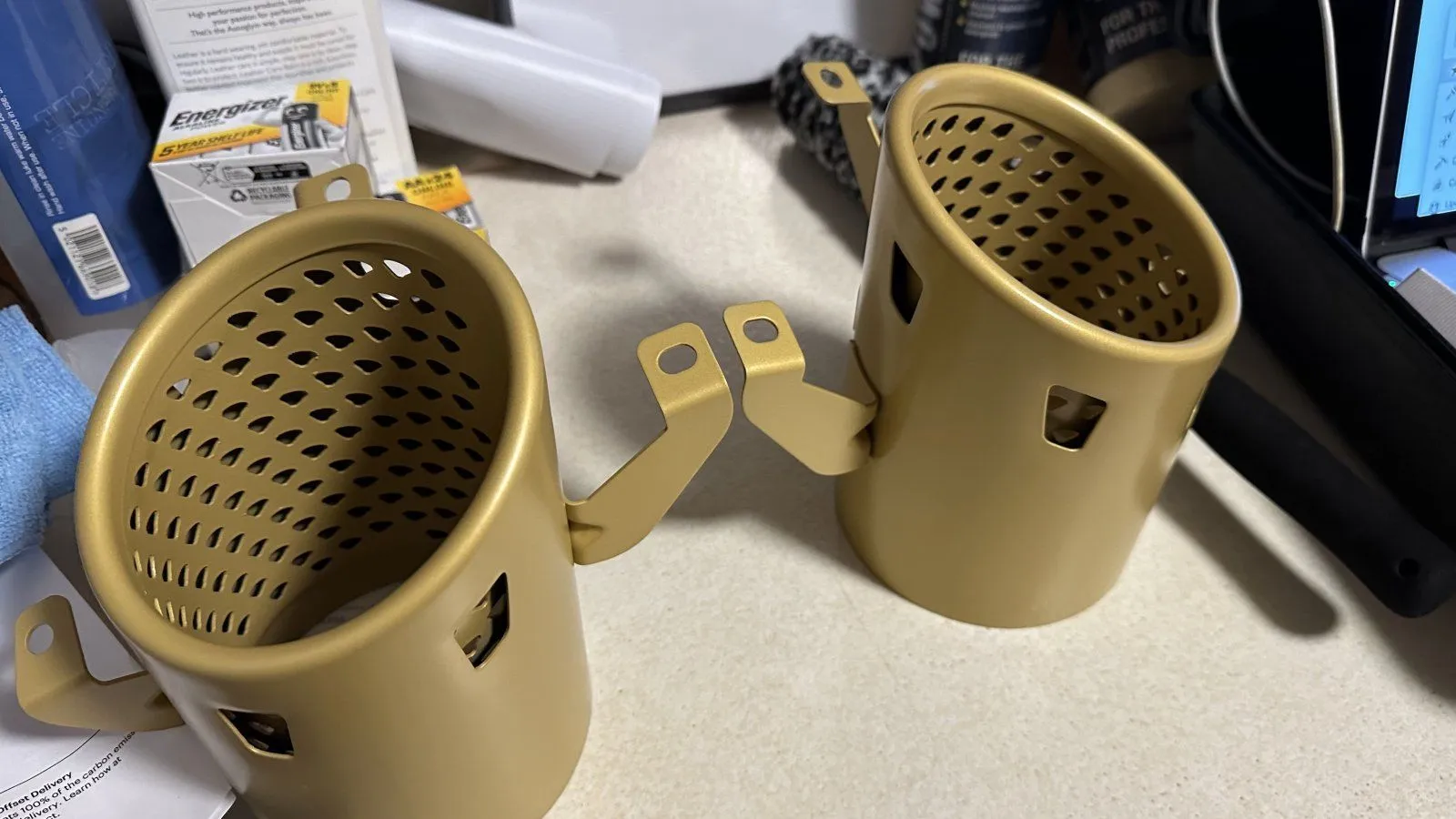

You had these powder coated in gold to match your "JPS" detailing?
(y) Actually Cerakote, glacier gold, (Glacier range is good for 1000 deg C / 1830 F)
But yes.

Thanks for the confirmation the muffler needs to be dropped to replace the tips. Was looking for info as it looked like that may be the case and I just ordered a set of these, and BAM, the info I needed was posted today!

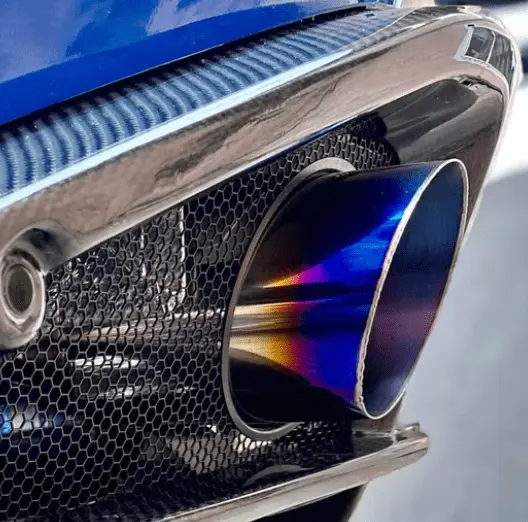

Those are gorgeous! Where'd you get them?
It's a pic from this add isn't it?
It is indeed.. but they don't sell those.
@Aerie
I am getting the full exhaust setup from Aerie and replace the stock silver tips ... otherwise I would have have to do something satin like T2F stated.
