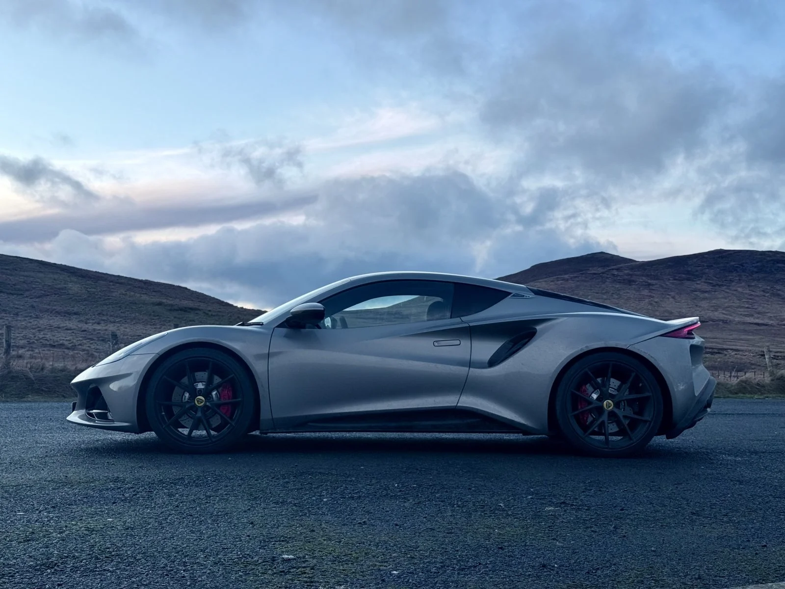

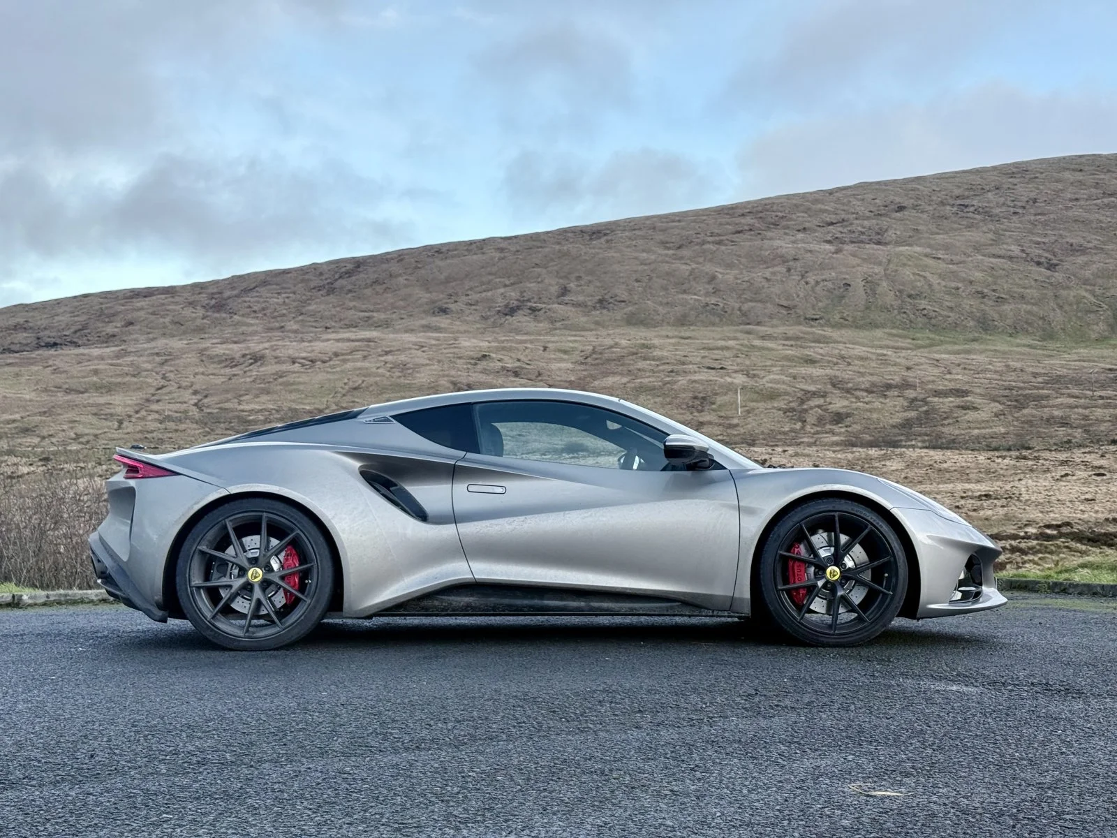

I lowered by around 15mm all round. Slightly lower at the front end by a couple of mm to give better turn in and response. Car looks lower at the back if you look at the arches but when measuring from the ride height points underneath, it has a very slight rake over standard.
