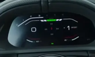

Hi, I hope someone can help me. I've had a European i4 (366 hp/269 kW) for a month and it has 2000 km on the clock. When I wash the car with pressure water, the headlights fog up on the inside. I've tried to do a launch control and the green light doesn't appear as shown in the image. Has anyone else had the same problem?

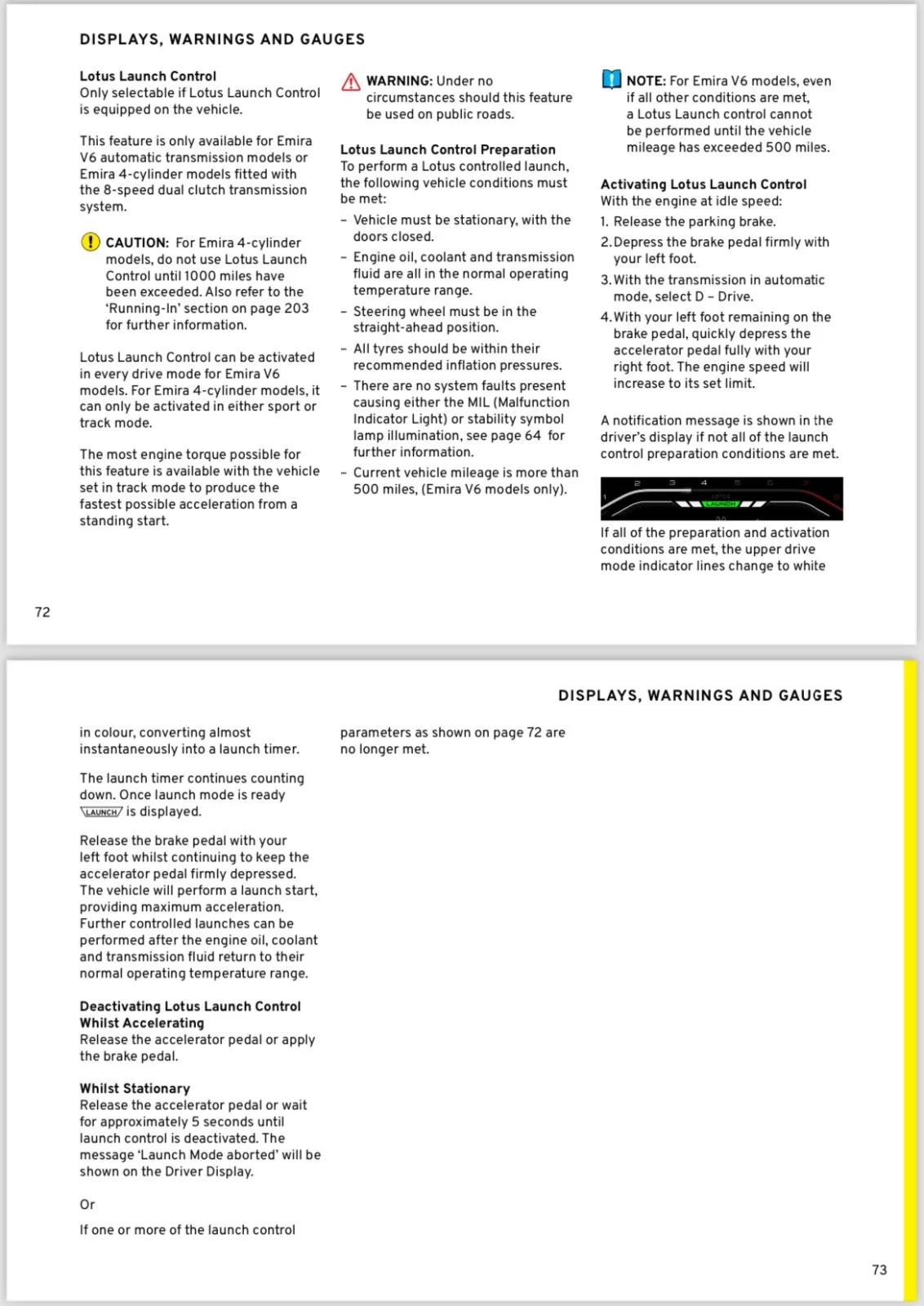

The steering wheel has to be fully straight ahead, the brake needs to be pressed quite firmly and engine has to be fully warmed up. However, it doesn’t always work on my I4, but does most of the time. The conditions to enter LC are listed in the online manual.
The LC does work pretty well.
Which drive mode are you in, I could be wrong but I think it only works in sport and track.
Here’s the section from the manual. The straight ahead steering wheel caught me out, I thought it wasn’t working. Even just slightly off of straight ahead and Launch will not activate.
