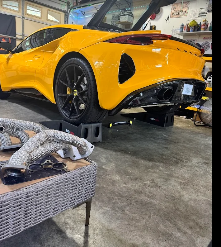

Yes, Headers, 3rd cat delete and Valve controller. I also contacted JUBU and Terry at JB4 for a tune. I'm the complete opposite as most of the folks on here probably, this isn't a garage queen and I live on a farm with no neighbors within 2 miles. I can show you guys (see link), we run go karts on an asphalt track on my property, it's very remote and noise is not a concern.
Alright, well, the car sounds absolutely fucking insane. I have no idea why more people haven't done this upgrade. So I have headers (took me 3 hours to install, let me know if you want a video of it, I took plenty of clips with my gopro) 3rd cat delete was 30 minutes and the valve controller was about 10-15 Minutes. Shout out to GRP for replacing the valve controller I received that was defective (Threw a code at around 6000 rpm, wouldn't properly open the valve, drove me crazy).

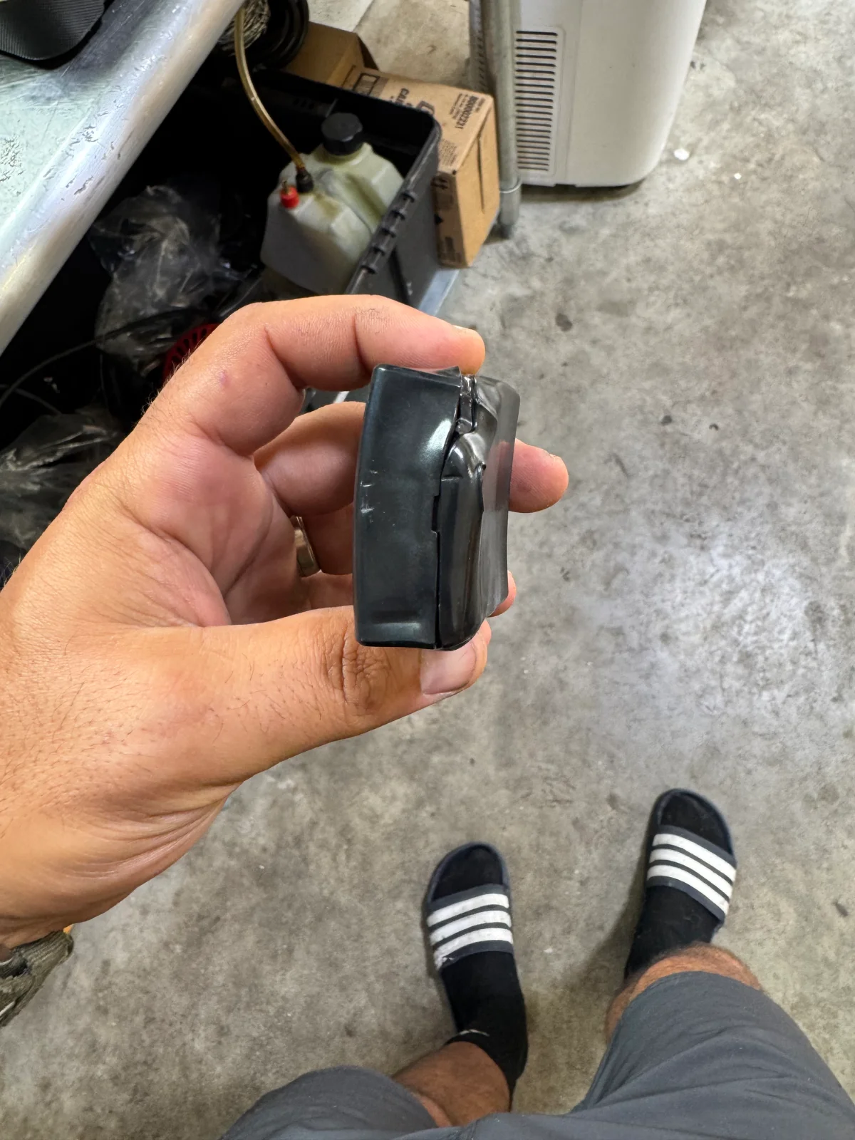

No, honestly I just ignore it and once every other gas fill, I pull the codes, I keep an obd2 in the car, if I see something I don’t like, like when the valve controller melted, then I worry.

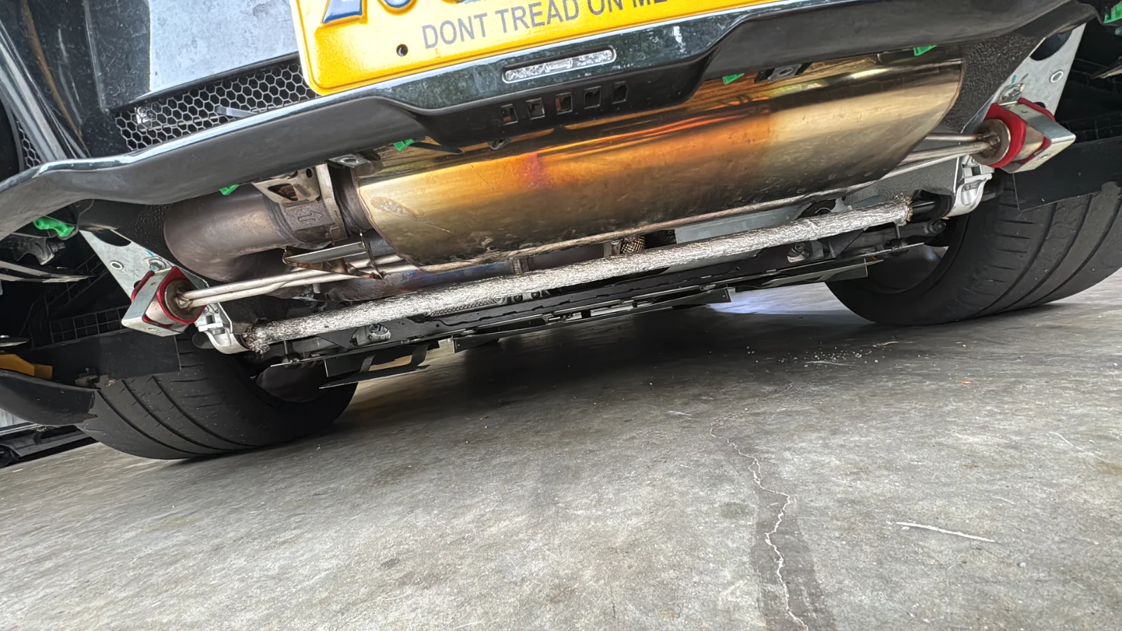

Deleted booth, melted controller and deleted rear diffuser for better heat dissipation

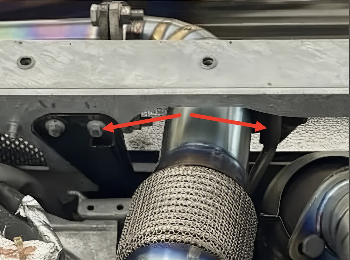

Since you don't have the diffuser on, can you tell me how much space there is in the cutout of the frame where the y-pipe goes through? Two more things... what is the diameter of the header pipes coming from the engine, or the two smaller ends of the y-pipe, and what is the bracket connected to that the y-pipe bolts to? I've worked out a layout for a true dual-exhaust that would work with either the factory exhaust manifolds or the shorty headers like you have, but the critical element is fitting it through that cutout.
Appreciate the help!
The headers are the ones from grp. I paid 699 for them or something like that when I bought the car. Don’t build a custom exhaust, use the stock mufflers they are pretty much free flow. Trust me. The J pipe (3rd cat) is like 199$ online, any unit will work, china garbage or expensive 3rd party with a nice label on it, it’s all the same considering it’s just a hollow tube taking out the cat
I have the delete and a titanium exhaust, but the bottleneck in the system is the y-pipe. I have a true dual setup designed with X crossover section, but I haven't been able to find out what the diameter of the smaller tubes of the y-pipe is, and what that bracket it bolts to is bolted to itself. I don't want to have to jack the car up, remove the panels just to see/measure that, if somebody who already has access can help me out. Please please please?? If you still have the factory exhaust manifolds, just a quick measure of the pipe diameter that's coming out of the exhaust port will do.
Is the bracket the y-pipe's bolted to, the piece where the red arrows point to? Is that all one piece?
