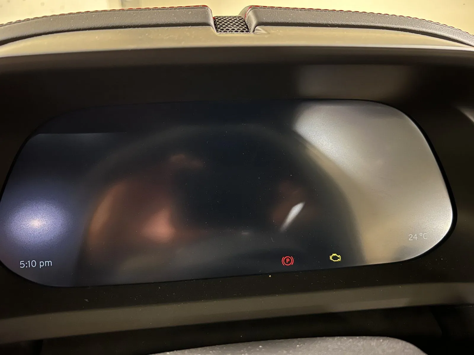

The trip was going super good … until bang ‼️engine management light and power restricted mode … sad times 😢
I am on the phone to breakdown - called the UK number they transferred to the AA Europe… lotus have no contract with the AA france apparently so they have been calling “Arc breakdown” who are not answering 🙈.

Sorry to hear that. This may be a granny and sucking eggs comment but have you tried the lock up and come back in 20 mins approach? Seems to clear spurious issues sometimes.
Hmmm post a beverage and still waiting thought I’d go turn the car on and as if by magic the light is gone !! This is normal though as typically the DTC has to fire in order to trip the light.
I’m supposed to have a 1000km drive tomorrow… not sure I should be chancing it. Last time this happened to me the turbo on my 1 year old discovery went (last month) so probably not a great idea to be driving it as it will be ok until it needed power.
Find the nearest shop with an OBD scanner, it'll tell what's up.

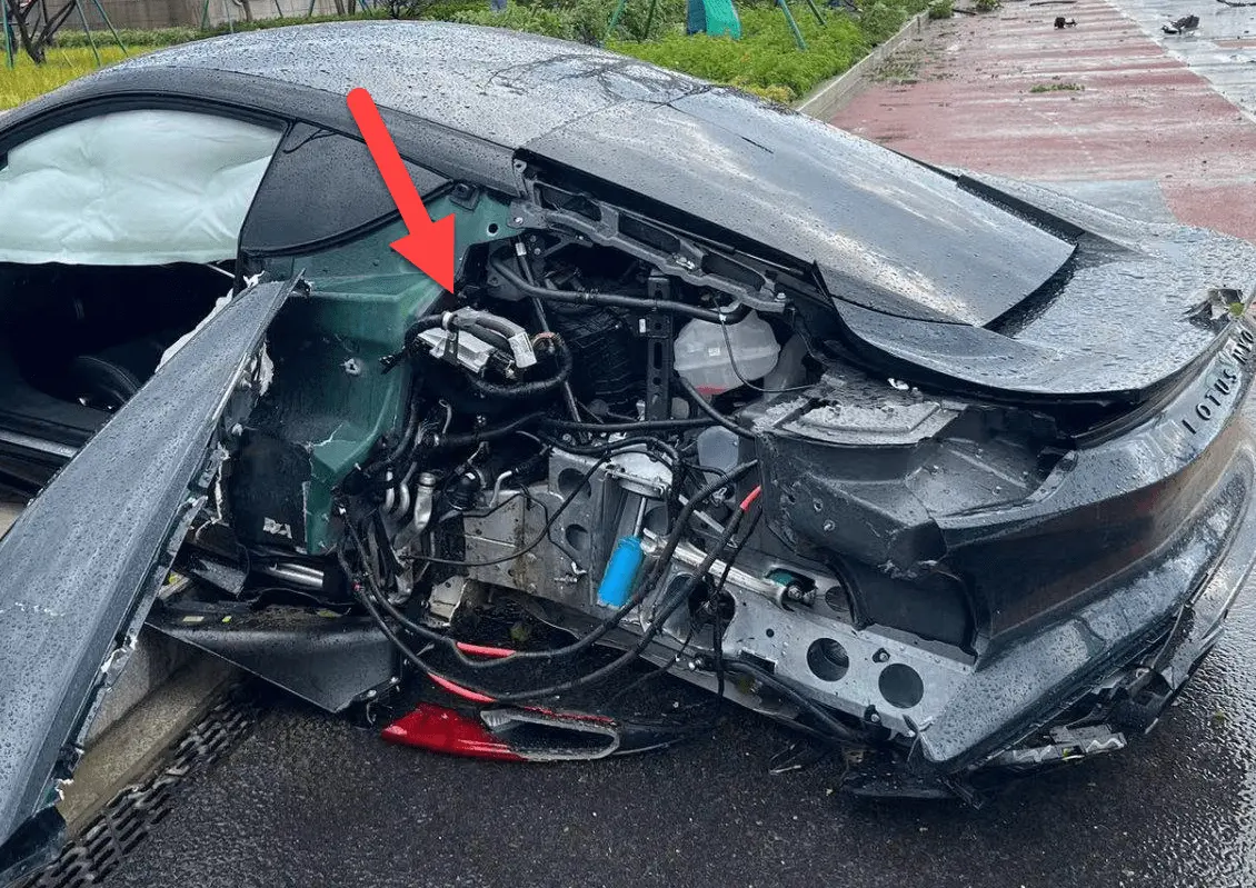

Anybody have a picture of the engine compartment that shows where the ECU is located? Do the ECU's have a heat sink on them?
I believe it's thereabouts
FYI that's the ECM (Engine Control Module). There's also the CEM (Central Electronic Module) which is sort of the main computer and handles the OBD interface. That unit is larger and located behind the passenger footrest inside the cabin.
Exactly how bad did that ECU overheat?
