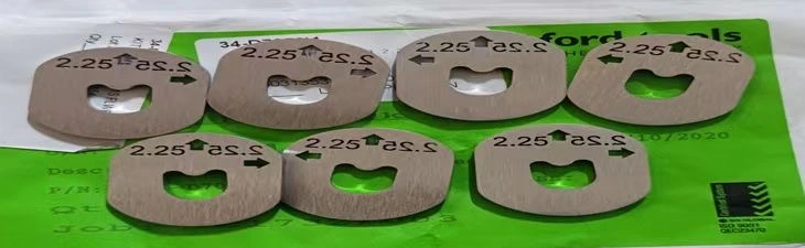

The Macau team had mentioned a set of eccentric shims for allowing it up to 2.25 for camber but they aren’t available for purchase for retail customers.

I found these camber shims however from the notes, the camber slots have to be machined to install these. I wonder if that's the same for the Macau team's solution.
I'd like to see if aftermarket eccentric shims are a possibility before going to control arms.

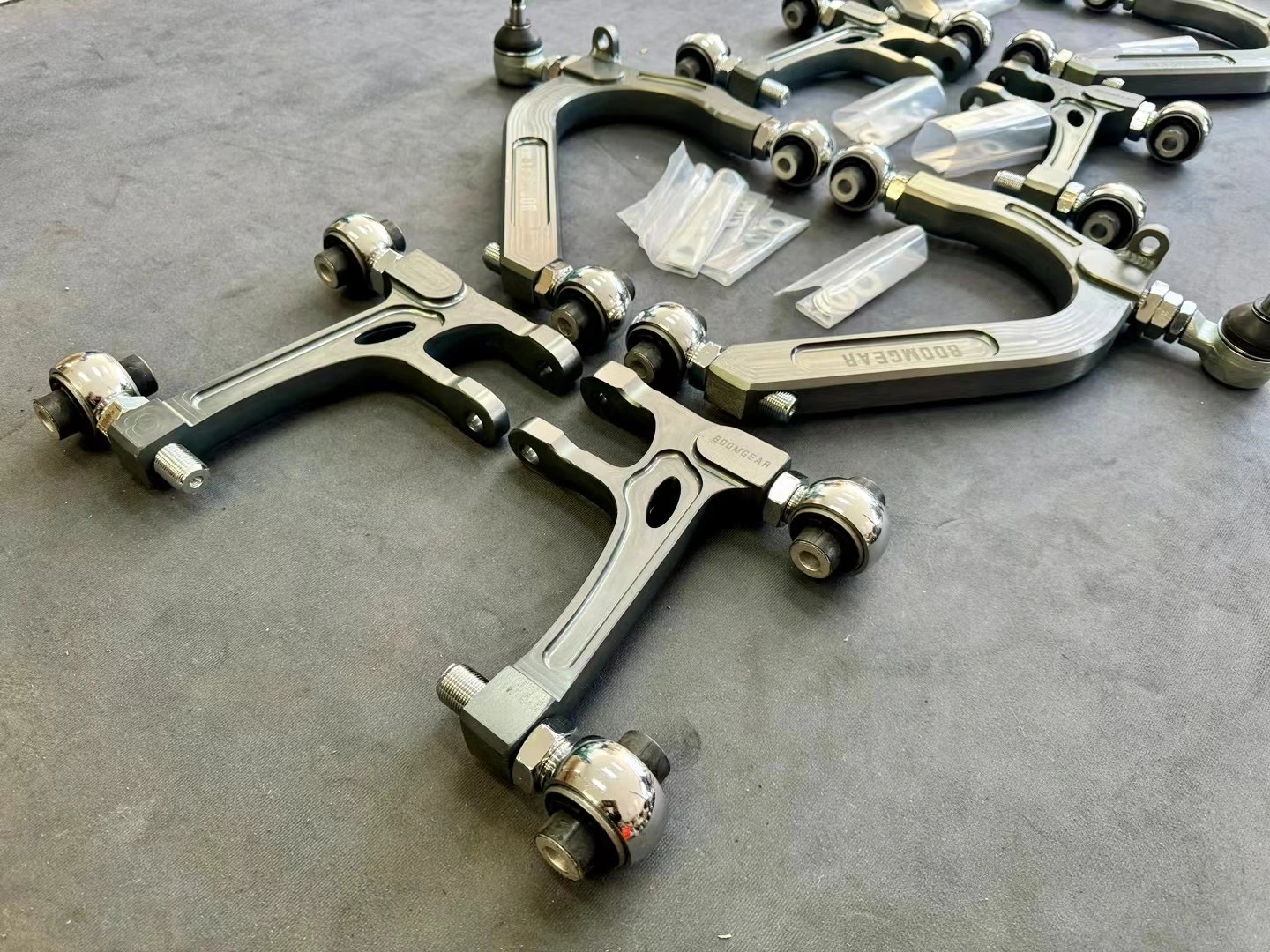

I'd like to see aftermarket aluminum control arms with the adjustment capabilities for the Emira.
I think there are already many aftermarket control arm options in the Chinese market. Just not available in the US yet.

Pretty much all the essential aftermarket parts are available in China except ecu mod, the only problem is not many vendors are interested in dealing international buyers.
Yup all the essential upgrade parts are available.
