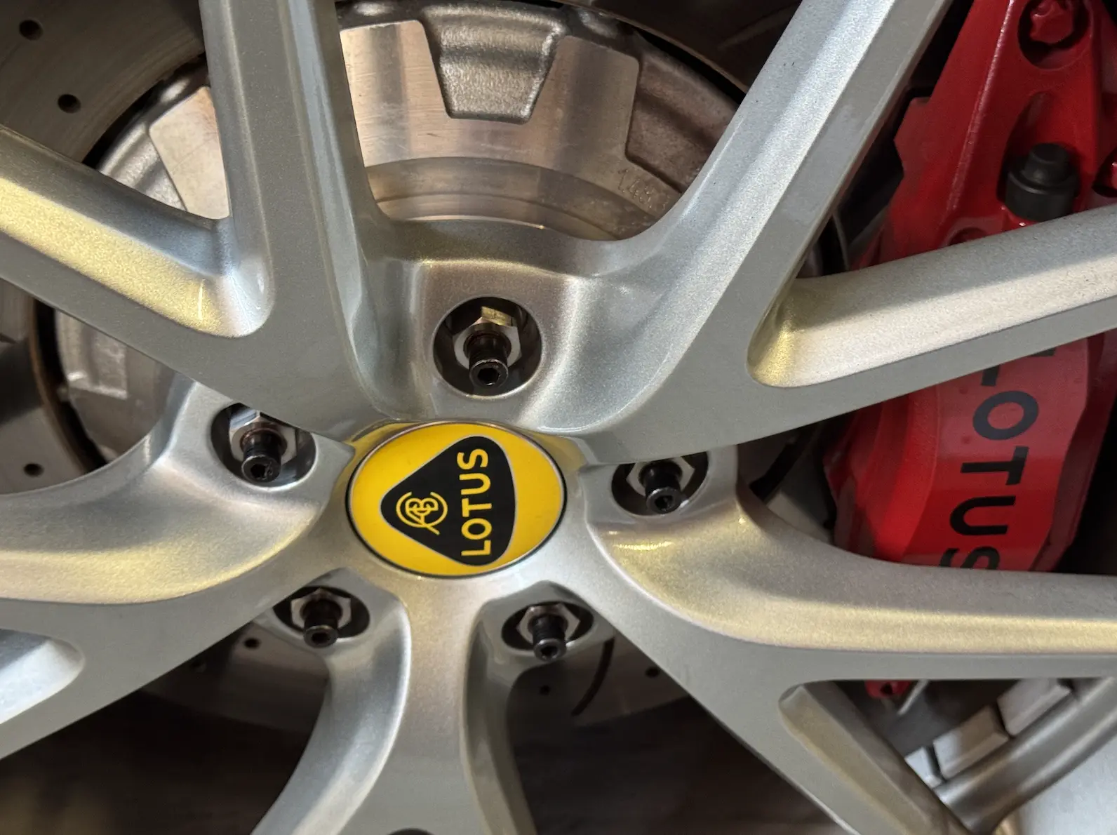

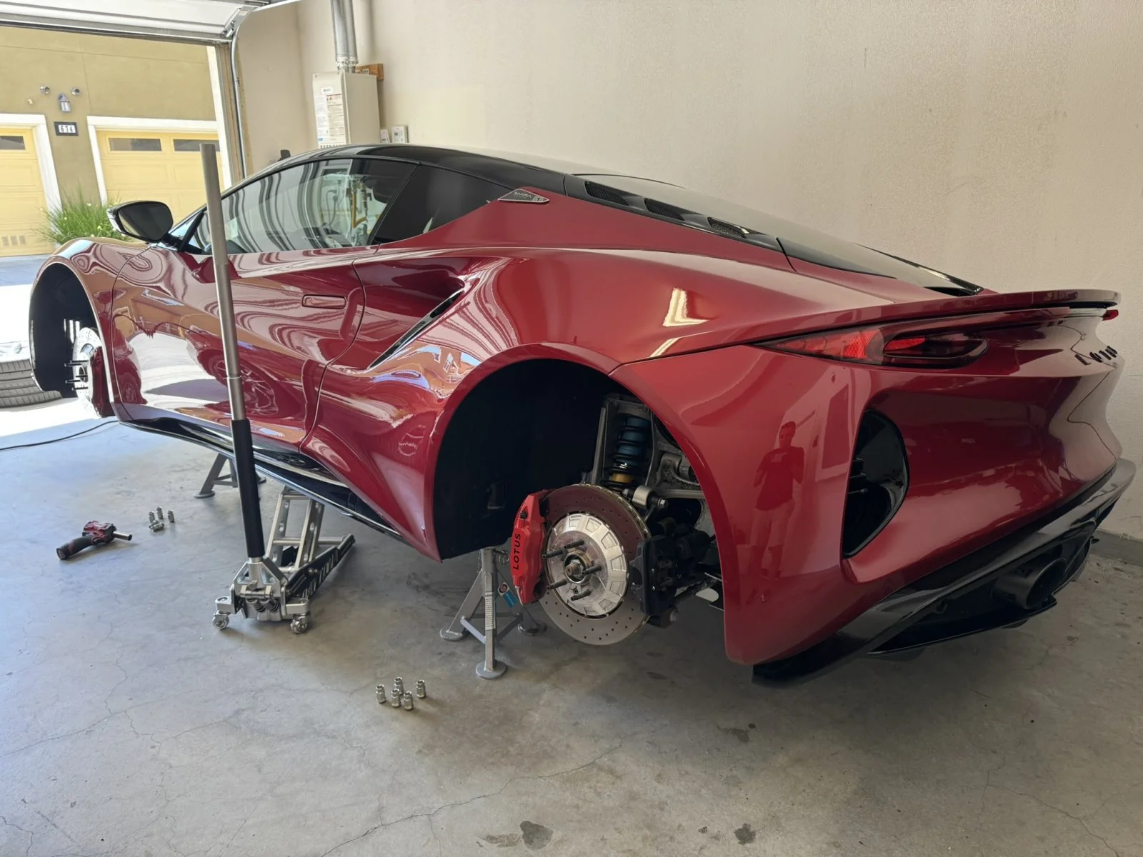

I added wheel studs and 12mm spacers on all four corners to see how much clearance there is on the OEM alignment, I will be getting an alignment next to see how much camber is possible for track duty and to help me measure clearance for a 3rd party track wheelset as the OEMs are for street only for me.
Enjoy some photos from this weekend.

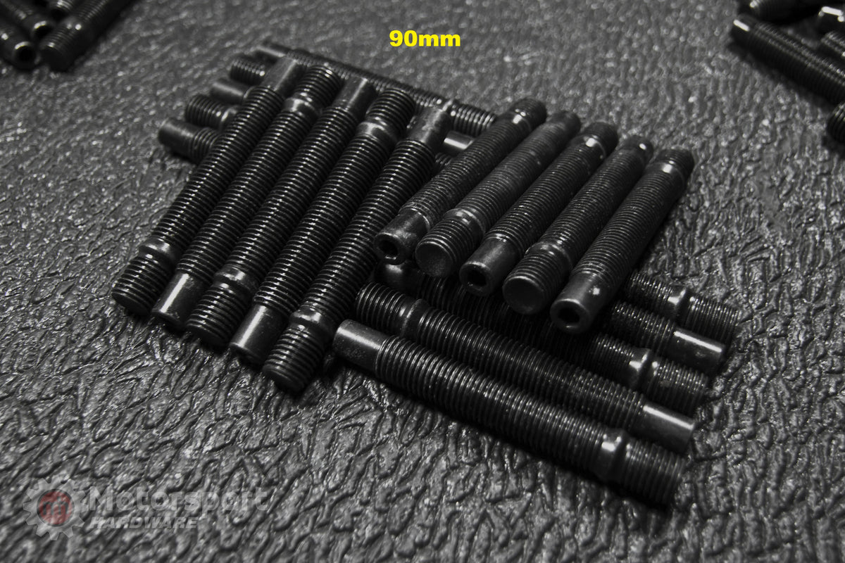

These all standard GRP? I've hear "wobble" issues in the front with spacers? Also, what length stud kit did you get to accomodate?

Hey! These are not GRP's spacers, Greg hasn't released a 12mm set yet -- mine are from PCD. https://www.ebay.com/itm/126093879482
You can use the 75mm stud conversion from Greg here which is the length I have, shorter won't fit spacers, and longer will stick out too much.
Greg mentioned he'd have the 12mm spacers ready in a couple weeks or less, so maybe just wait and order them all together -- it would probably get here faster ordering them from Greg anyways seeing as shipping from the UK for PCD will take a while.

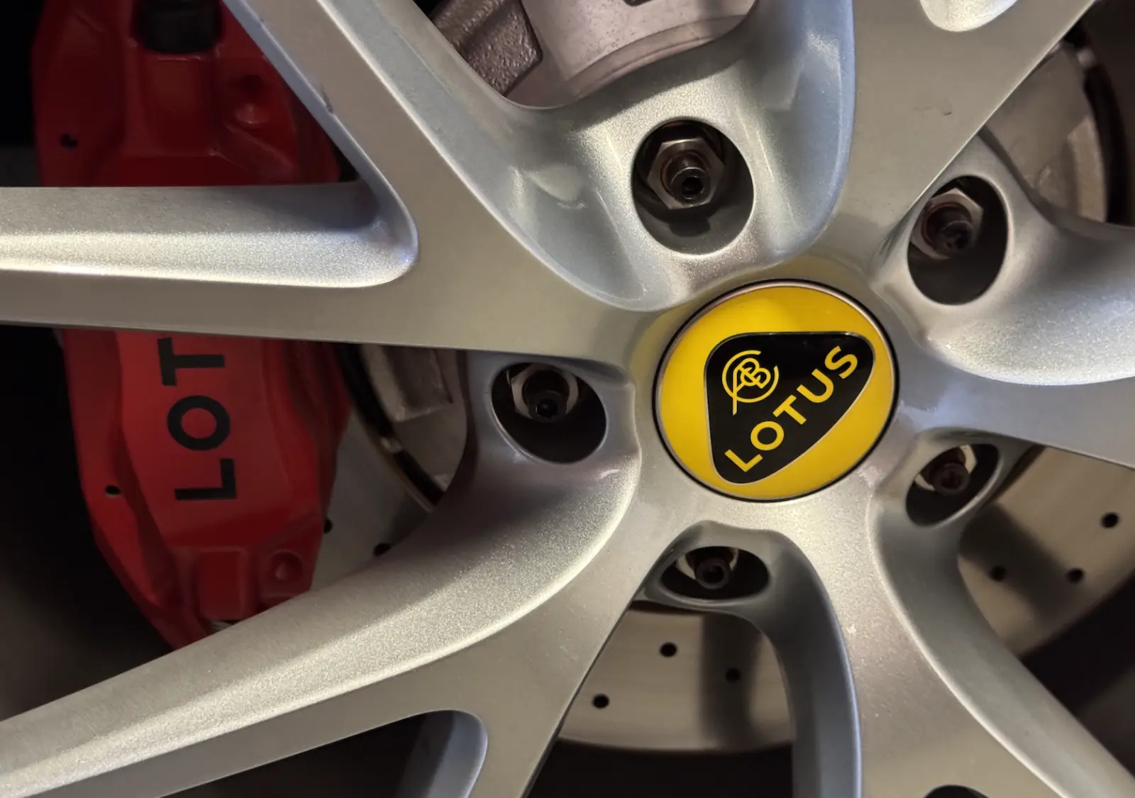

The hardware up front:
Hardware in the rear:
As an eBay Associate we earn from qualifying purchases.

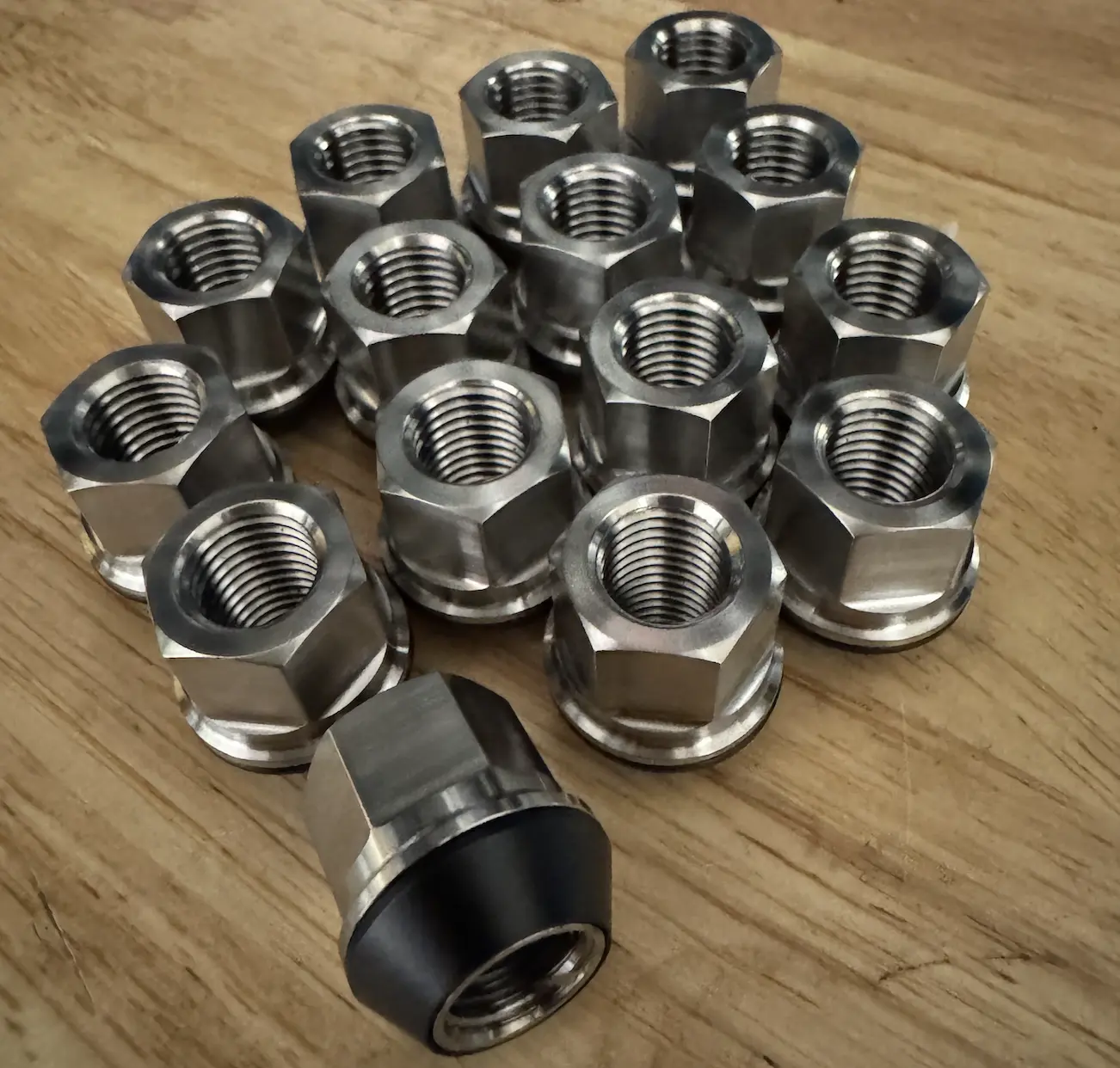

I'm also trying out some titanium hardware, took a while but found some 17 hex M12 1.5 conical seat hardware with a floating seat for a decent price. I'm going to be pretty careful to examine threads for any galling whatsoever because I'm pretty dubious about the longevity of titanium hardware.
Unproven so I can't really make recommendations on it, but if anyone is interested: https://www.ebay.com/itm/296380889898
