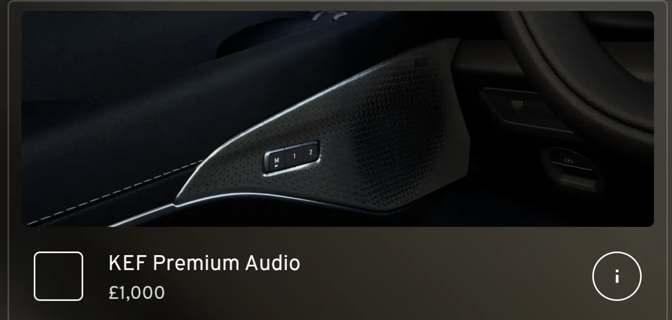

The (in my opinion) poor KEF system is now a £1000 option!

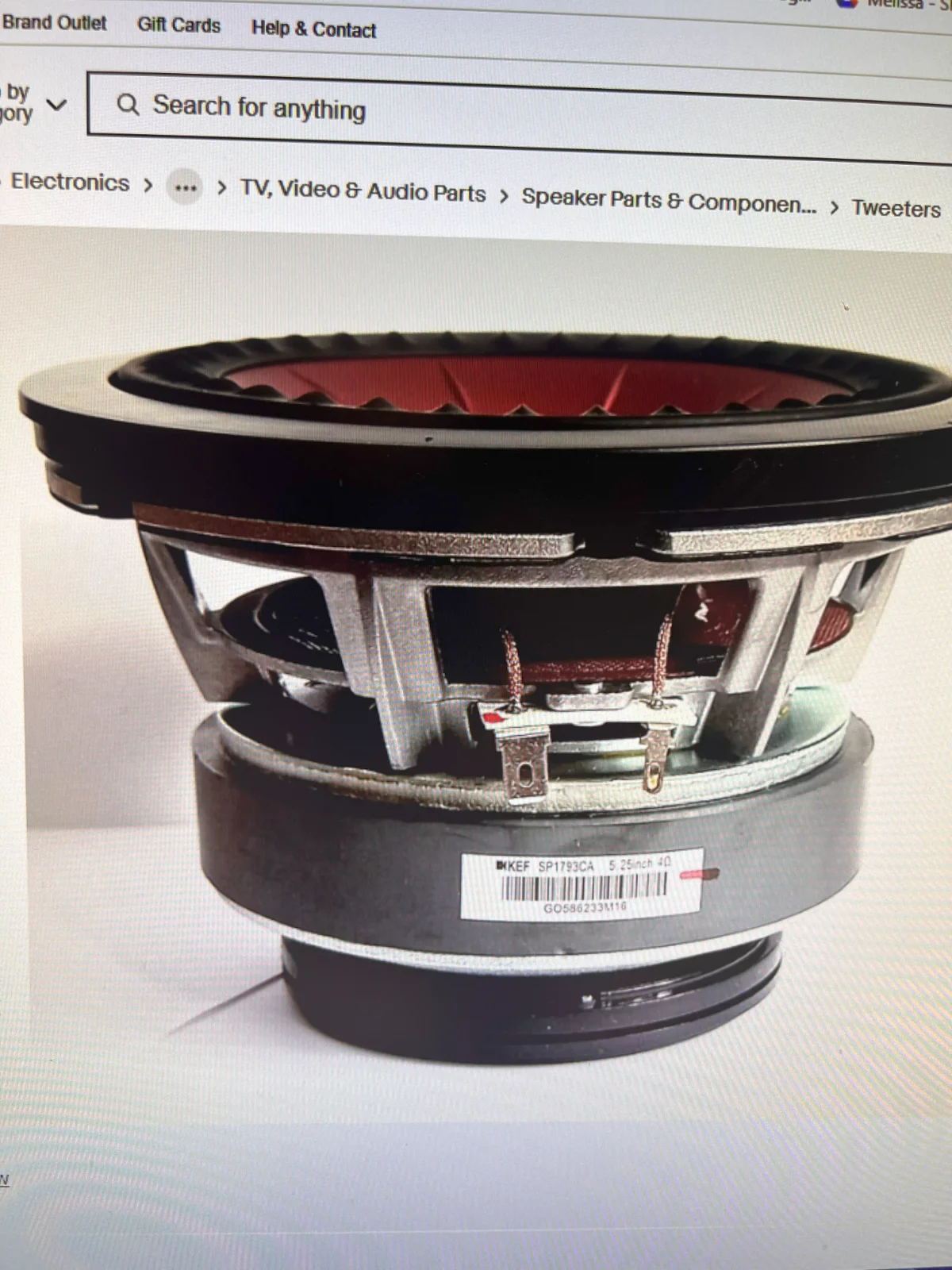

https://www.hifix.co.uk/product/kef-ls50-meta-speakers/ £1199 for a pair of very similar KEF drivers in boxes (and the Emira has 3... plus the two rears and the subwoofer)

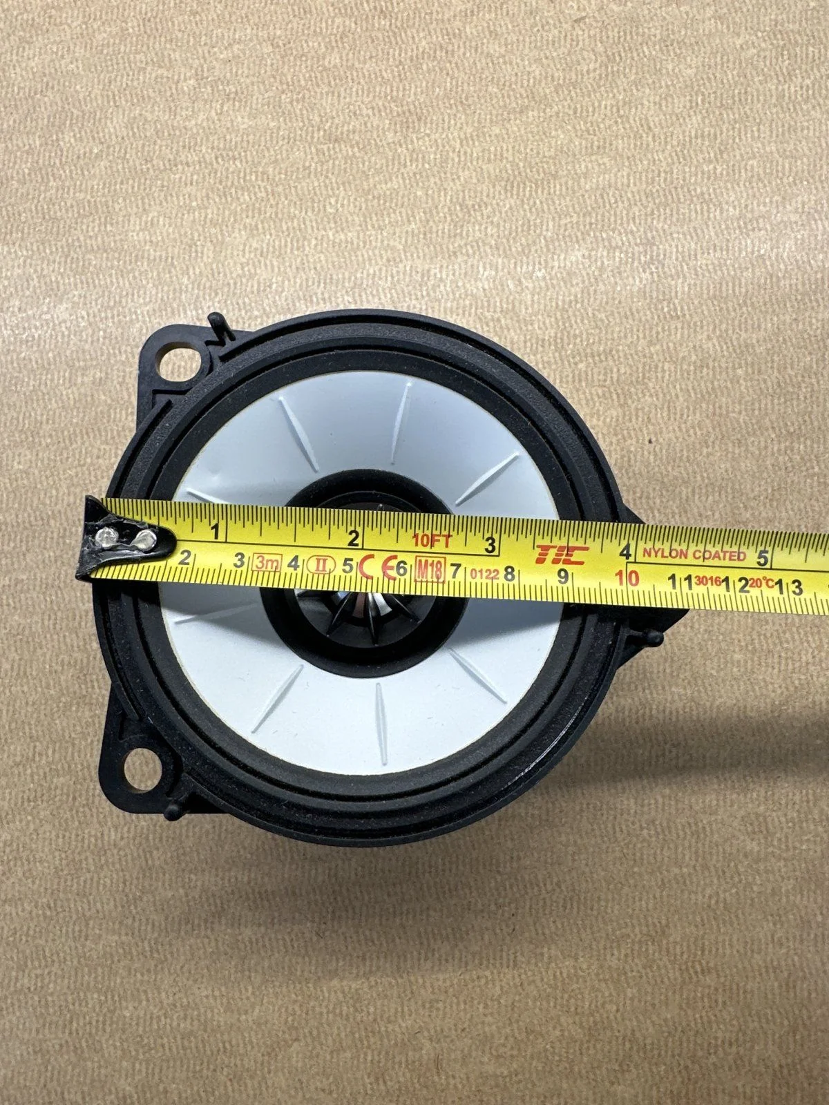

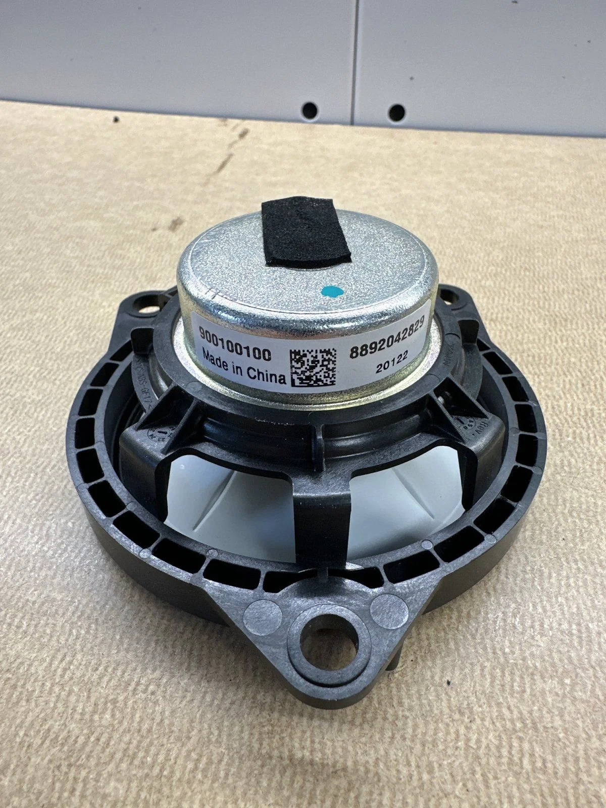

The Meta LS50 speaker is indeed quite nice. Although, the drivers in the Emira are NO WAY near the quality of the LS50 drivers. The (3) Emira drivers are much smaller and utilize a smaller magnet, voice coil and they use an inexpensive plastic chassis. Definitely, a budget driver. The LS50 driver is in another ballpark. (Pictures below, I may have borrowed these from another thread, sorry for not remembering the source) BUT, there is hope. I have contemplated grafting in a pair of LS50 drivers (available through a service center, I have a pair right now). This will entail significant modifications to the existing door panels. Roto tool surgery plus a 3D scanner and then newly 3D printed door panels will be necessary. Then, a full upgrade to a new A2B processor and 10 channel amplifier. It can be done and I have completed many car audio conversions such as this.

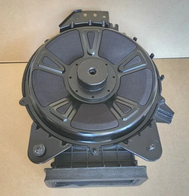

My game plan on the Emira is to remove the very substandard, (thank you bean counters) 6x9 "fresh air" woofer and bypass the existing subwoofer amp. The "fresh air" concept is quite unique and when done properly, it is very impressive. The Volvo XC90 B&O system uses a "correctly designed" 11" subwoofer that might work in the Emira. I have one for testing. I have had to cut and 3D model a new port manifold to use the existing Emira exit port. A search for a replacement subwoofer amp is ongoing. Kicker (who in my professional opinion) has made and can make some very good equipment. They now offer a monaural DSP subwoofer amp with a "self learning" mode which is sort of a poor man's Audyssey home theater acoustical equalizer. This amp is better suited to a lower impedance load than the nominal 4 ohm load of the Volvo sub, but it should prove to offer much better sound. I'd like to thank Nova for turning me on to the Kicker sub amp. An Australian company "mObridge" makes some really fantastic DSP audio amplifiers. I may step up and go all in with their 9 channel DSP amp as soon as I can make the digital output of the Emira radio play nice with the digital amp. I'm pretty sure they use the same "language", some configurations may be needed.

I'd be very interested to see if you can get that Volvo sub to fit. It's pretty tight in that cavity. I hope you can.
Do you know the specs on the different factory amps in the car, and if one can be removed and another be retained? If one is purely for the factory sub, and not used for any other functions maybe there is a shot at fitting that larger free air sub.
