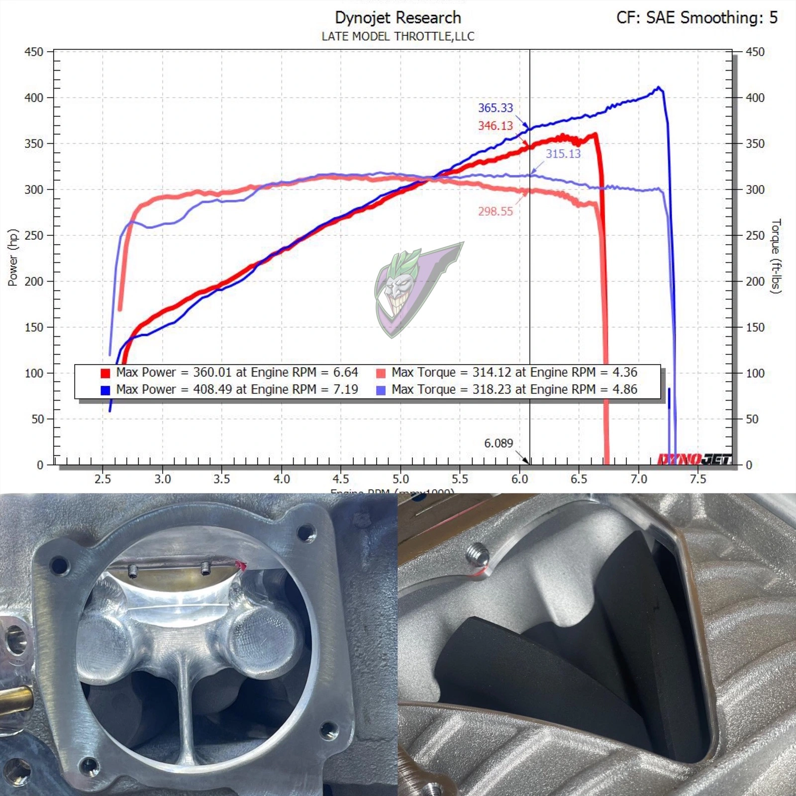

Looking at the dyno chart that appears to be for an Emira, you can see where their porting destabilizes power and torque between 2,700 rpm and 3,800 rpm where it's worse than stock. It isn't until you get to about 5,300 rpm that you begin to see some gains. Unless you plan on spending a lot of time up at the last 1,500 rpms, this looks like it would be worse for an around-town street build. And yes, it would void your warranty.
They also have the chart below on their website which shows substantial gains across the board without a clear explanation about the configuration for the test. They are porting but also offering the option of different pulleys that would raise boost levels which I assume is driving the delta. Increased boost with the factory pistons would introduce longevity risks.

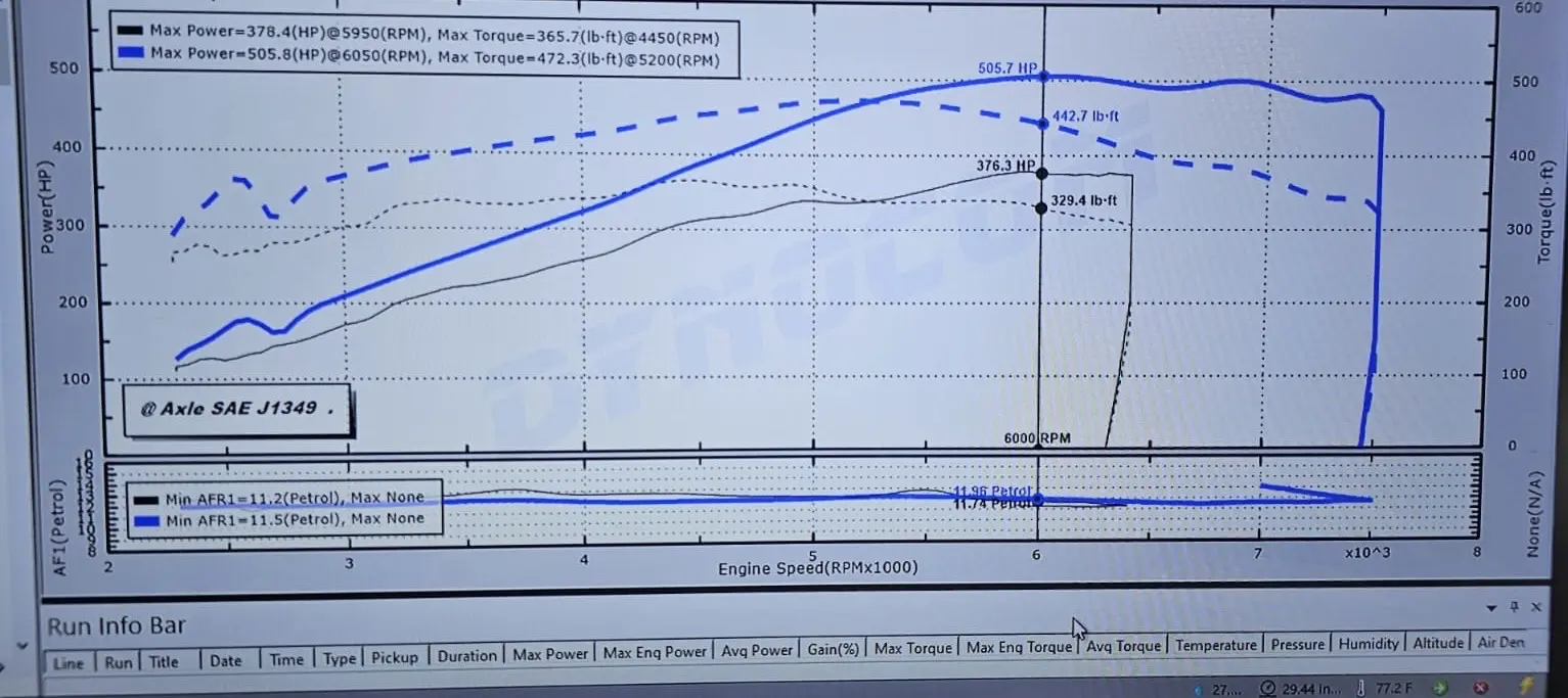

Olympic Motorsports has tuned a few Evora GTs with the Jokerz ported blowers, as well as smaller pulleys, larger throttle bodies, etc.. You can call and speak directly with the owner, Luiggi, and I'm sure he'll give you all the info needed. They've been posting some impressive dyno charts with tuned Evora GTs putting down ~500whp!

Olympic has installed the Jokerz ported blower and achieved impressive horsepower figures as shared above. Jokerz could explain how they improved the power curve on the second dyno chart that I shared which doesn't exhibit the drop off in power below 3k. It looks like a combination of a smaller pulley and their ported blower versus the ported blower alone.
