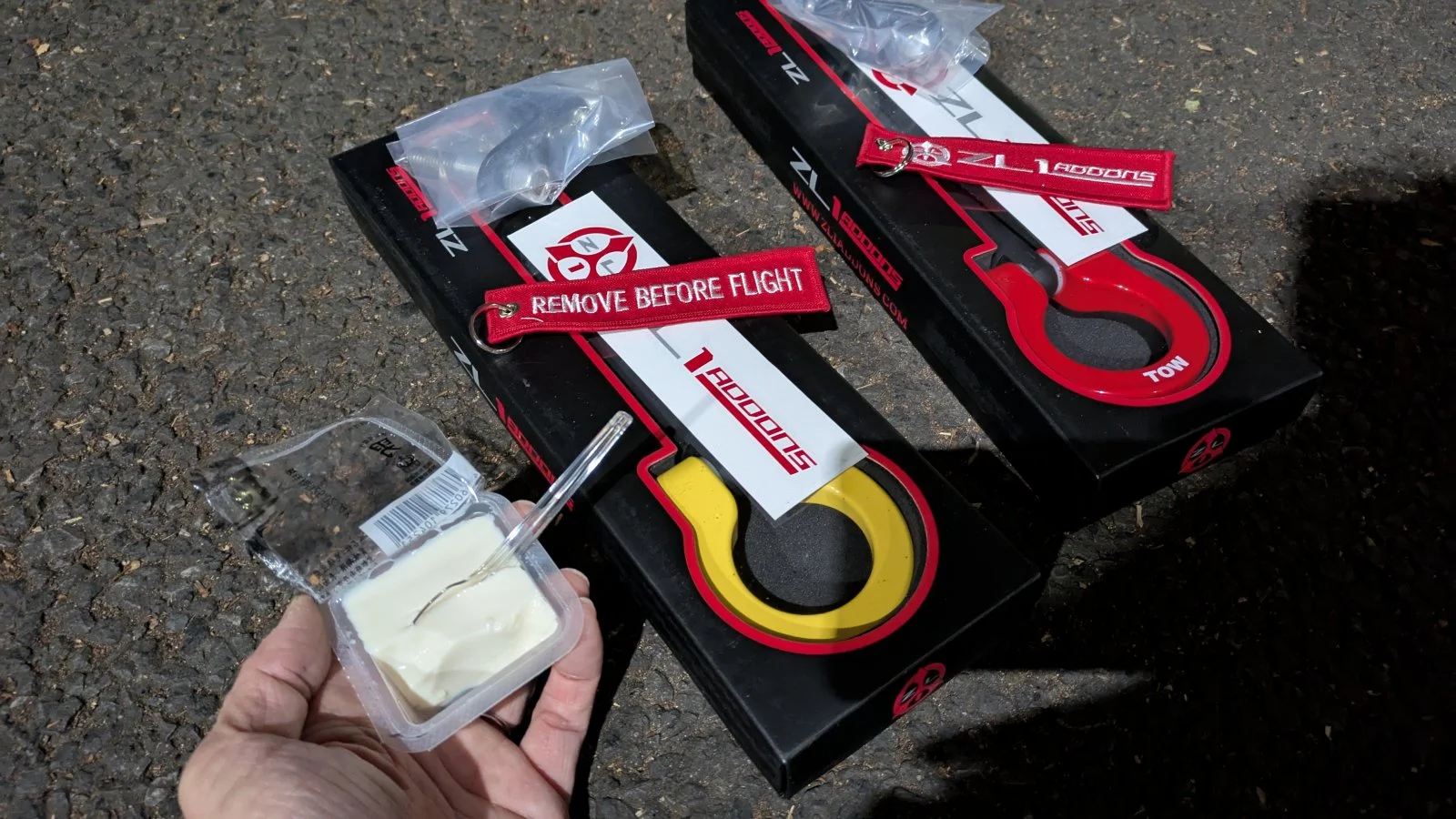

Went out to meet @shin73 and receive our tow hooks, and eat tofu (tofu kuu). Hope to see you all soon (how about Izu ?)
「トウ・フックで豆腐食う」の会にご参加の皆様お疲れ様でした!次は伊豆あたりでソフトクリームを食べましょう!

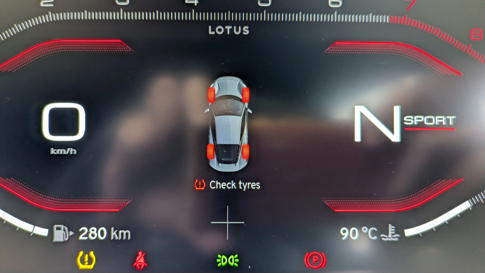

Probably just a false alarm!
Yup. All four tires at the same time is more likely to be an electrical issue, probably common ground. The thing is, it's a "sticky" type warning, and needs to be cleared to turn off the display.

久しぶりに出た。
Electronics. Again.

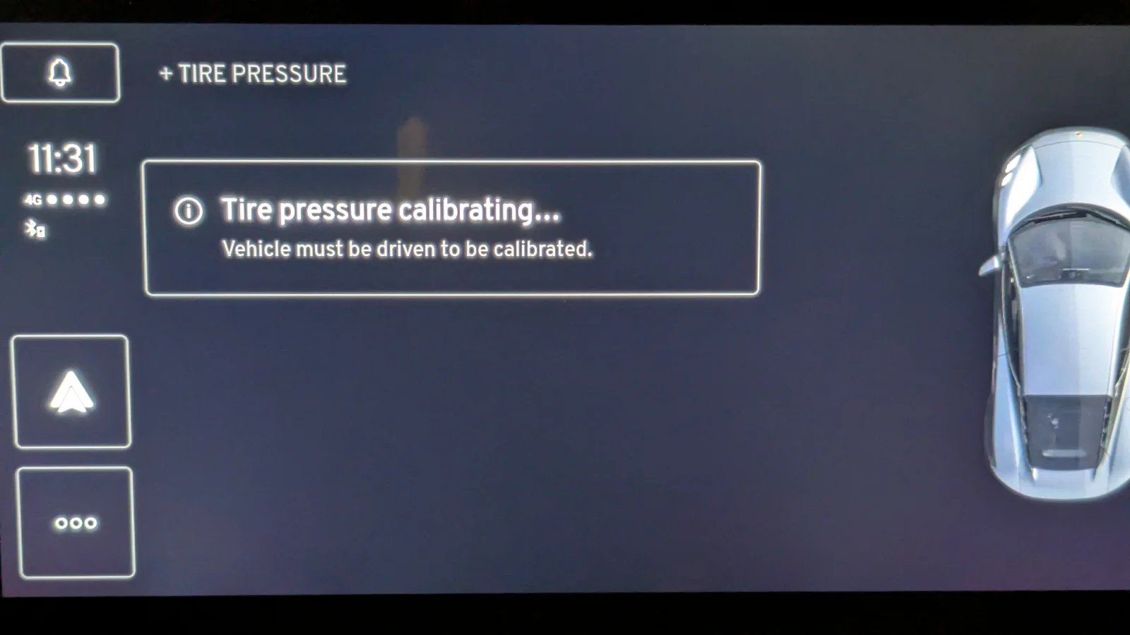

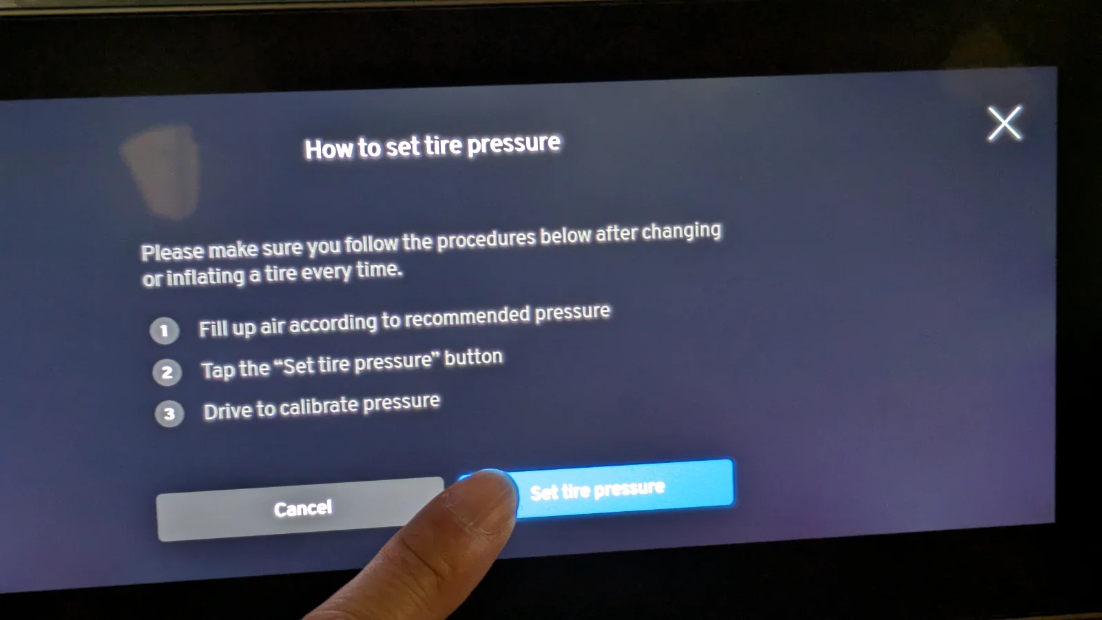

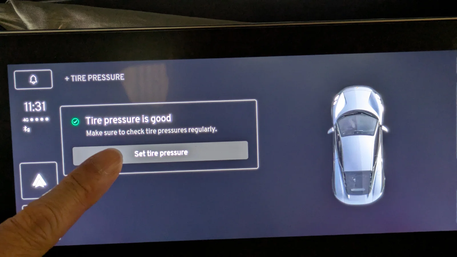

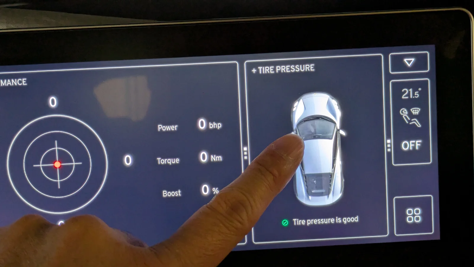

Looks like you can turn the warning lights off without visiting the dealer. Just need to re-calibrate the system.
なーんだ、自分でできるじゃん。要は空気圧の基準値を覚え直せばいいだけ。もちろん、本当に空気圧が正しく、タイヤやホイールから漏れていないことが前提。
step 0: Make sure the tires are inflated at the correct pressure
step 1: Tap on the car on the screen
step 2: Tap the "Set tire pressure" button
step 3: Tap the next "Set tire pressure" button
step 4: Drive around and let the system re-calibrate itself
