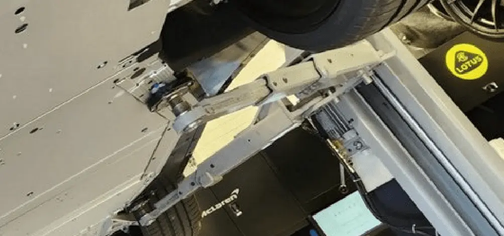

I raised the issue with Lotus NZ. They were very quick to respond stating a software release is due in the next 48 hours which includes a remedy for this. My car is booked this Friday to be upgraded. I will update you next week if the issue has been resolved. In NZ the cars are serviced in the Mclaren workshop.
Snippit from email from workshop:
I would really like to load the software prior to the weekend so that you can get the best of the Emira when this “good weather” finally arrives during the week.
Great service Lotus!!!
