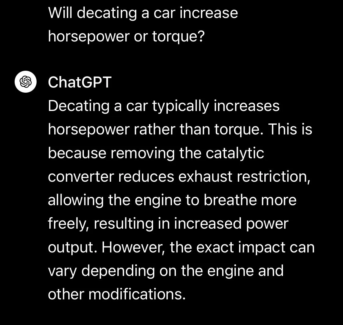

Here ya go, but no one has posted a Dino it yet with just the decat
My question. Does this decat replacement have any real HP or performance improvements? or is it just a sound thing. Can anyone direct me towards some data that has explored this. Or does your experience with this modification give a better drive feel when accelerating. Thankyou
Maybe not ZERO performance increase, but I would say mostly sound enhancement. The stock cast exhaust manifolds (headers) with 90 degree bends and their built-in cats look like they would provide more than enough restriction. Any performance changes in dyno results of a cat-delete-only-mod would be negligible.
When we tested on an Evora 400 prior we did an intake and decat install to net about 10hp.
We will try to do a dyno test with just a decat on an Emira but like @virtualmacho mentioned the gains will be minor, its more about the sound with these.
For a more substantial hp increase headers would be the ticket but then you increase the sound even more, delete the primary cats and open up into another realm of things to think about.
