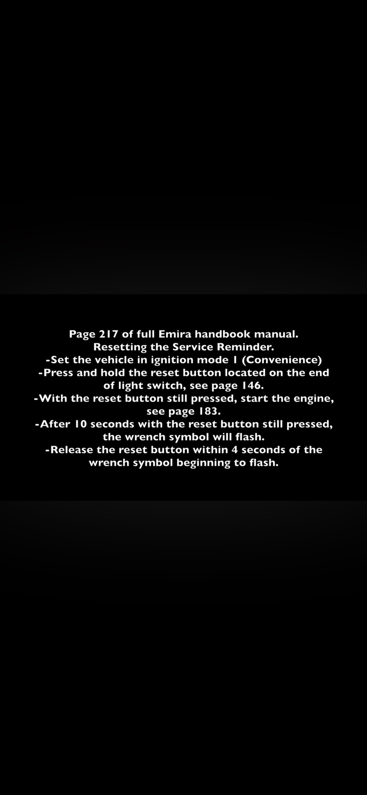

Yeahs that’s why. You may not be due because of mileage but because of time. Does it say 0 days left?
There are instructions somehere in the forum on how to reset that service reminder
Edit: found this, pretty sure that’s what I did when I cleared mine.
That did it guy....thank you so much.
So...if were to guess it was a 'Service' reminder....and by the clock. 12 months since the car was turned on.
