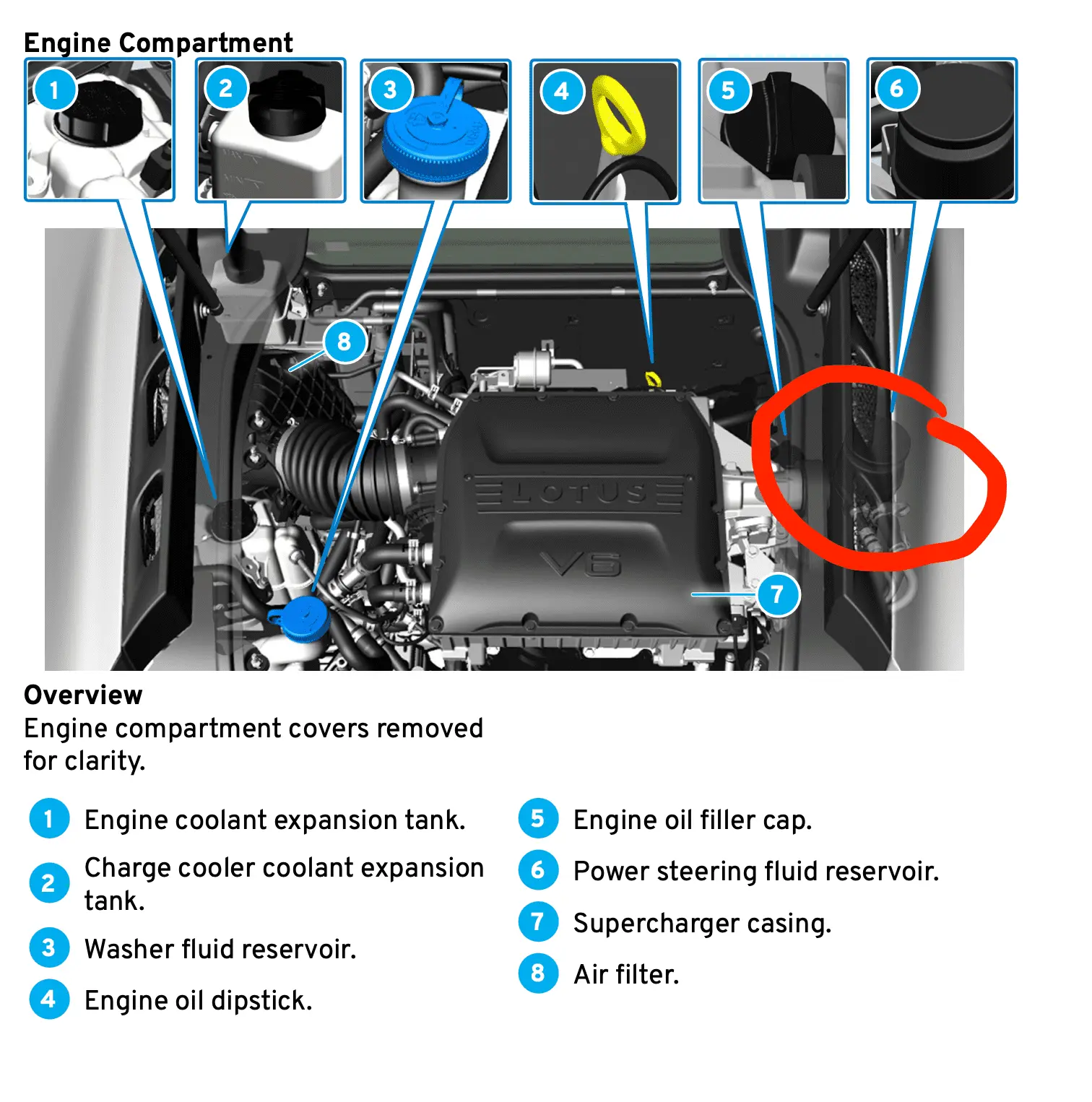

can anyone give me rough idea of where in the engine bay the power steering fluid is located so I can check it - thanks
You'll need to remove the right hand (passenger side) wheel liner to even check the fluid level, you can't check the level via the engine bay as it is tucked away. This needs to be done with the engine off and on with the steering wheel lock to lock on both sides.
Also even if the level is fine you could have an air pocket in the line somewhere which could cause some weirdness too. These systems need to be bled with a mityvac with the right cap to form a seal.
Thanks, something for the dealer to be checking then rather than me!
