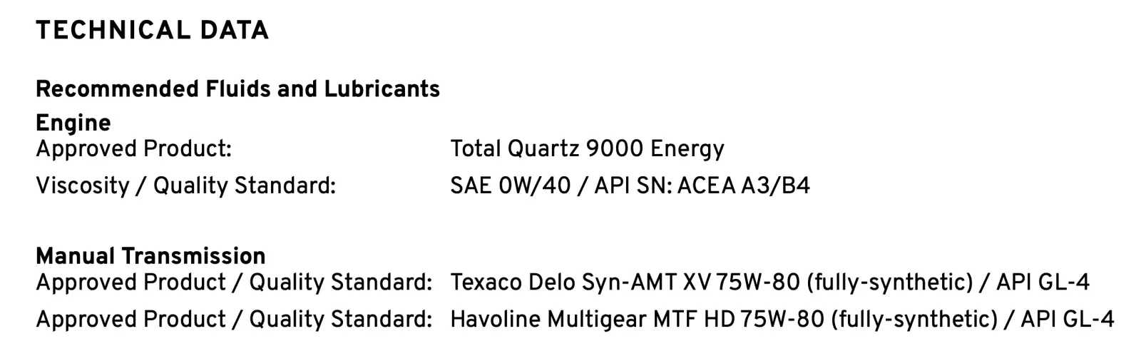

The UK Emira Owners handbook says the correct oil is TOTAL Quartz 9000 Energy, SAE 0W/40 / API SN: ACEA A3/B4

Do you have a source for this info? It differs from the info in the Emira Owners Handbook.

This is from the Emira manual:
