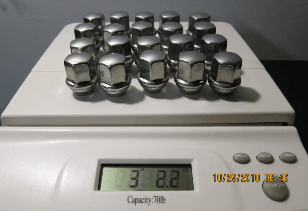

If you've ever had a coffee can full of miscellaneous steel bolts, nuts, screws, washers, etc., then you know how heavy even that small amount of hardware can be. I'll have to take a good look at the Emira when I get mine to see how much hardware is on it, but just as an average I'd say you could probably save anywhere from 25-60 lbs depending on how many bolts, washers, nuts, screws and that sort of thing is in the car. I know they use a lot of glue in their chassis. If it's a part that's not in a high stress area, high strength aluminum will work. If it is in a high stress area, or one that gets hot, then titanium hardware can be used. Titanium obviously is going to be more expensive than aluminum, but overall it's not that expensive. This kind of plan really isn't as expensive as it is time consuming. It takes a lot of time to do. You'll need a good torque wrench, a short and long extension for the wrench, and need to know the factory torque requirements for each bolt you replace. Screws are usually just fasteners so there's no torque issue for those.
Just as an example, back when I was going through a weight reduction plan on my 2010 Camaro, I replaced the steel factory lug nuts with high strength aluminum. I took pictures of both on the weight scale.
Factory steel lugs:

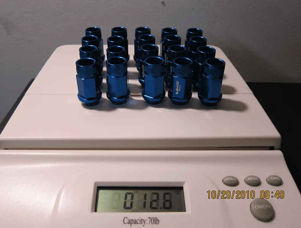

Aluminum lugs:
As you can see, the factory lugs weighed 3 lbs 2.2 oz, and the aluminum lugs weighed not even a pound for the whole set; only 12.8 oz. A pound is 16 ozs. That's just a set of lug nuts, but it gives you an idea how much weight can be saved if you've gone through and replaced all or most of the heavy steel hardware with lightweight high strength aluminum or titanium.
If you do this, replace only one piece at a time; one bolt/washer, or one screw, and replace it. Don't remove a group or a lot of them to save time. You don't want anything to move from its position, especially something heavy. The only exception would be lug nuts. You'll need to know the strength rating of each bolt/nut you replace, so you can get the equivalent (or better) rated replacement. Don't go cheap; get proper rated high strength components, and they'll last forever. You can probably find all you need online now, but you can also find this kind of hardware at a place that sells aircraft hardware.

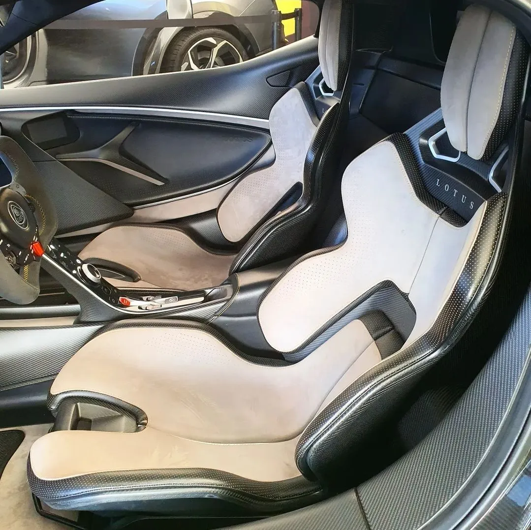

I was looking at the tilletts and one of their seats is quite close to the Evija!
If he does does a more padded version of his normal offering, he could be onto a winner
This! I've raced karts with carbon Tilletts a few months ago and I'm still sore! Ok, that's a bit of an exaggeration, but I definitely want padded seats in my $100k car. Tillett makes some awesome stuff and can't wait to see what's available for the Emira. It'll be great to get the 12-ways out and weight compared!
