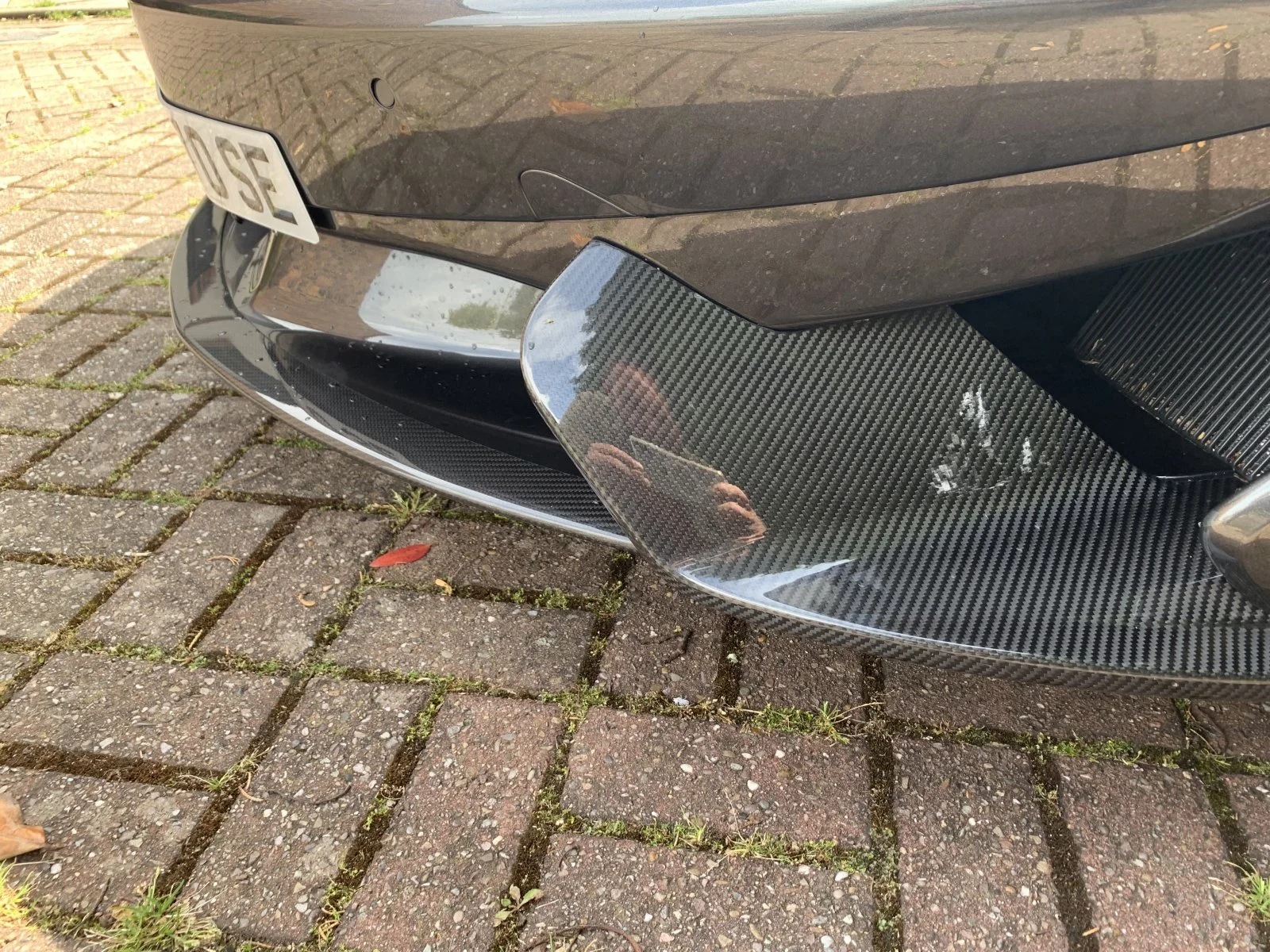

No only mods to the car sports cat and miltek, i will be lowering via the circlips (free lowering) fitting 12mm spacers and a front spoiler next (i would love a set of extended diffuser bars as well but waiting until grP gloss black becomes available as i don’t dig the carbon look done that years ago on my 570s and it looks dated now in my opinion only)

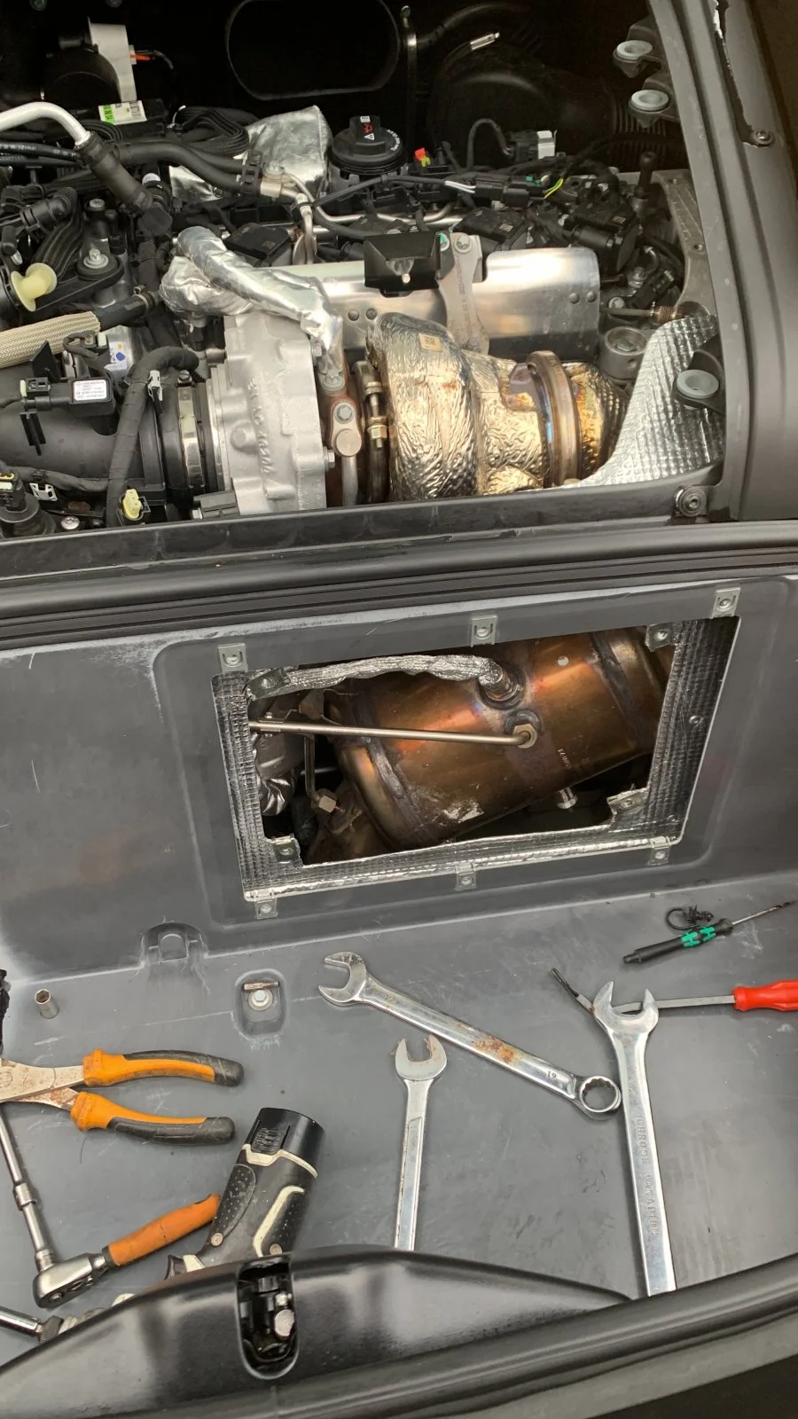

How did you remove the OEM downpipe - on the A45 you had to remove the headers and turbo housing first, but can you just open the inspection hatch in the trunk and remove it?
I'm literally doing mine now. Just waiting for the new downpipe from GRP to arrive today (GRP exhaust is due on Monday). It was a nightmare to get the OEM downpipe out, but I managed to take off the turbo exhaust housing and the manipulate it enough to take if out from the inspection hatch. Must be an easier way??????
If you remove the 2 bolts on the RHS that hold the heat shield to the body, you can manipulate it backwards that will give you 30mm wriggle room and the oem pipe just slides right out
