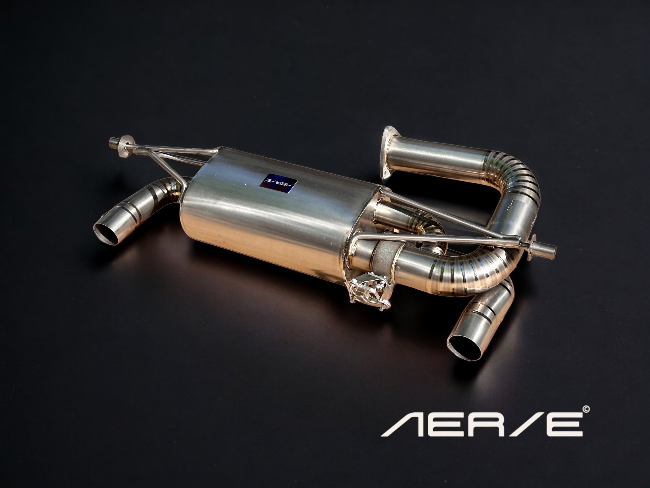

Turbo will be in the US soon. Looking for some feedback on exhaust options. There have been a lot of exhaust conversation wanted to pull them into one thread.
'2nd Cat delete + Valve controller' vs 'Complete 3rd Cat back replacement'
Hard to tell from all the sound clips if the Full exhaust replacement is actually tuned to sounds better than stock with 3rd Cat delete. I realize this is very subjective, but wanted to hear from people who've actually heard the difference and isn't selling anything.
There are many interesting full exhaust options on the market Valvetronic, Aerie Performance, etc . But do any of them sound better; don't care about weight reduction or 1 HP gain...
The Titanium looks very cool....but who knows if they spent any time tuning for perfect sound......

That Valvetronic is a cool exhaust, but it's for the V6 not the Turbo that you have set this thread up for.
The best Emira Turbo exhaust I have heard so far is from a straight through exhaust, but it's going to be pretty loud. I'm very interested to hear more sound clips from various aftermarket Turbo exhausts. I'm also thinking the standard exhaust with valve controller and catless downpipe, would be a better value option with similar sound.

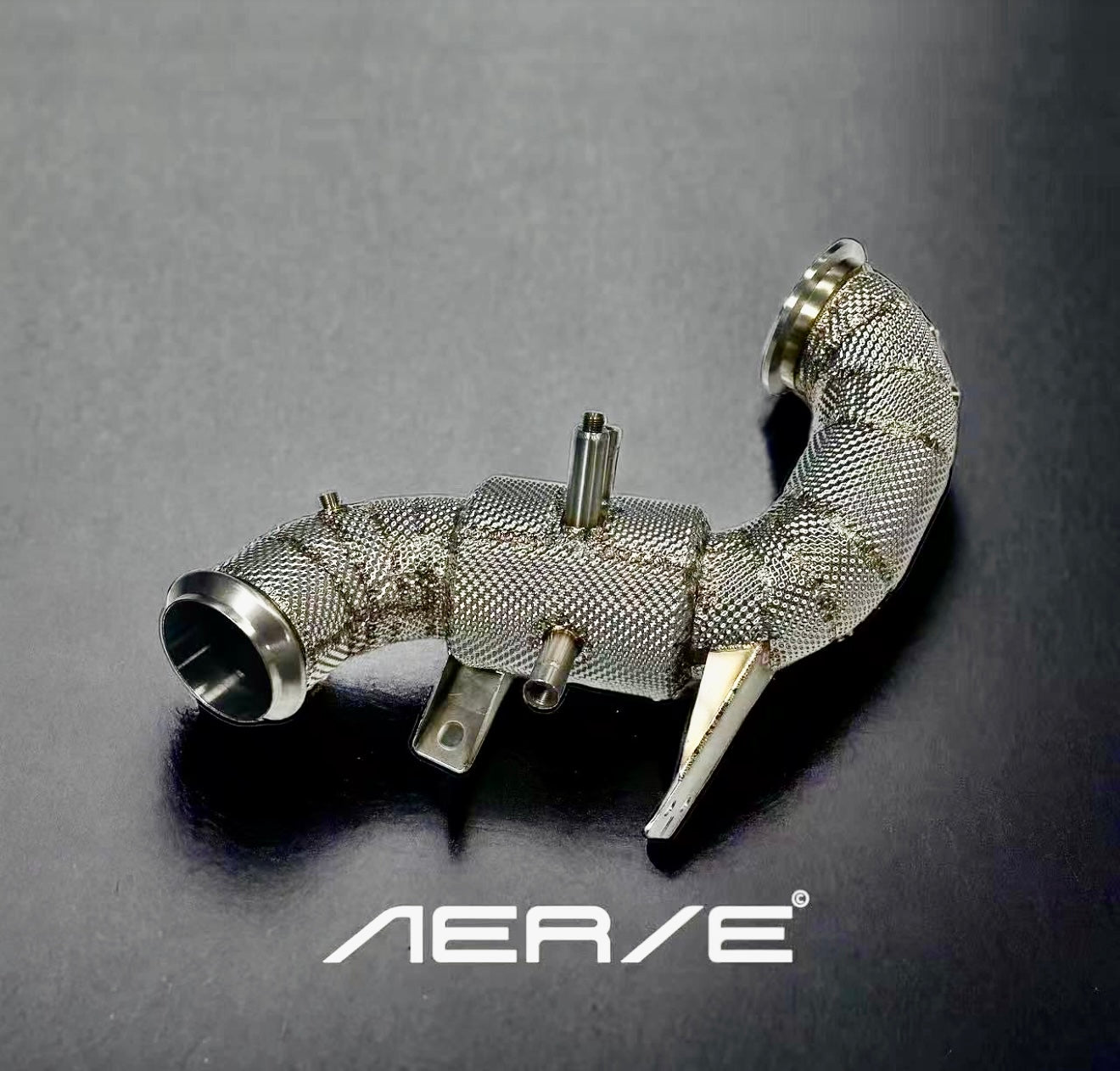

We had development a Emira I4 sport turbo pipe with no engine issues , with a better sound and power upgrade, just a Black Friday 30% discount we sold 12 set in 4 days , please check the link to see the video, that is absolutely amazing on the sound.❤️❤️❤️❤️

Hey. The video still isn't that great. Do you have more videos and one taken from inside the car??? Thanks
Aeries - quick questions is this down pipe compatible with the AMG engine?
No, that is for v6, and we had i4 version .
I will ask our customer take some good video for you as soon as possible.
