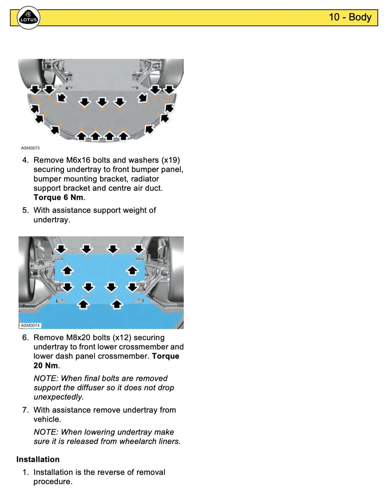

This is exactly what I’m planning to do, too. Are you able to advise what bolt size (I’m going to guess M6?), and length? Do you know roughly how many bolts are fastening the undertray (pieces) to the car?
Eagle7
Emira Aficionado
Nov 20, 2021
2,798
5,762
United States
There's a lot. I highly recommend getting the service manual, as it shows all the bolts/fasteners, what they are and the torque value for tightening them. Here's just one page as an example:
