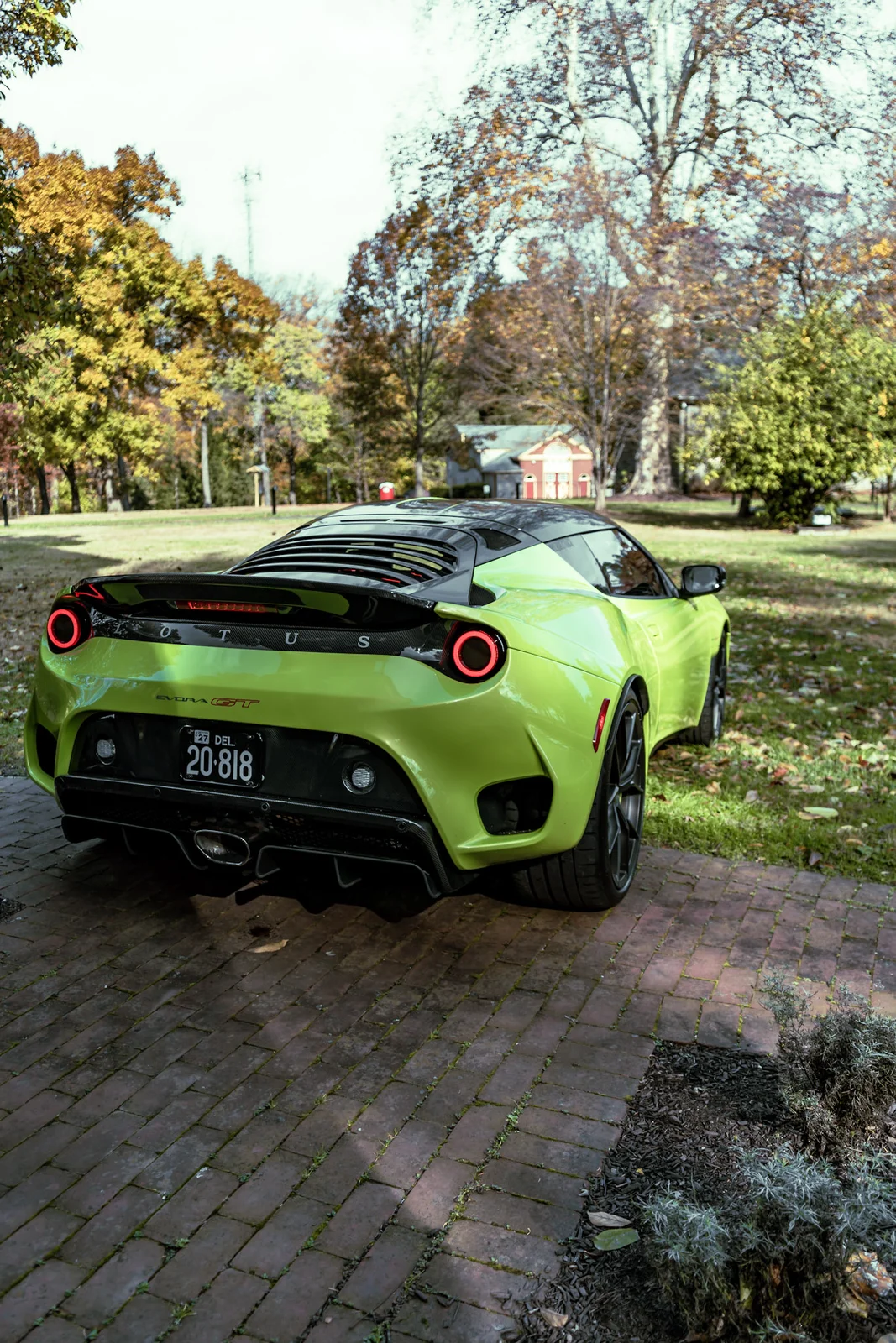

it will be made with optical hard coating on the topside so it should fare quite well. the material is selected for the heat of the engine bay and since its got many vents its should stay much cooler than the factory glass.

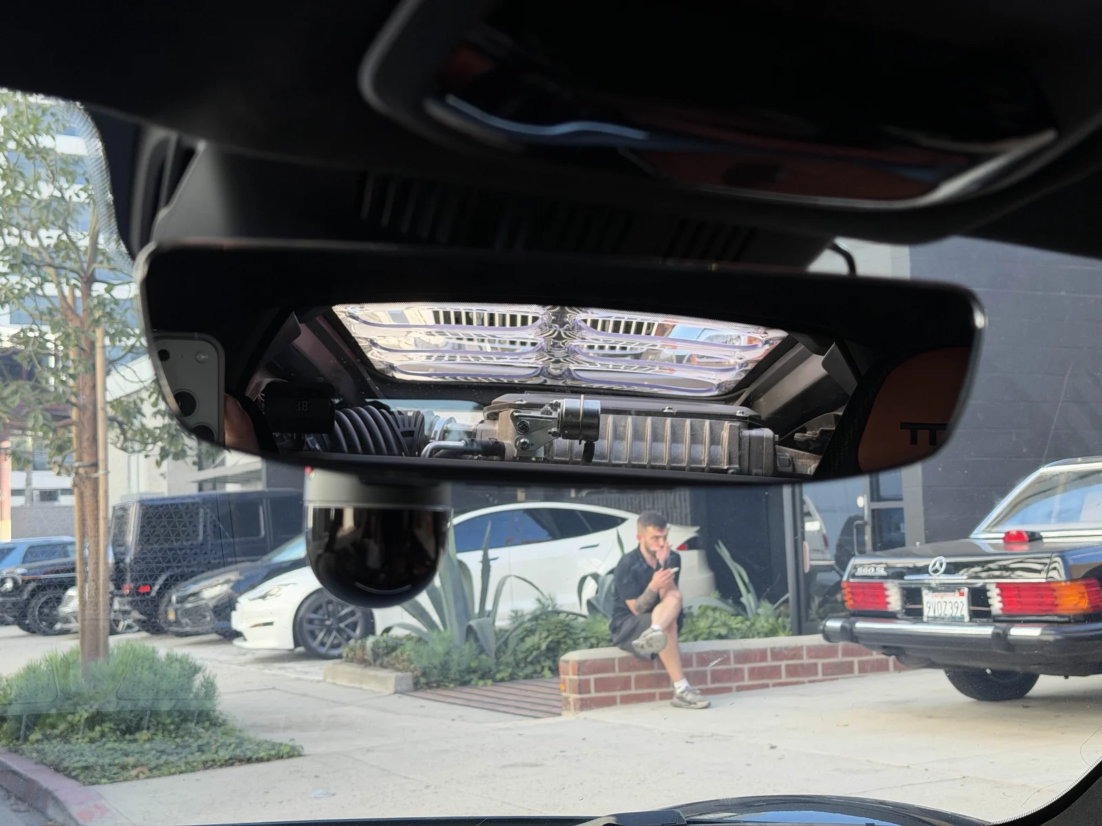

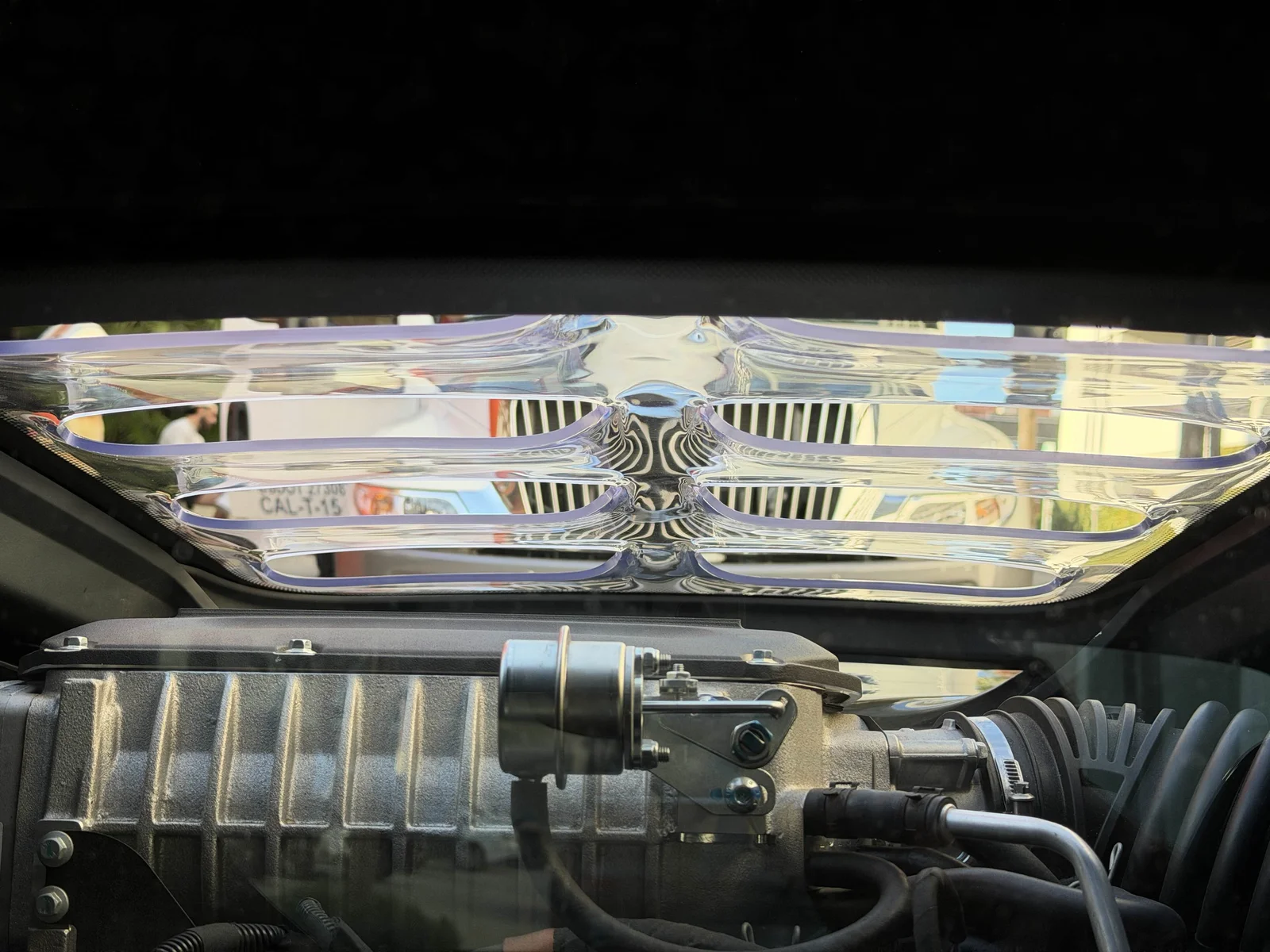

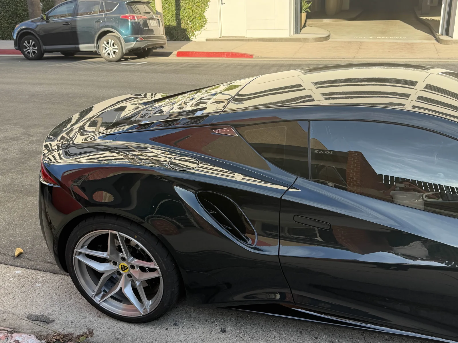

My OEM carbon louvered hatch obstructs the view a bit, but I have no issues seeing if a vehicle or object is coming up behind me. The benefits of a cooler engine bay, lighter hatch, and sportier look outweigh the cons IMO! The rear view mirror points directly through the louvers. Here are a few pics that kinda show the line of view... A clear louvered hatch would have near no downsides.

Your Evora has louvers aligned with the line of sight to the rear, so you're looking around the cover instead of through it. That's fine if this Emira cover does the same, but the louvers look much smaller and broken up.

What was the logic applied in determining the width of the four margins? Any thoughts on making the side margins thinner (wider slits)?
Oh you mean the spine in the center? mostly for aesthetics... and the outer edge fitment.
The width of the spine too, but mostly the outer edges. My question comes from concerns regarding cracks caused by vibrations (I've observed what happens in my polycarbonate motorcycle windscreen) as this is a fairly large vehicle part. I understand this is a prototype, and many changes may be applied.
