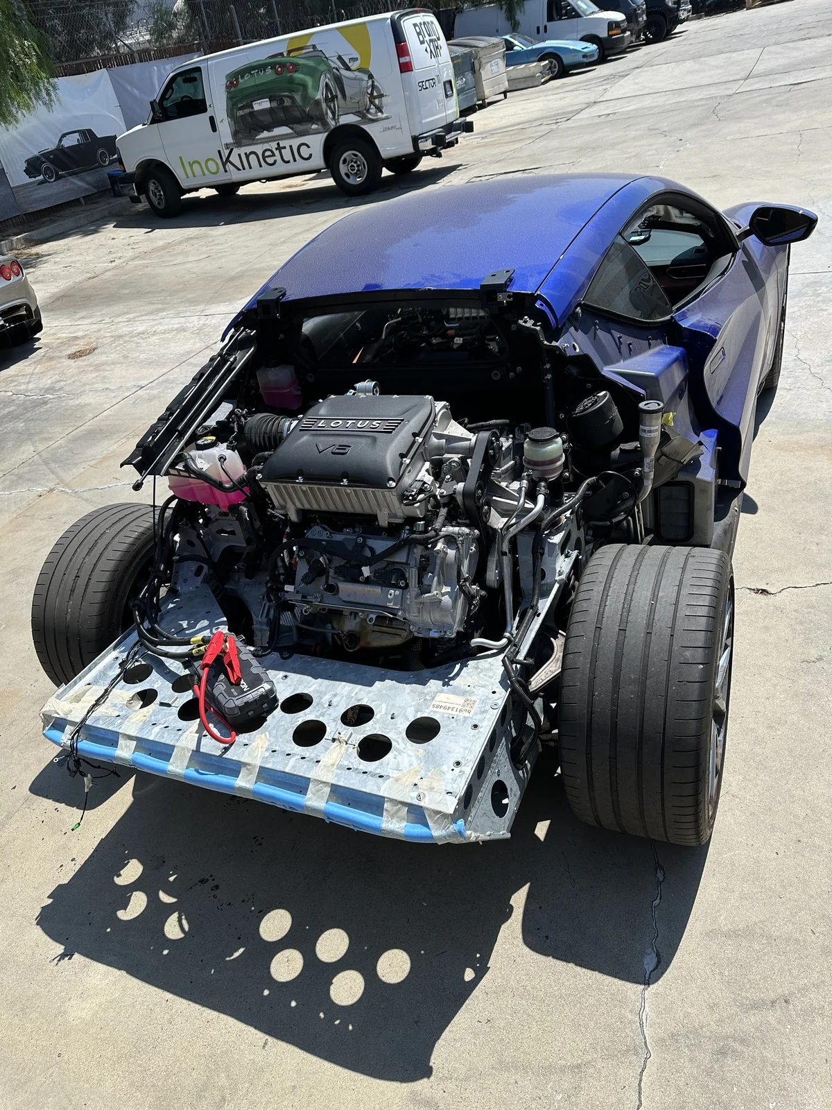

Often times in a collision, damage will propagate to areas that were not in the immediate area of destruction. In fact, sometimes it is better to simply replace certain parts as they may have hidden damage. We took the rear of the car apart after getting the A-OK.

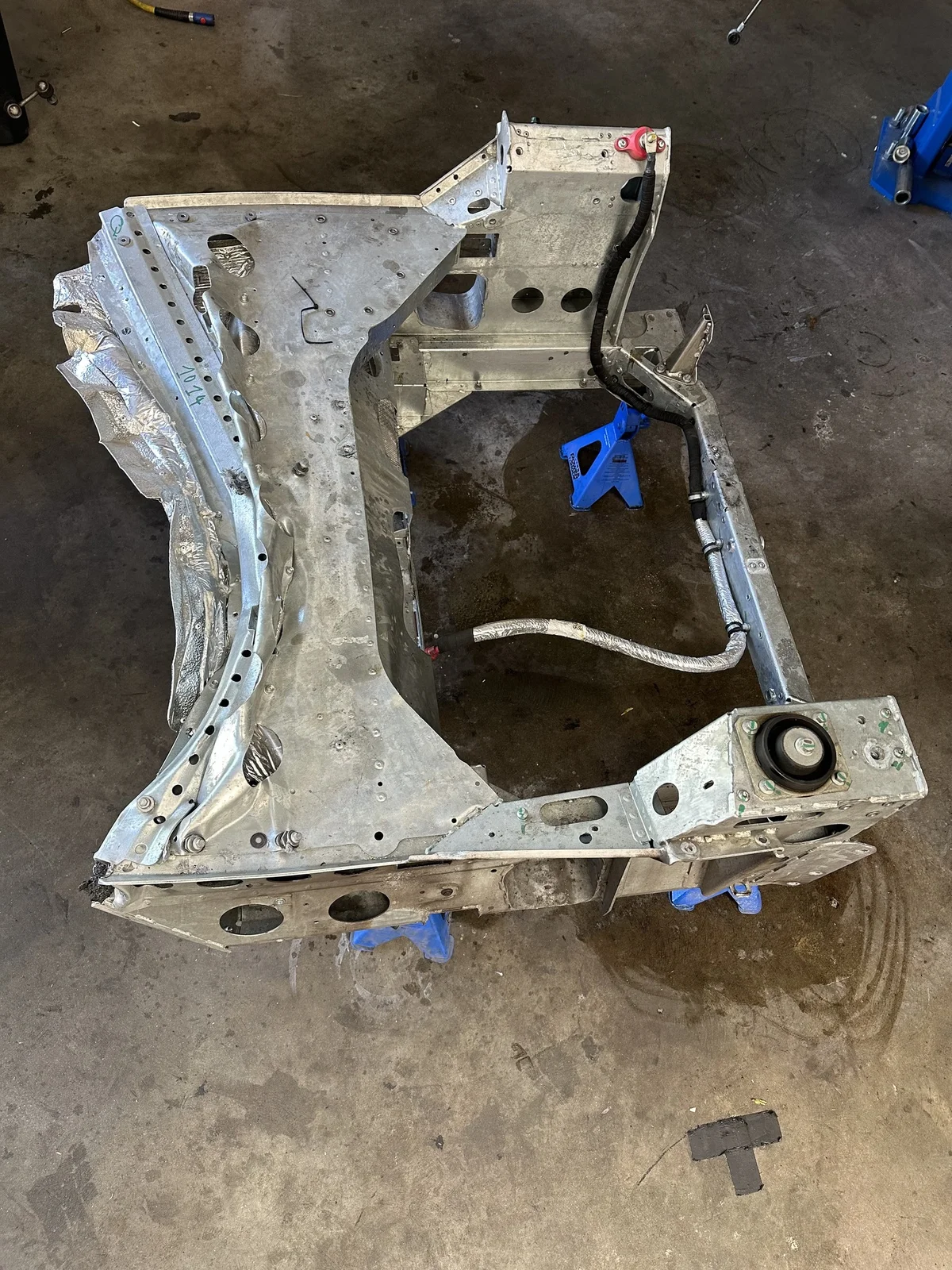

The Emira is built like the Evora which runs a similar architecture as the Elise/Exige. All of these cars feature an extruded aluminum main chassis that feature subframes bolted or glued to the front and rear. The Emira has a rear subframe that bolts to the main Al chassis tub. This steel subframe supports the powertrain and is designed to be a crumple zone that can absorb energy in a crash - as it successfully did here.​
We were very concerned that the powertrain mounts were damaged. Fortunately, they appeared to be undamaged. The Al subframe absorbed the damage. None of the wheels/brakes/suspension parts were affected. The side airbags did deploy so will need to be replaced. But overall the car seems like it can be saved so we prepared a more detailed estimate.

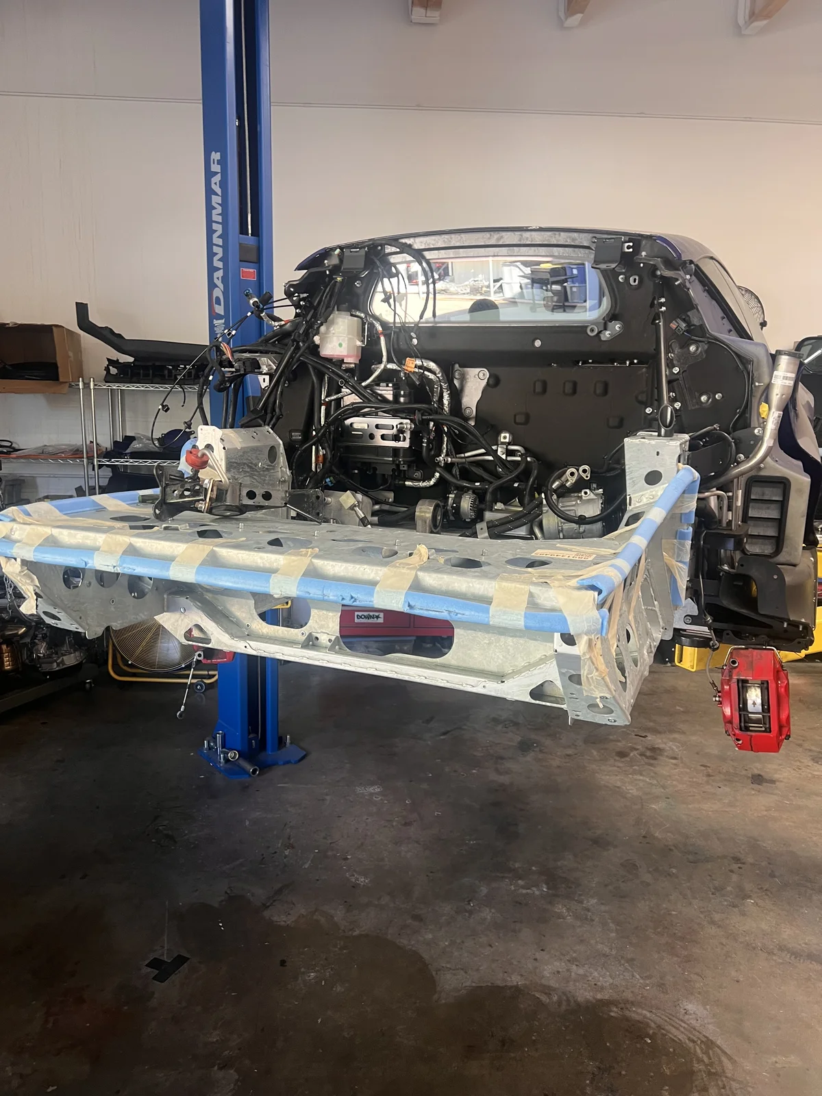

Powertrain is coming out, now that we received a new rear subframe.

Rear subframe is on....powertrain will be back in this week.
The rear engine mount came out easily - no damage or distortion to the hardware. This was a relief and further proof that the damage to the car was constrained to the back and did not translate through the powertrain. 🧐

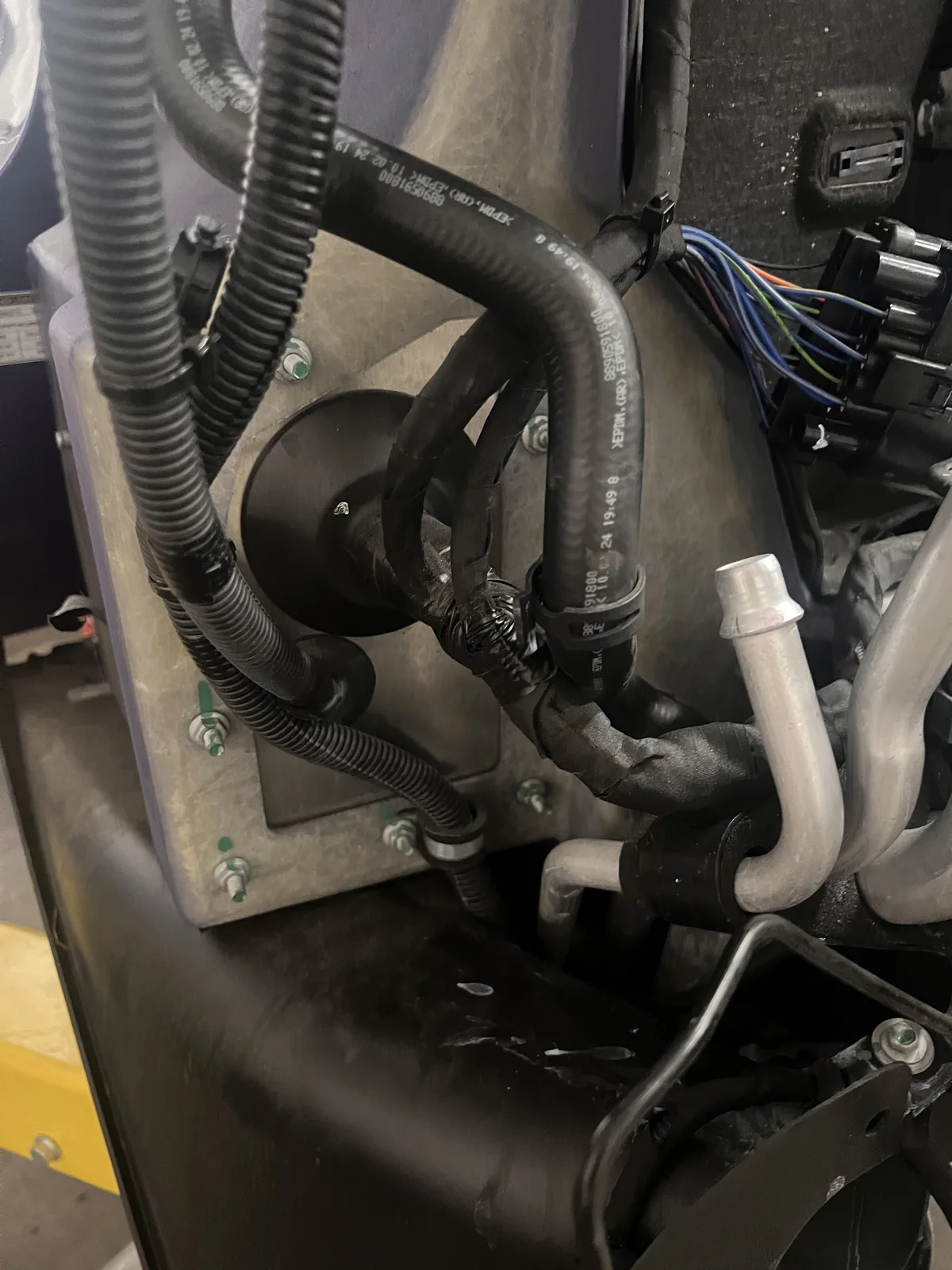

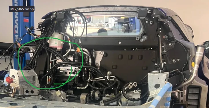

If possible, could you please post pictures of the firewall taken from the left side of the car? Specifically, I'd like to see where the hole / grommet leading through the firewall is located (circled in green).
Thanks!
Thanks!
They have wisely made a metal plate that the grommet and harness pass through. This is a nice improvement over the Evora.
Thank you for the picture. I agree, the removable metal plate makes sense, although it increases the number of bolts...

The metal plate shown in the above post may be your best bet. Here is another pic....
