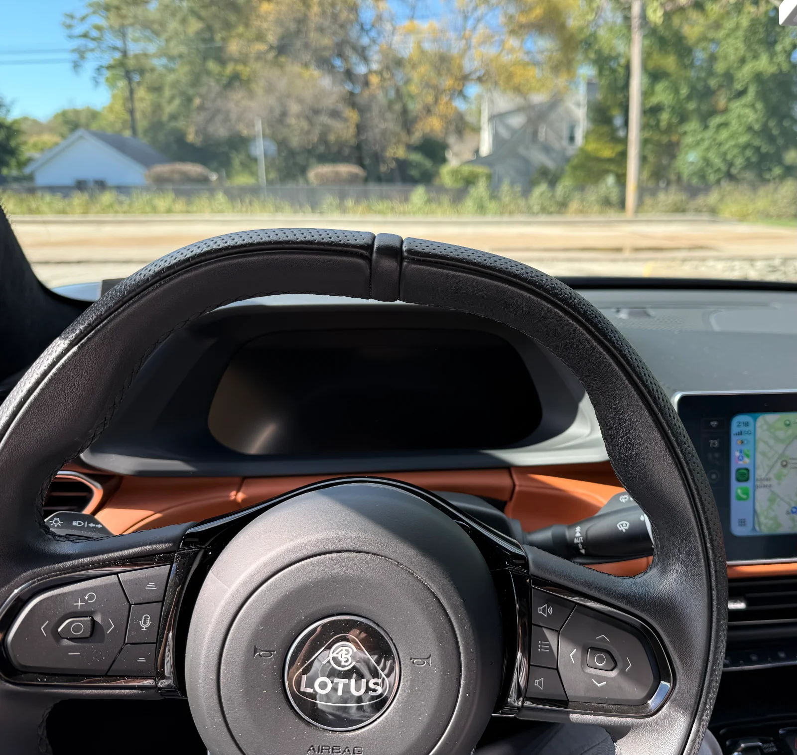

Something just happened to my dash display today. Car is July 2024 build i4 (3k miles in). Was driving today and all of a sudden the middle toggleable information section (trip, tire pressure, media, etc) of the dash just disappeared. Weird thing is it flashes back momentarily if I switch drive mode (sport to tour etc.). Anyone had similar problem? Maybe its a trip to dealer to fix some module/cable (wonder if can be DIY)? Just found strange only a portion of the dash went out (see pics).

Interesting, the service manual just has the drivers display as one big "Instrument Pack" including the panels and all the electronics - so I assume the whole lot gets replaced and repairs on this aren't done; "No serviceable parts" so a loose cable may not be repaired by the dealer. There's no details if the display is just one panel or several, you would have thought three separate panels would be more expensive than a single one - large LCD/LED screens aren't that expensive these days. Let us know what the dealer says & does.

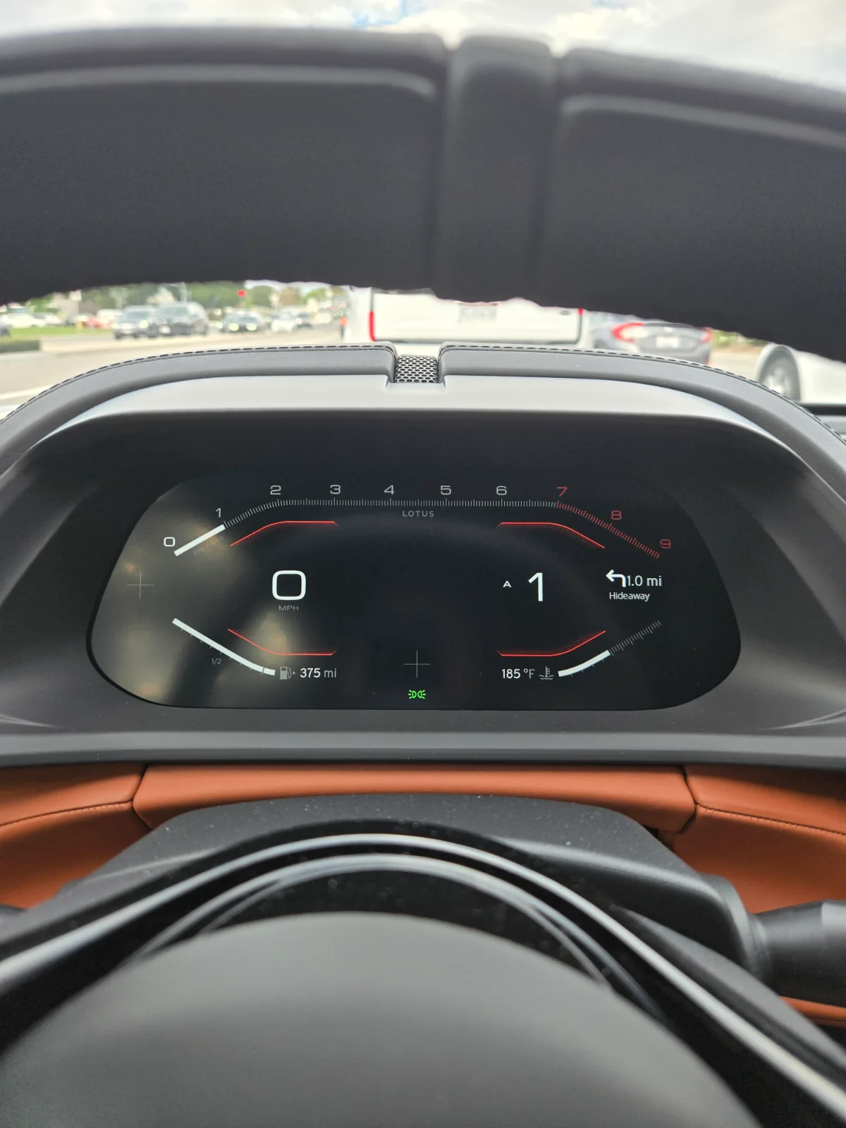

Mine did this the other day. The dash was on one second and out the next. Just the main dash display. Steering wheel controls didn’t work either and at least inside the car the turn signals weren’t working. Went home, turned off, got out, locked doors, and ten minutes later went back and turned car on and display was back. Car was super analog with no display. Kind of fun until I realized I had no fuel gauge…
Looks like most experienced the full driver dash black out but not the partial/middle section disappearing like mine. Going to start it up later to see if it magically fixes itself, or then another trip to the dealer it is.
It is a single sealed display unit. I know this because I assisted the dealer to replace mine. It seemed to be the solution until I realized the fuel gauge no longer works. Lotus wants us to replace it again, but said it's currently on backorder. Apparently repair parts must be a different allotment from production parts. Anyway, I'm concerned about how many times one can take apart all those snap together plastic dash parts before they start to break.
