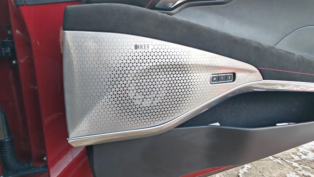

Does anyone know how to remove this speaker grille?

Hi all,
I've had a search but can't find any clear instructions - does anyone know/have a guide how to remove this speaker grille please?
Many thanks

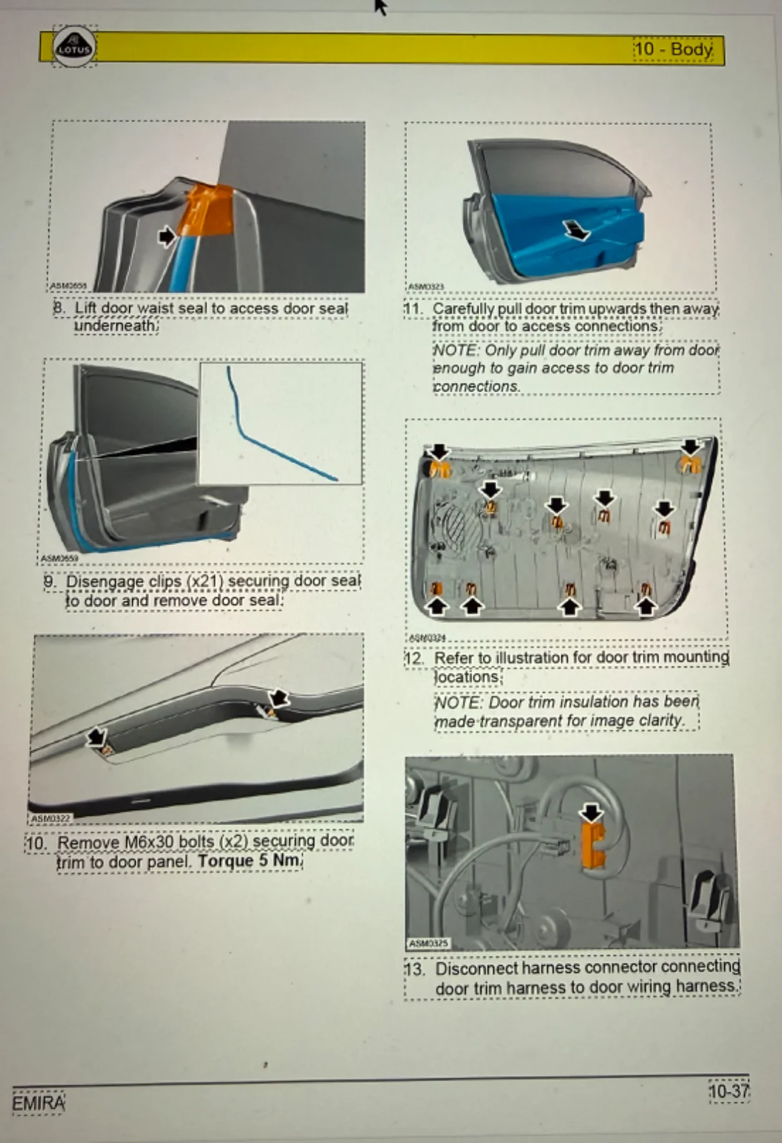

Thank you for the reply!
Any idea/guides to how i can remove the doorcard?
Many thanks
looking at the instructions on the Service Manual right now, yeah, basically its remove the door card first.
Then its a very straightforward strip down of several layers of panels attached by bolts and clips from the backside of the card to ultimately detach the grille.

Thats really helpful thank you so much, saved me a lot of time, appreciate your help!
Awesome! much easier to learn from being able to see it visually, thank you

Removing the door cards is super easy. Two bolts and then lift straight up. Good luck!!
