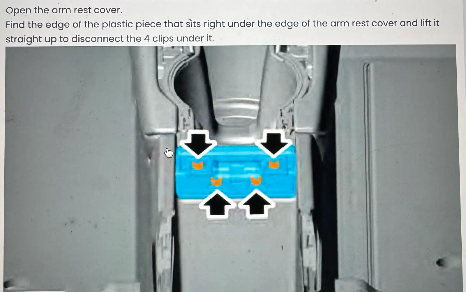

How difficult is it to remove the cupholder? My car has 325 miles on it, and the first time I put a cup in, one of those rubber bubbles that hold the cup popped loose and pushed in. Dealer is a 90 minute drive away, so I'll eventually ask to get it fixed under warranty, unless I can easily get in there and glue it back in place. Looks like it was one of those 2-stage molding jobs that went bad.
I tried pulling the 4 screws under the round rubber pads, hoping the assembly would lift out, but no dice.
Open the console arm rest and you will find a couple of additional screws at the front end. That should do the job.
Nope. Opened the arm rest. No screws for the cup holder. It looks like there is a shiny black trim piece but I don’t want to risk breaking it. Ill let the dealer do this under warranty. This is all too new for there to be YouTube videos.
Sorry, my bad. Not screws, rather it's a plastic tab that you pull out as shown in the diagram. tempImage1SadzM.webp
