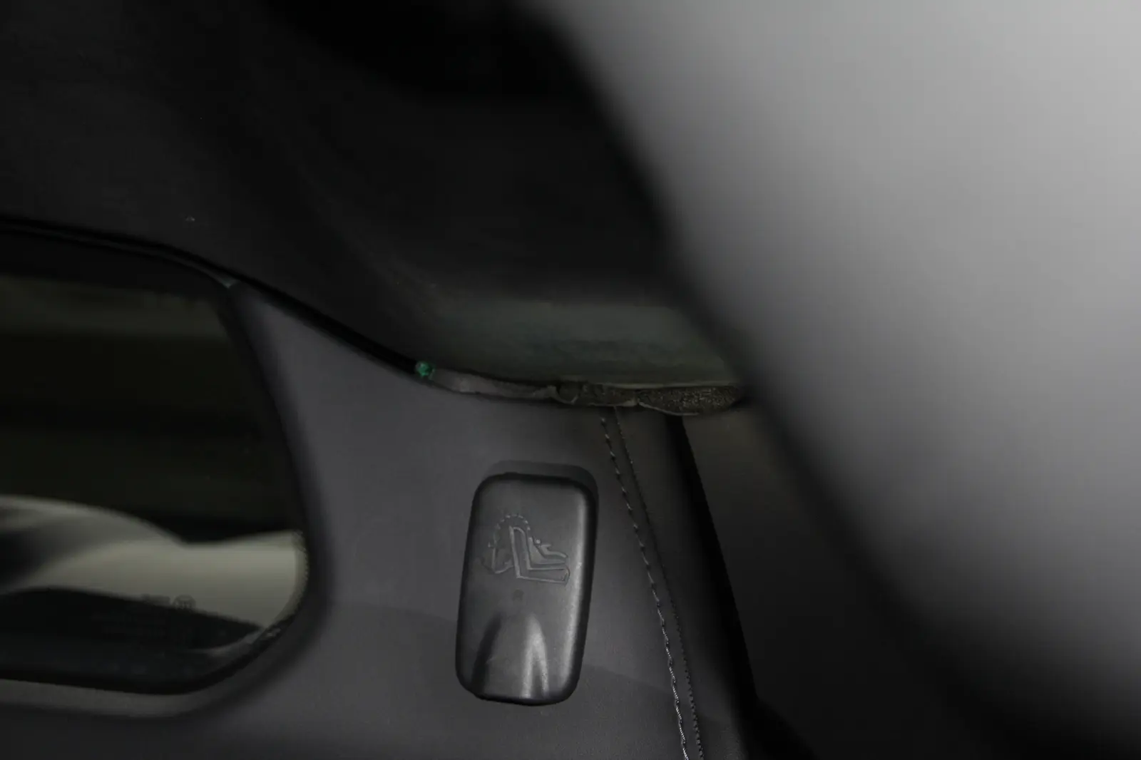

You have a picture of the location? mine is doing the same, and I am having a hard time locating - its behind my head while driving.
Here is location behind driver seat and will use small rubber door seal for doing final seal finish ..
This noise was really pissing me off for I have Tinnitus and any noise drives me furious..
And my wife does not hear this noise sitting next to me ..OMG
It's possible that piece is not clipped in properly. I had that area apart recently and it is difficult to properly "click" the clip into the trim piece behind it. While I had the rear trim panels off, I also found some screws that were loose and a missing bracket that a piece of trim is supposed to attach to.
