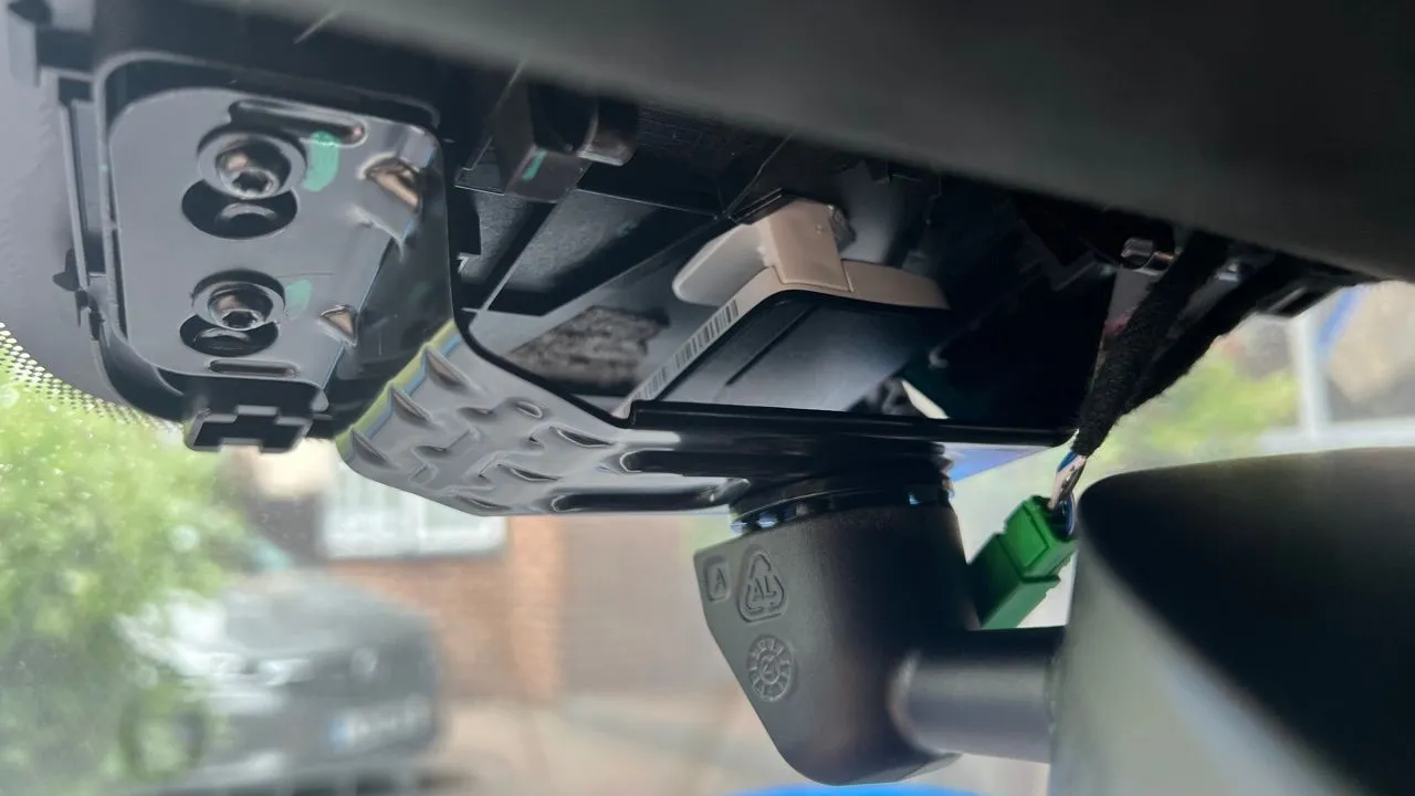

I put the tag completely out of sight behind the mirror shroud, in the triangle space where the adas camera would go and it worked fine.
But I also had the carplay/waze freezing at toll booths issue.
Only occasionally. When it happened, coming out of carplay to the car menu and back would fix it, but one time the settings and carplay icons disappeared and only a car switch off solved it.
I wonder if its anything to do with the tag transmitting to the tollbooth?

Cool!!!! Great idea!!!! I want to do the same! I hate having things attached to the windscreen of the car.... how did you do that?
Very easy.
Pop off the mirror shroud and just stick the tag holder to the glass in the triangle space.
To get the shroud off, first pull off the small section directly above the mirror by hooking something through the vents and pulling back. Then use a trim tool or similar to lever the main section downwards, front first. It’s only clipped on.

Done! Easy Peasy just as you said nevertheless I was terrified to brake anything 😬
it works flawlessly and it is a super neat solution! Thank you very much!!!!!

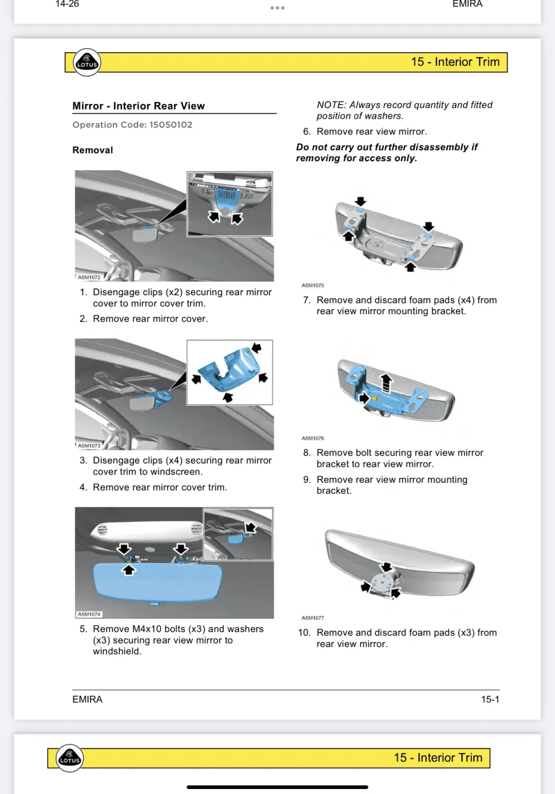

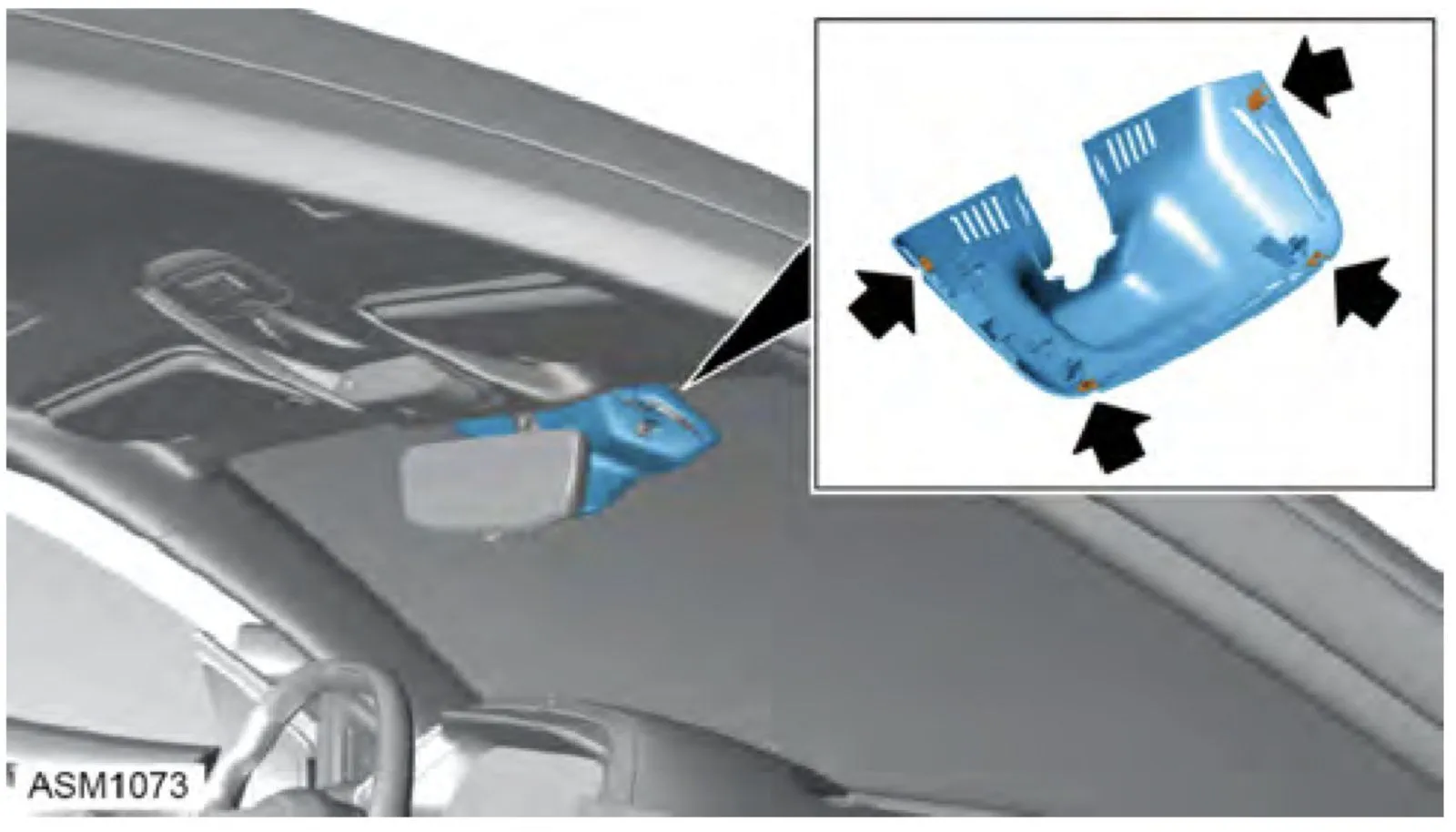

I’ve also had these instructions for the other bit, it might help and could be used for reference to anyone else who would like to do it
