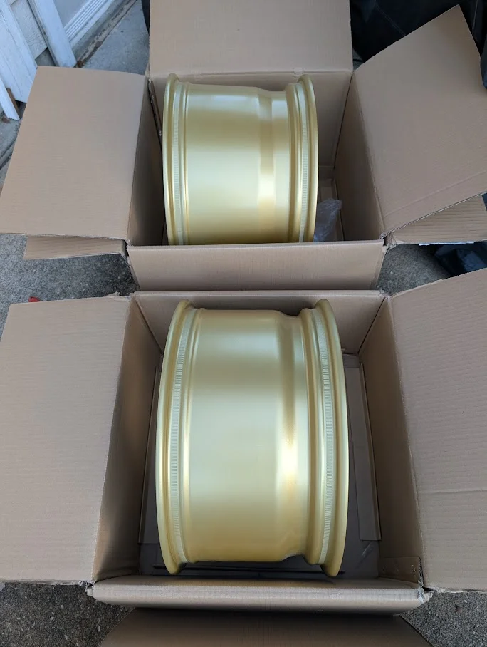

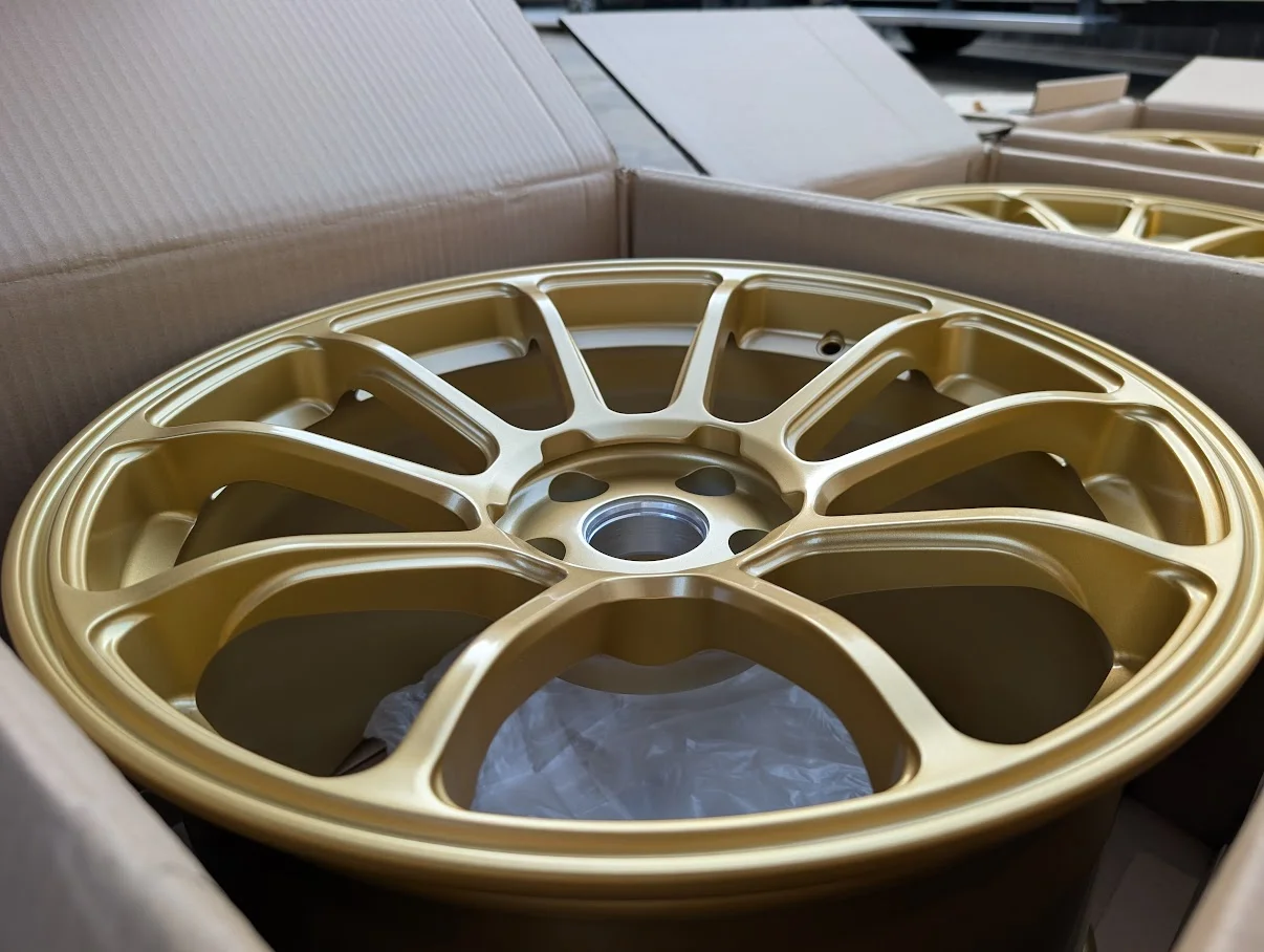

Fully forged 6061-T6 Aluminum - Zuri

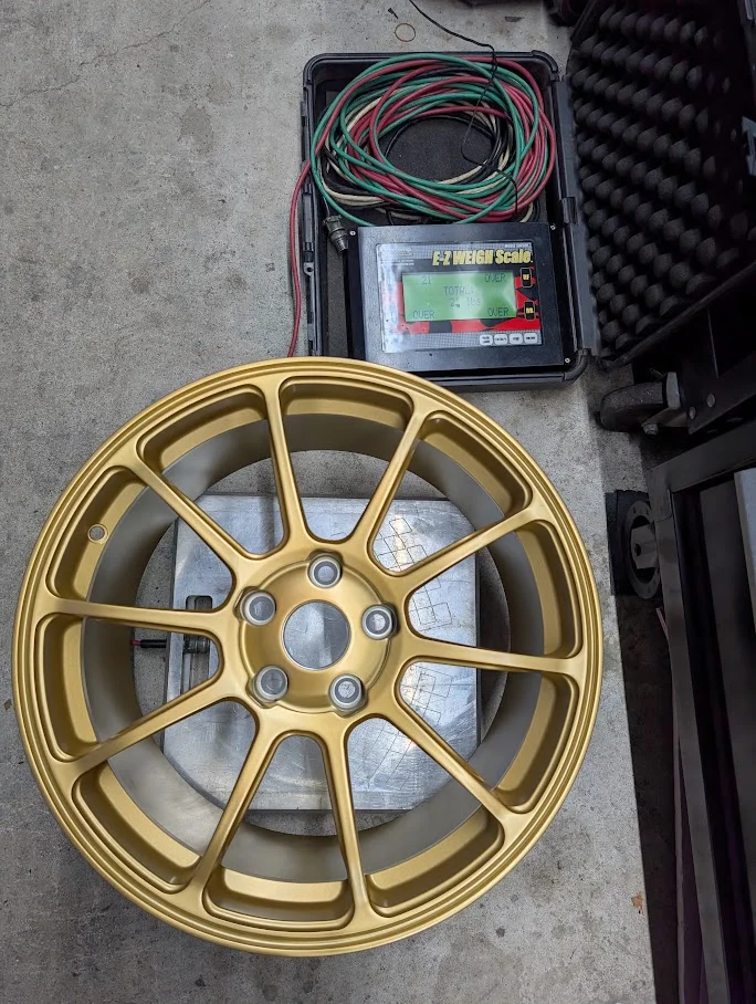

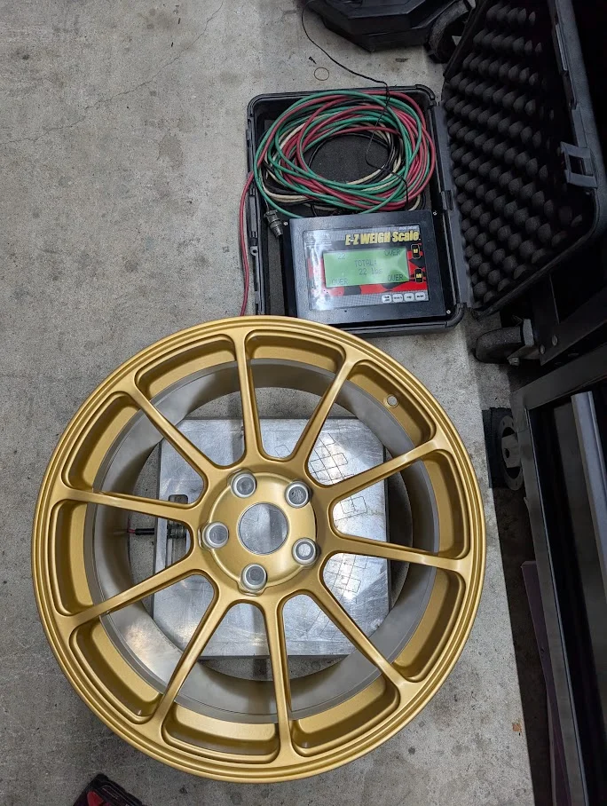

Fronts: 18x9.5 +60 offset; weighs 21 lbs on my corner balance scale (OEM Diamond cut forged front wheels came in at 26lbs)
Rears: 18x11 +49 offset; weighs 22 lbs on my corner balance scale (OEM Diamond cut forged rear wheels came in at 30lbs)
690 kg load rating front and rear

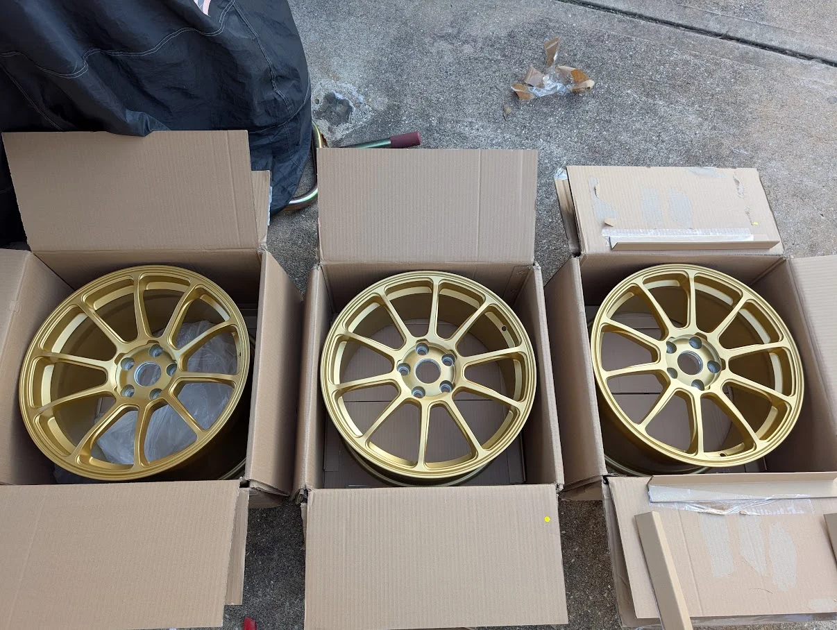

Ordering Process:

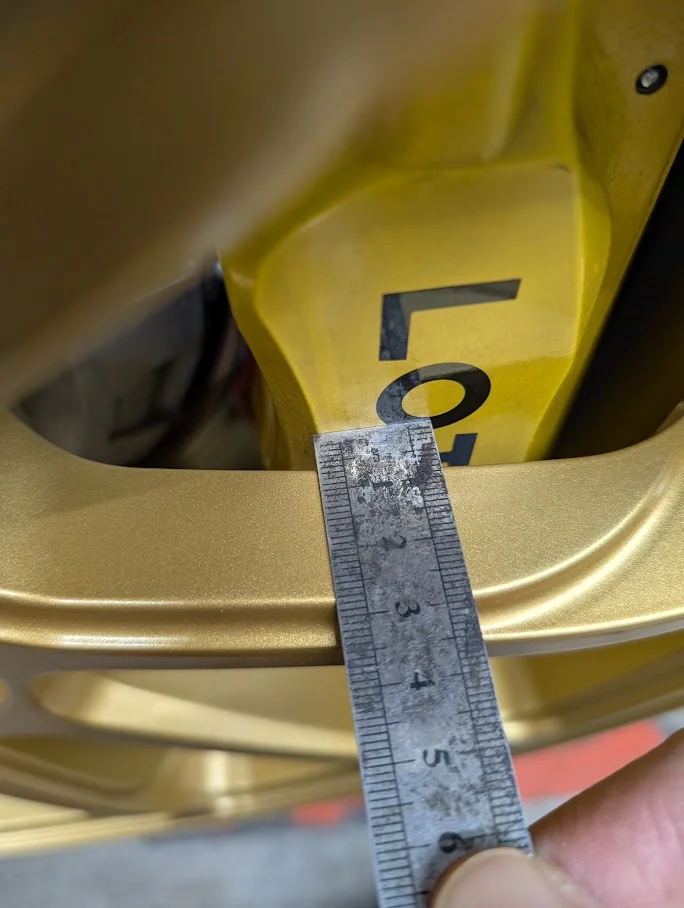

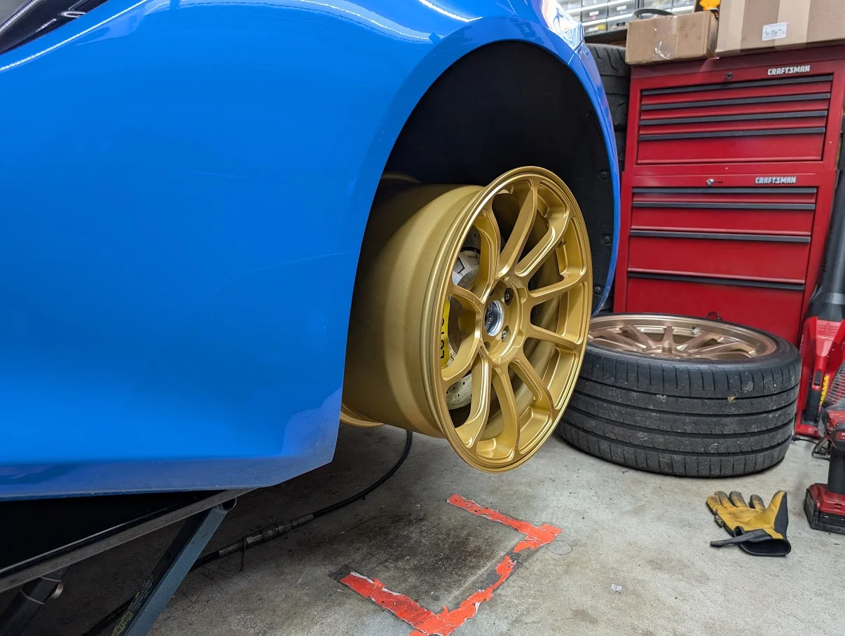

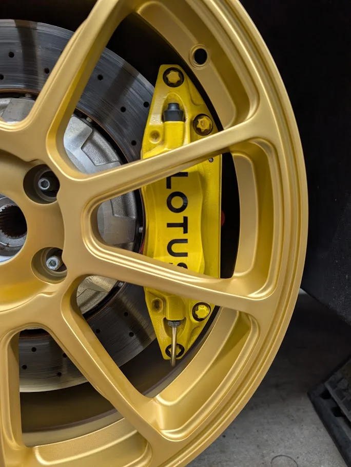

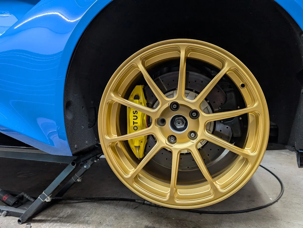

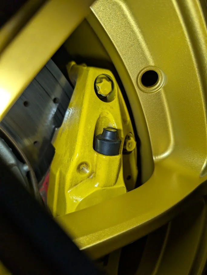

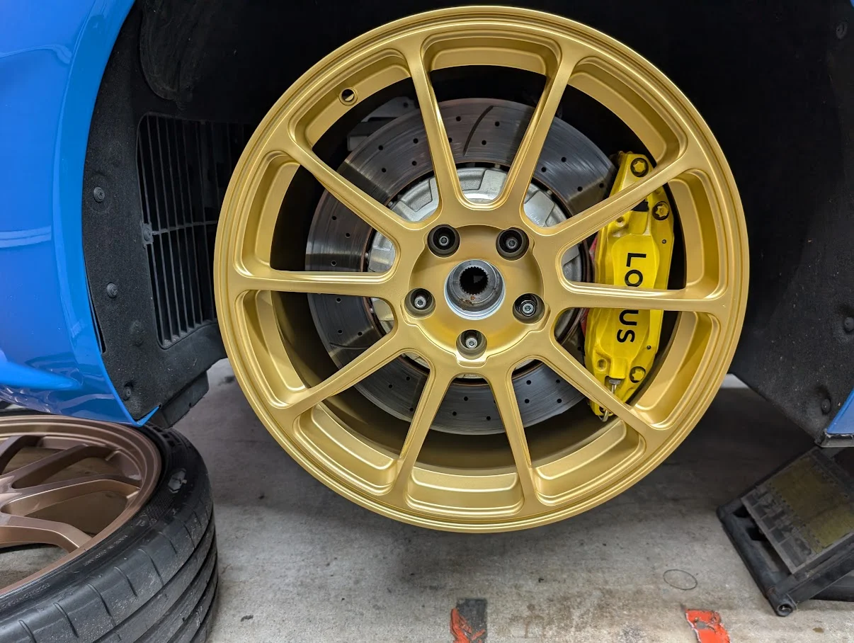

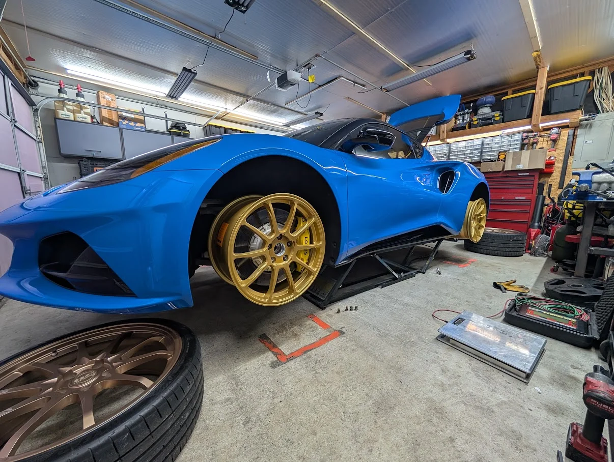

I already have a set of @John @ BSPK 20" wheels on the Emira (details here: BSPK Forged 20's), but wanted a set of 18s specifically for the track. While we know the GT4 uses 18's, the details aren't clear as to what would fit in the front with the brake setup, but everything fits beautifully! Rears fit courtesy of Darkwork Designs PBR kit.
Time line:
9/24/2025 - Order Placed on website, begin consult with John about desired details/measurements
12/28/2025 - Wheels received at my doorstep
Test fitment Pics:
Wheel weight:
Front - 21lbs
Rear - 22lbs
I wanted to ensure everything cleared before ordering tires. I'll get some rubber on and post some pics once they're mounted!
