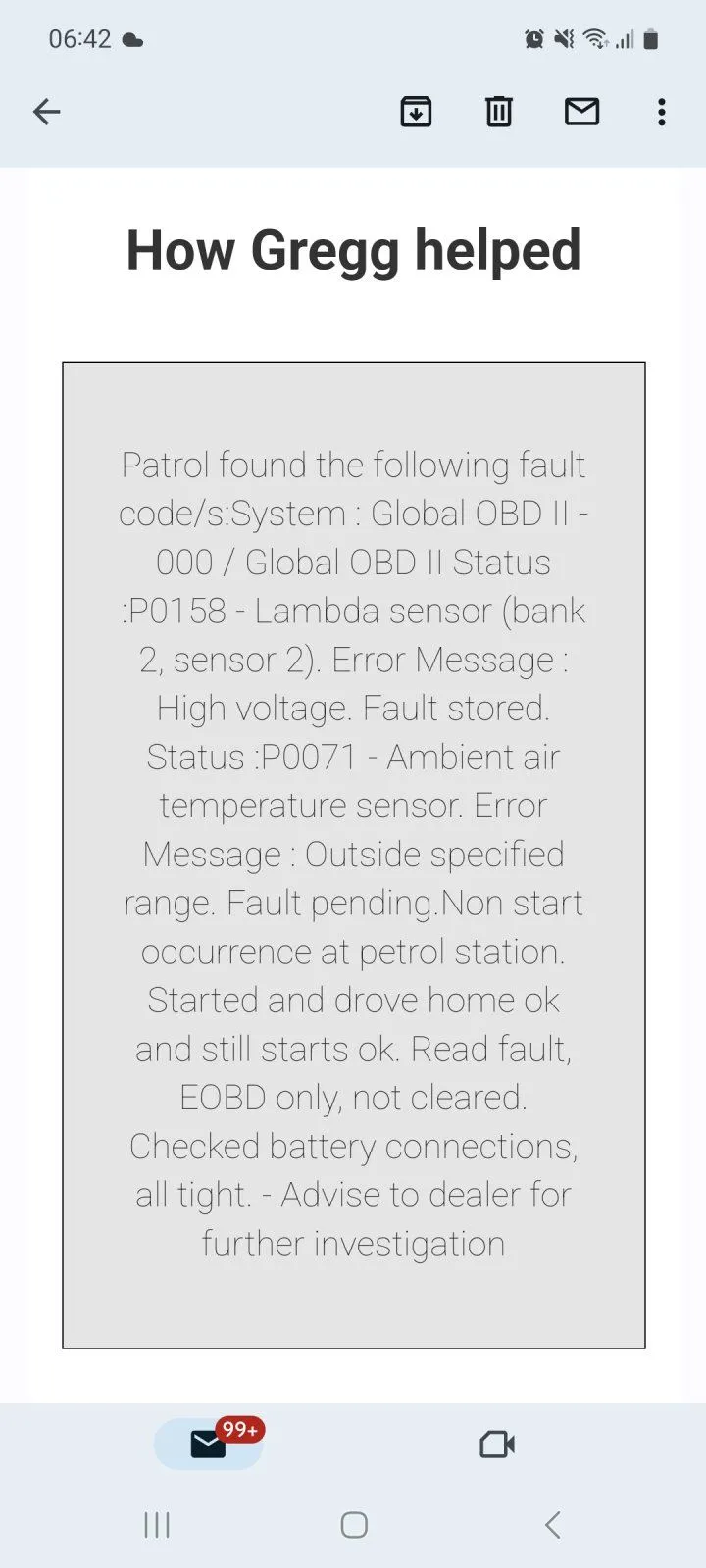

That's the problem. Sometimes a battery that's not working properly checks out fine when tested. If you have a battery charger, try a full deep charge. If the battery is okay, it'll go to a full charge and the fully charged light on your charger should light up. If the battery has issues, it will either take a lot longer to charge up, sometimes over night, or the fully charged light will never come on.
Get a battery charger if you don't already have one. It's a relatively cheap way to test the quality of your battery, and it doesn't hurt to have one if you ever need one.
