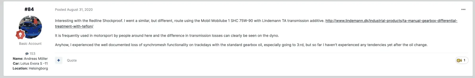

When doing some research on this, I found this info in case it might help:
Something else I thought of, is try checking the oil level in the transmission, just to see if it's actually full. I believe the Emira also has a trans cooler system; check to make sure it has the proper amount of coolant too.
Just some relatively quick troubleshooting ideas.
