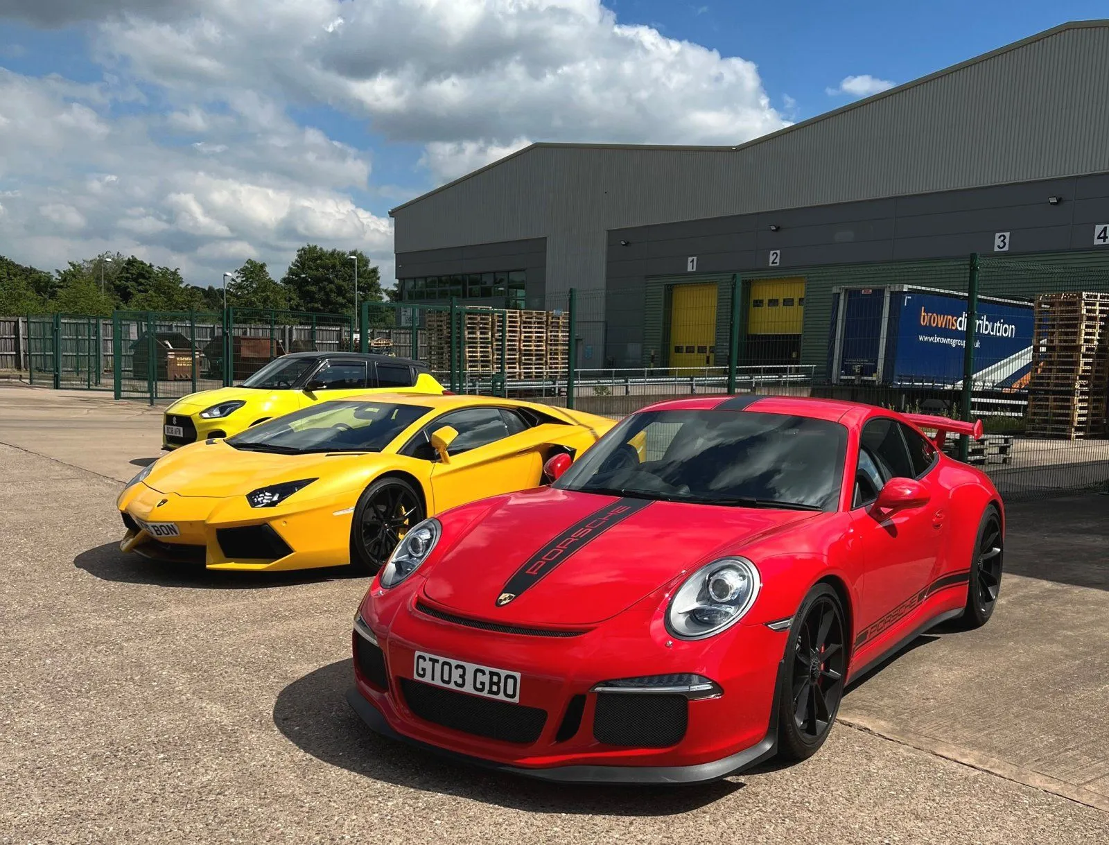

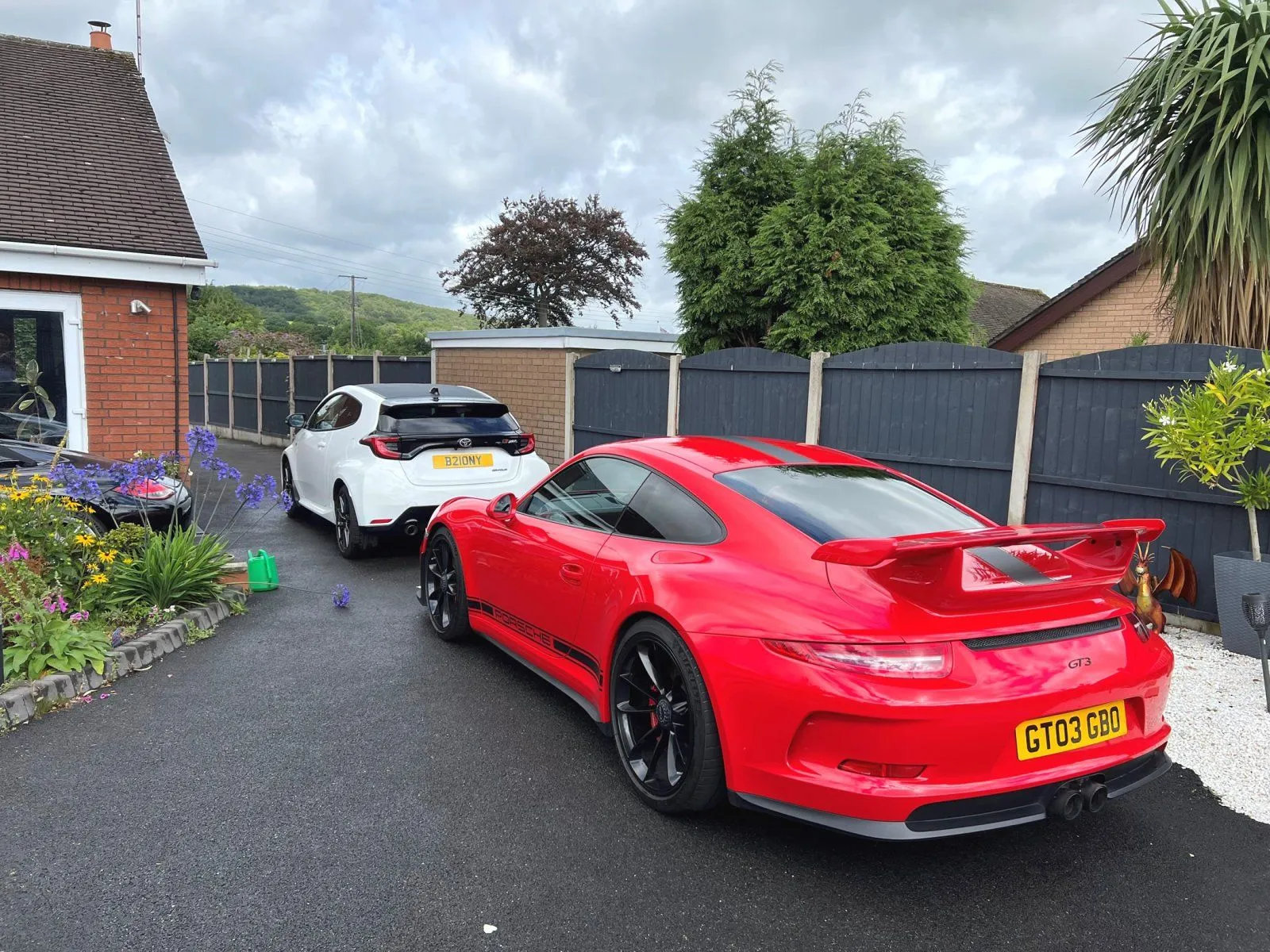

Hi there
I own a 991.1 2014 GT3 still on the original engine.
It is an insane car, I've also got a Lotus Exige 410 20th Anniversary too, done track days in both, they are both incredible, the GT3 is faster, but the Exige is more engaging on track, manual and lighter etc. but the GT3 is way better on road.
In regards to the engine issues, my car has an original "E" engine, the most likely to fail, I am on 16,000 trouble free miles so far. Later cars had an "F" engine which is less likely to fail but still does. Replacement engines are "G" marked and seem to resolve the issue.
The 991.1 GT3 RS also has a similar issue but there is no goodwill official warranty on the RS.
On the 991.1 GT3 all of them have a FREE 10yr goodwill warranty from Porsche or upto 100,000 miles, whichever comes first which for most will be 10 years, I know people who have had engines fail and Porsche dealerships will normally have the car back on the road within a month with a brand new engine fitted.
Also all Porsches from a dealer come with a 2yr warranty covering entire car and this is extendable upto 15 years old. The 991.1 is an awesome car, really raw engine and chassis but also fine for road use.

Really appreciate this post! Car is gorgeous 😍 So tempting!
