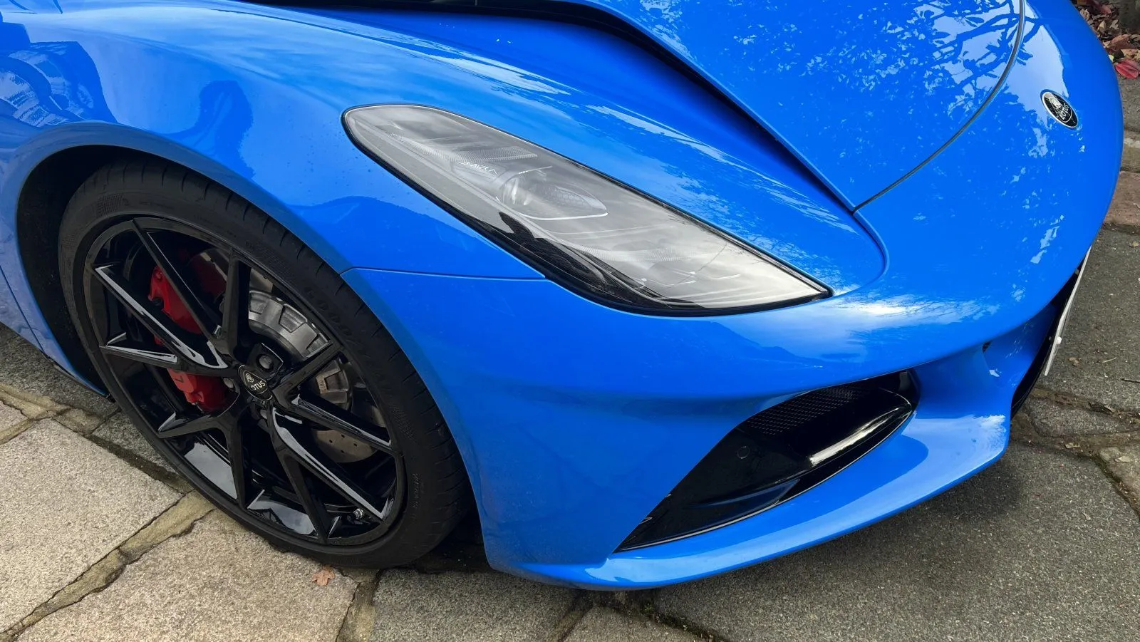

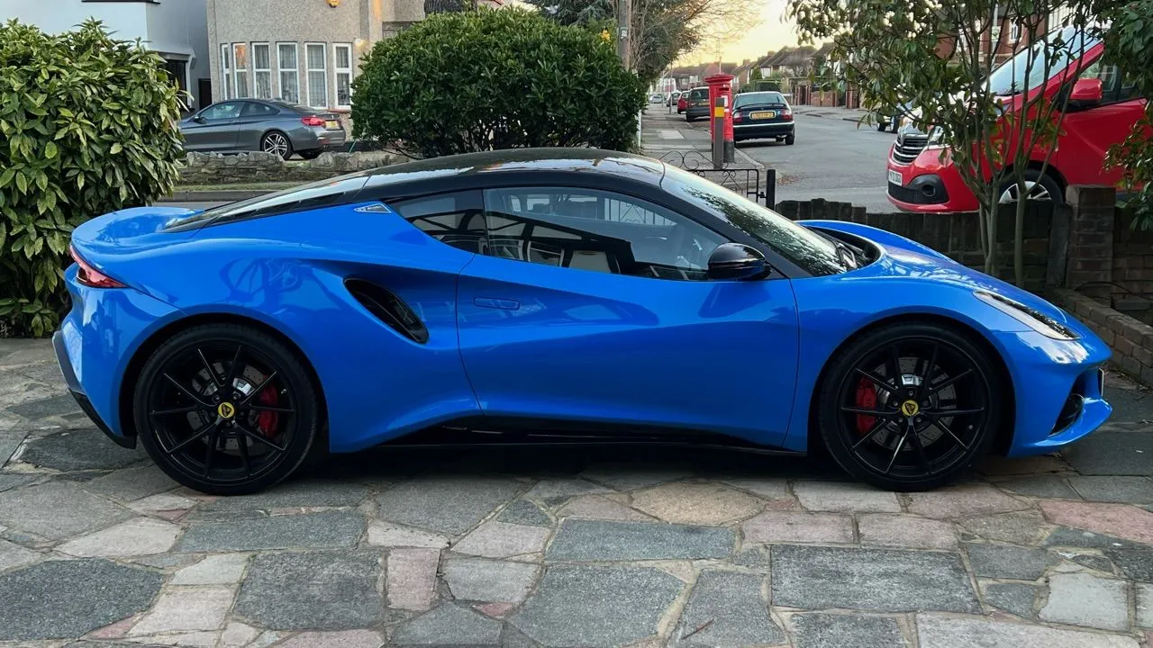

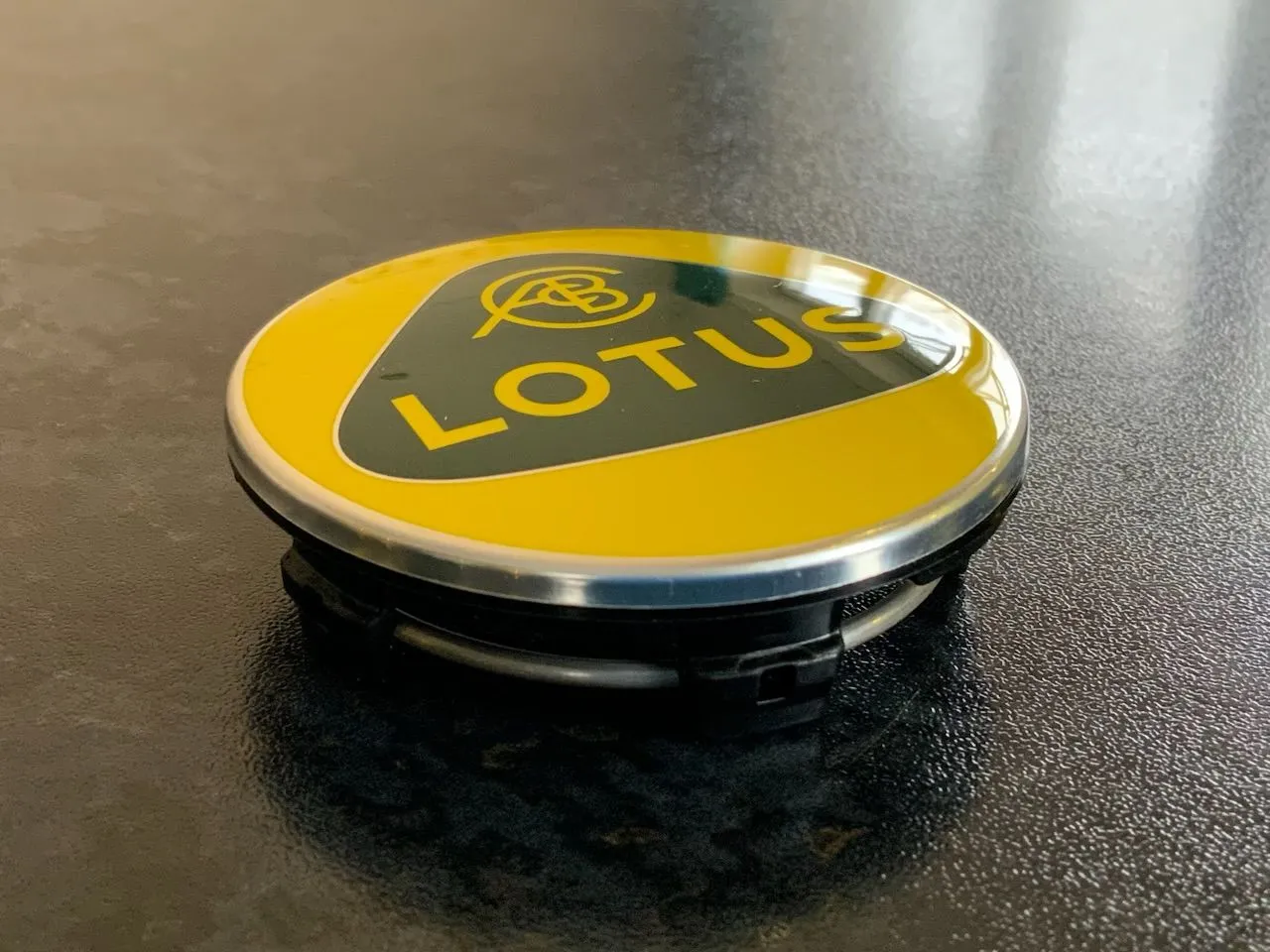

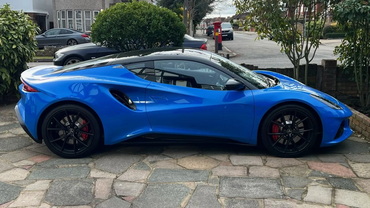

Black wheel centres fitted.
Interesting how it almost seems to change the look of the whole car, without the bright points of the yellow ones.
View attachment 22770View attachment 22771
Is amazing how such a small change can make a difference like that. Draws the eye more to the callipers and discs now with the black caps.
I like that a lot! (y)

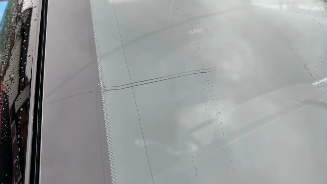

Crack!
400 miles in, a bullet-like stone did this to me. The crack is about six inches long.
Bugger. Oh well, new windscreen time. This could be interesting I thought.
Contact Autoglass online through my insurance and am pleasantly surprised when it says they can do it in 2 days.
An hour later a less pleasant (but unsurprising) phone call to tell me that, actually, no, they can’t do it tomorrow because they can’t actually get a screen.
They’re going to attempt to source one and will ā€be in touchā€.
I am awaiting developments.
This happened to me with autoglass and my partner's 7 series, took them 10 weeks to get back to me. In the mean time we'd found an alternative company who the insurers were happy with who got it done within a couple of weeks (part took a while to come from Germany)

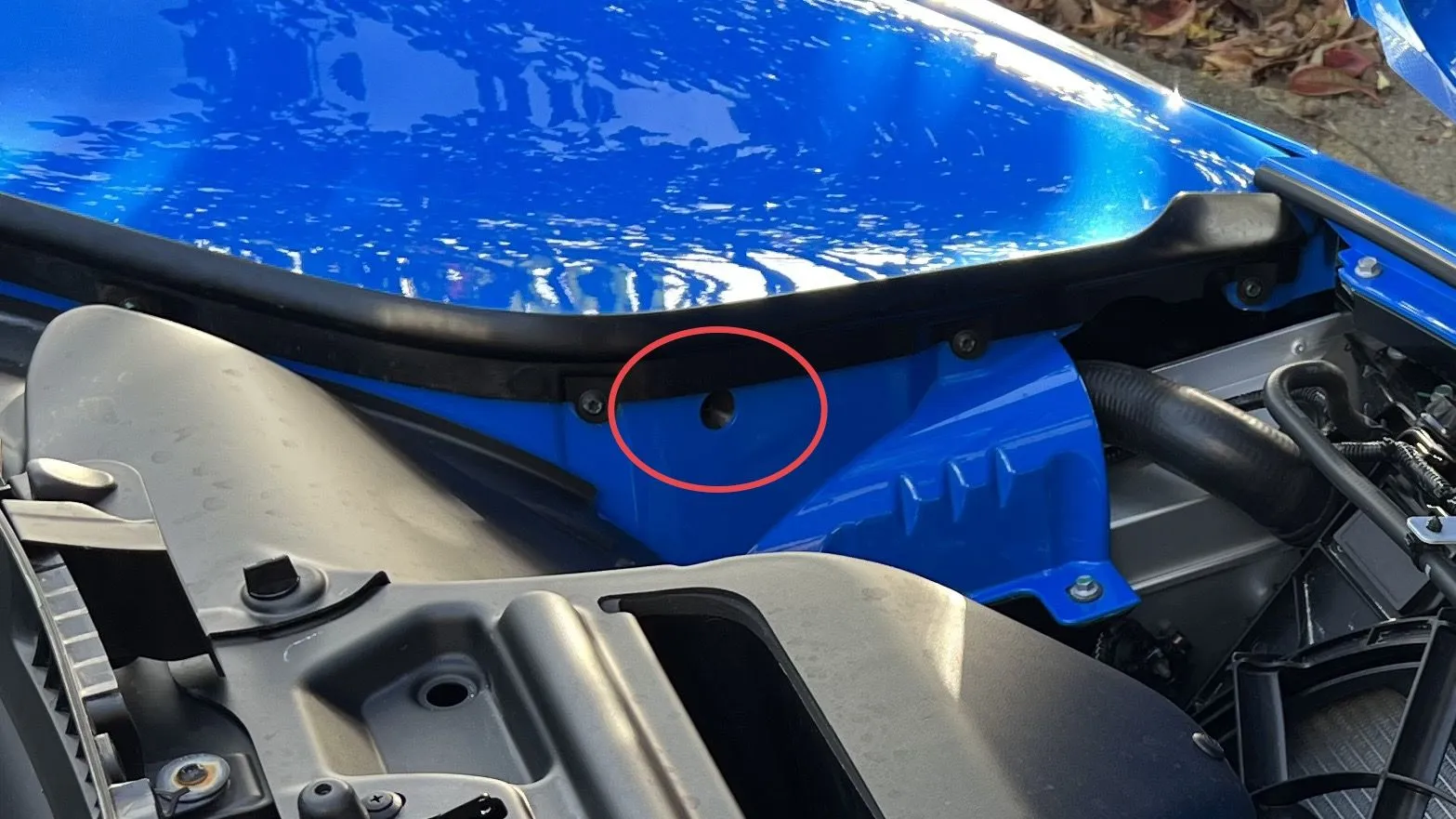

This is a headlight adjuster.
Behind this allen socket is a bicycle-type cable that goes to the back of the headlight to adjust (presumably) the up/down.
In front of the front wheel in the wheelarch liner is an access panel behind which you can see the mechanism. The above adjuster in the front space saves having to mess around behind the wheel.
It’s not mentioned anywhere in the handbook or service manual that I can see.
Maybe they don’t want us messing with the carefully set up (šŸ¤”) LED lights.

On the bottom left of the picture is it a rusty bolt?
really?? is that it, man get a life
Well…. For a section clearly Exposed to bad weather and thought and known that... I was expecting something better, it would be such an easy and simple task to do it right
honestly, for such situations, I have different (higher perhaps?) expectations than a rusty bolt….but maybe that’s me not able to settle for average (maybe even less in this case).
I agree. It’s hard to tell what exactly it’s for but from what I can see, the bolt in question is just inside of the large ā€nostrilā€ and I t’s the only one that shows signs of corrosion. It also has a huge washer underneath that the others don’t. Were that area to get wet with rain or salted road water that giant washer is certain to catch it being right there. Also, as the OP has ignored the warning from Lotus in the manual about not removing the bonnet, other components inside may have been exposed to elements that were not intended. For me, the damage is done so I’d clean, dry, and put a protective shield on all exposed parts underneath now. Especially the coolant systems, suspension, and anything near the seals.
