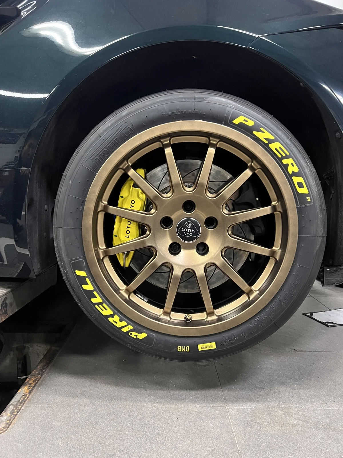

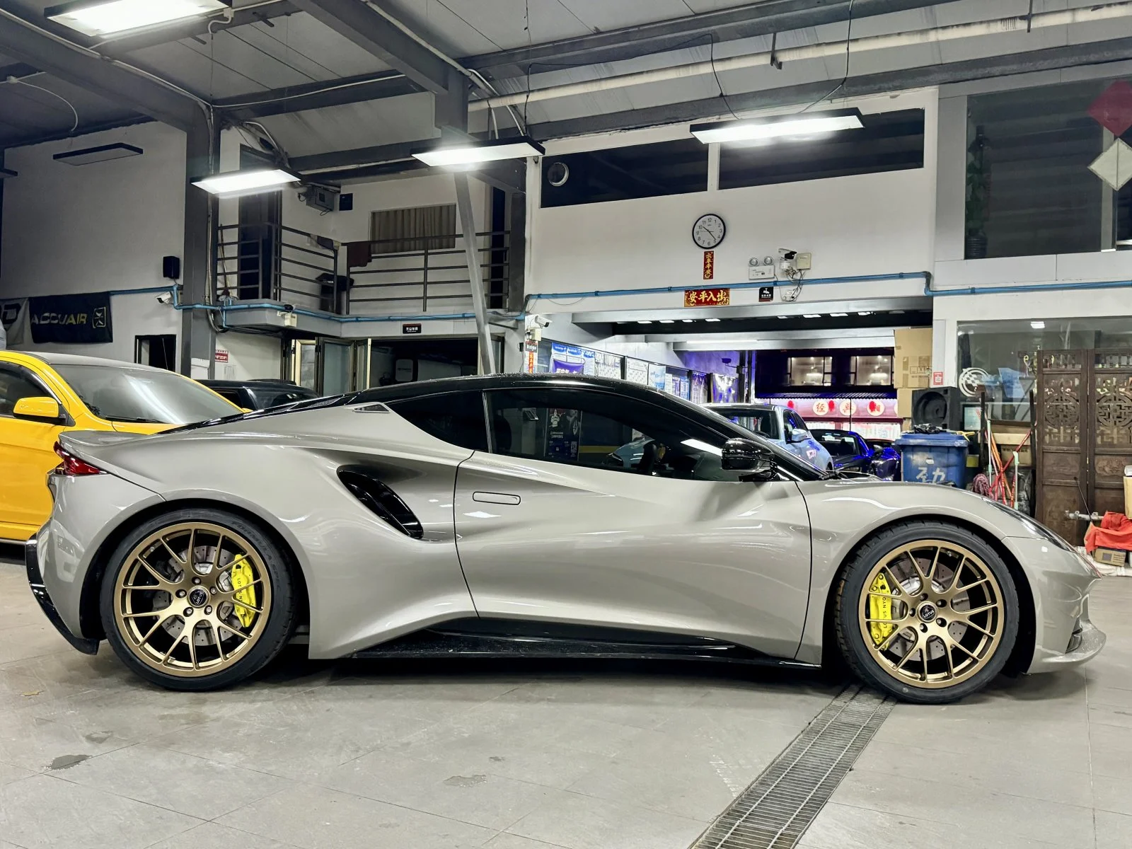

Haven’t bought them, but there is a tuning shop in China that offers 18s for the Emira and they work with OEM brakes. 9” wide on the front, 11 on the back with 265 and 305.

I thought 18's wouldn't work as they won't clear the parking brake actuator.

This tuner shop says their 18s work with OEM brakes. They are custom designed to clear everything. They are wider too, 9” front and 11” rear. They run 265 and 305 tyres.

Have they checked the parking brake? I checked the other day and i’m not sure many 18” wheels will work. The GT4 car probably works because I’m guessing it doesn’t have an electric parking brake.

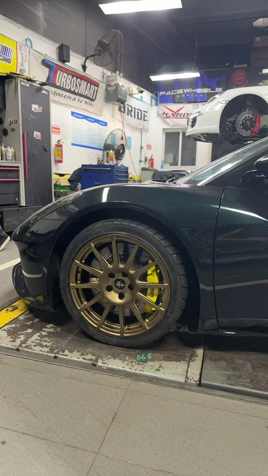

i will check specifically regards the parking brake. Agreed, that parking brake assembly is the highest point and there isn’t that much clearance. These pics do show the 18s fitted on what appears the standard brakes:unsure::unsure:

Not sure what the right combination of answers is here. But it does seem they have the stock rear e-brake tucked in under the 18. Honestly, it looks good. (Just looking at the wheel/tire package, not the biggest fan of the wheel design itself) It makes me highly tempted to find a Carbon Ceramic that could work under an 18inch wheel.

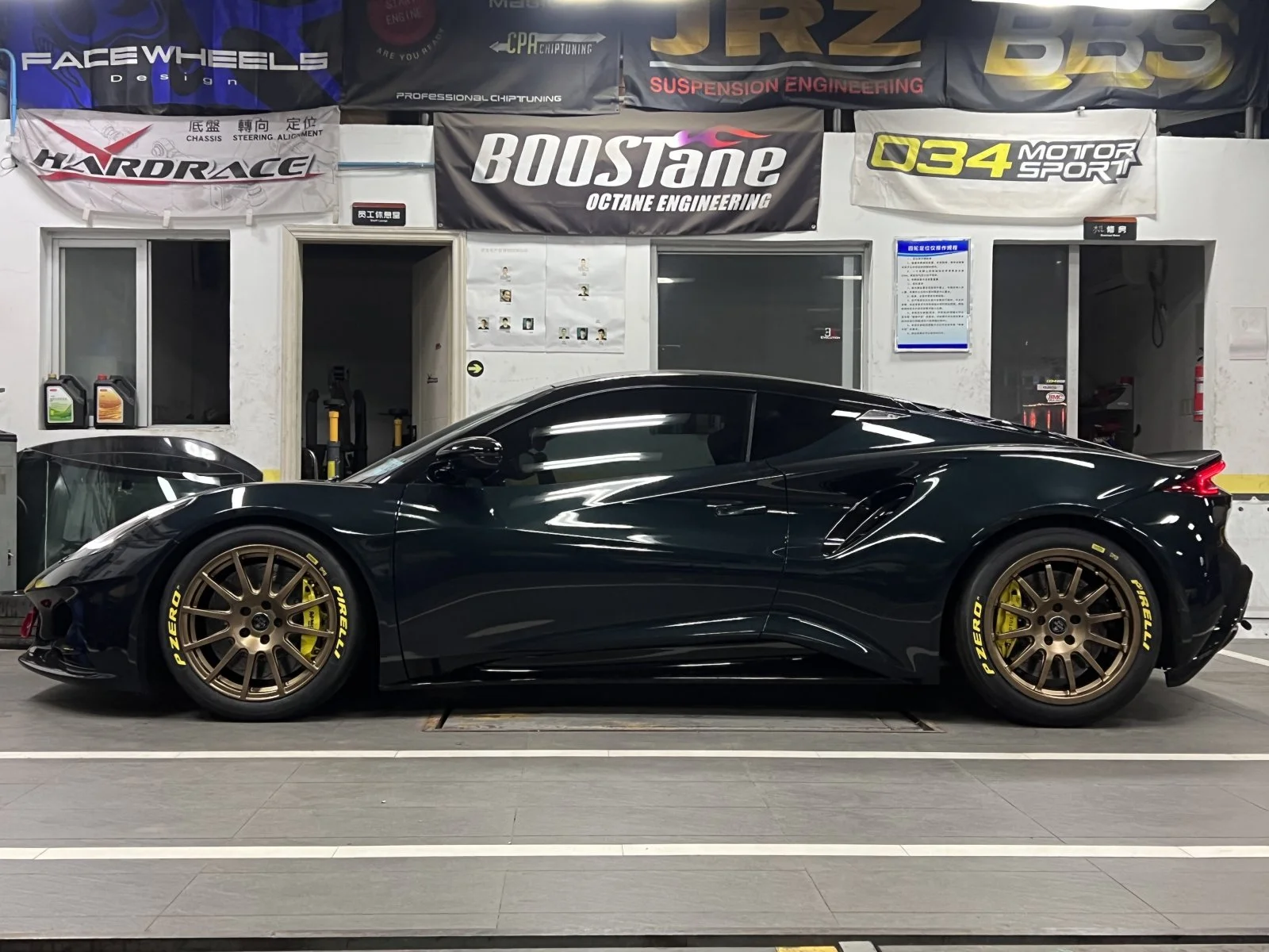

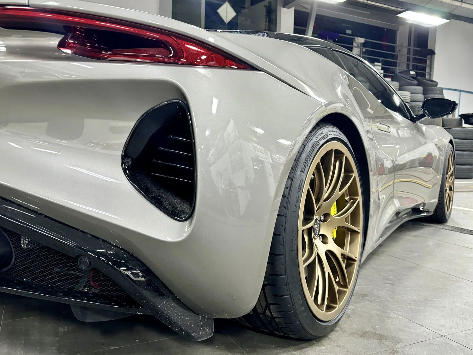

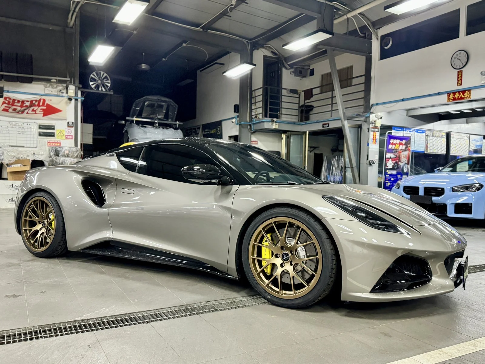

This shop offers other styles of rim, and apparently the 18” version are designed to work with the OEM brakes.
The 18s are not particularly light, but are lighter than the original wheels. He states they are built to be strong, not as light as possible. These are CNC from a forged blank, so are somewhat flexible on the details I expect.
Personally, I’m on the wall a bit whether to go 18 or 19. Need to do some research on tyre options. They’d be strictly for track, so don’t need to be road legal. I personally prefer the look of the 19s.

If it's just for Track 18s are definitely going to be the right call. Lots of professional race teams use 18s, besides tires, wheels in 18s becomes a fountain of options. Track based? 18s. Whether it's Advan GT, Volk TE37, many other Rays wheels options, Titan 7, Motegi Racing, BBS, just tons of options.
I'm curious whether the rear parking brake is a "grind down until it fits", or something fairly innocuous. The car with the 18s showing the parking brake at all tells me it's functional. If they were just relying on wheel chocks they'd remove the brake assembly to save the weight.
I will say, I get that there are a lot of forging options that effectively press a blank face with a barrel and then CNC out the face pattern. For some of the other wheels on the market, I don't think they are doing this. Volk TE37s for example I think are forged into a "rough shape" of the spokes then CNC'd to trim out and do things like the hub face and lug-pattern.
The strength difference might be negligible, but it's gotta make a difference in the grain of the metal, especially for some higher concave designs.
